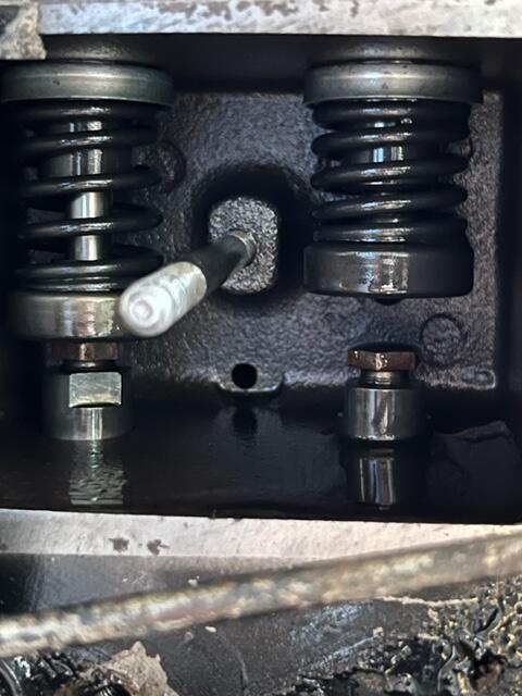

953 nut 70,327 #17 Posted September 14, 2023 3 minutes ago, ineedanother said: I would pull the head first to see what the valves are or are not doing. If your intake valve is not closing the compression from your cylinder going backward through the venture of the carburetor will draw fuel up and blow it out the air intake. 3 Share this post Link to post Share on other sites

ottsm 23 #21 Posted September 16, 2023 Stuck intake valve, engine look fairly clean except for the horn of the intake valve. It has some black crust that easily broke off (guess that is what the manual refers as "coking"). I put some penetrating oil and tapped it with a mallet and it when back in, must have got a little of the carbon trapped in the valve guide. Think I know what started this, I was burning some really old gas up and when I went back to the new guess it must have broken some of the buildup off, just a theory although the manual states that "coking" is normal. 2 1 Share this post Link to post Share on other sites
