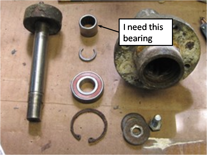

tim57chevy 12 #1 Posted September 13, 2023 Can anyone tell me where I can purchase the bearing to rebuild my DD spindle? I need the lower bearing. It is apx. 0.99" OD and Apx 0.73" ID. Share this post Link to post Share on other sites
Ed Kennell 47,594 #2 Posted September 13, 2023 Will this work? bearings | McMaster-Carr Share this post Link to post Share on other sites
Brockport Bill 2,481 #3 Posted September 13, 2023 2 hours ago, tim57chevy said: Can anyone tell me where I can purchase the bearing to rebuild my DD spindle? I need the lower bearing. It is apx. 0.99" OD and Apx 0.73" ID. they're on partstree.com -- just search the wh mower deck models Share this post Link to post Share on other sites
squonk 48,215 #4 Posted September 14, 2023 (edited) Common B1212 bearing. Napa has it available $10 Needle Bearing I.D. .75 in. Needle Bearing Length .75 in. Needle Bearing O.D. 1 in. Wh #1508 changes to #252-6 Edited September 14, 2023 by squonk 1 Share this post Link to post Share on other sites
peter lena 10,089 #5 Posted September 14, 2023 @tim57chevy what ever bearing you get , the reason for failure / noise , is lubrication failure . lateral collective drag , along with just any grease will fail again . why not correct that while you are there ? personally like a 550 dreg flash point grease , with a polyurea rating . meaning , anti sling ,and extreme stress heat rating , Lucas x TRA heavy duty green , or Lucas marine grease , will stop failures . have this grease in every related bearing , no screaming PTO clutch , no whyining bearings , deck turns easily by hand , at belt drive .easy to re grease a bearing , note the orange rubber side shield on that 6203 type bearing ? also did my , mule drive bearings , just a suggestion , pete Share this post Link to post Share on other sites
