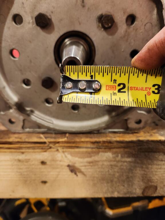

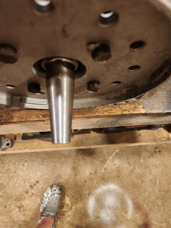

Kirby216 7 #1 Posted September 11, 2023 I picked up a tecumseh 10 hp engine I can't verify the proper serial number an I'm hoping it's just a hm100. From my own on searching that's all I can find. Problem I have is it has a generator crankshaft which is tapered from 1 inch to 5/8. And it does not have a key way. I want to motor swap my wheelhorse From the blown 6 hp to the 10. Is it easier to buy a new pulley and machine the taper. Will the pulley function without the keyway and just press it on. Or buy a new crankshaft? With the 1inch output shaft. 1 1 Share this post Link to post Share on other sites
Achto 32,923 #2 Posted September 11, 2023 (edited) 14 minutes ago, Kirby216 said: Problem I have is it has a generator crankshaft which is tapered from 1 inch to 5/8 Here is the cure. https://www.ebay.com/itm/132083677591?hash=item1ec0ccf997:g:DYAAAOSwqxdTqvNo&amdata=enc%3AAQAIAAAA8EHHO1ND0Br0OcsILmjciOMdK4Zij4baUxoZJxCJIqSYDVvEit3VXqAuBw9%2FJ%2BkhLuV8K13T1dBzUWf5XpU4OtnF4VfA2SY1HsHt3kOX8aiXK%2FXYC0Ke6zD8%2F4H%2FIZSTyd5WZU0oypXGQb%2BJeAwZ2nqGiot5wNlXKkzxuXWXeIVGi6GgEZalCcutprrtqi0KWl21qYzGhGxISItiCWchi9v0yrVGilOBUP5Kb4NVrWZc8Rgn%2F9TFuooUozSJoAT5AEHJJvsy5ydSzyXqil5vBh7fcUt0V74%2FuHFPFjWGSrEuuw59YK7yAOss1lh0ElZxsw%3D%3D|tkp%3ABk9SR_KSmtHQYg You can also get this adapter to go to 1 1/8" keyed shaft. https://www.ebay.com/itm/111797583847?hash=item1a07a7bfe7:g:wOYAAOSwA4dWHr9t&amdata=enc%3AAQAIAAAA0JQofidBoMItmwNvfeekT%2B4D8DBzwnmupXl4wW1vzmRobXcjdlabjDCNW8QN0dThVnZmiIUpguNQbNbNkPgqf%2FlMDN8uDCzuLAln7OG7mpbwpYrtnt4wEHkZjmaIuNSmuP4JDs8AZoRLWG%2FWLbx4u8cQgKnAyqd0RMlFCrMXLorENX2ejAdo3ZHibL4ms3BQf8o%2FMGpf8xi7XfNkyGnvvruYaIgP6cICTXsKYoaX2PhAPTq5yI6FKHLgfEFSKo9gv7LxVzfZ2o5i0HkyyvtLjJM%3D|tkp%3ABk9SR_KSmtHQYg Edited September 11, 2023 by Achto 1 1 Share this post Link to post Share on other sites

Kirby216 7 #4 Posted September 11, 2023 What besides the bolt on the end of the adapter holds the pulley in place. Will it slip ? The Centrifical force of it spinning actually hold it in place and not just spin off? Share this post Link to post Share on other sites
Achto 32,923 #5 Posted September 11, 2023 (edited) 2 hours ago, Kirby216 said: What besides the bolt on the end of the adapter holds the pulley in place. I have one of these adaptors on a 10hp diesel engine and have never had it slip. The bolt on the end is all that is needed. Just for good measure though I put some green Loctite 64040 (sleeve retainer) on my crank shaft when I installed the sleeve. Edited September 11, 2023 by Achto Share this post Link to post Share on other sites
WHX?? 58,347 #6 Posted September 11, 2023 (edited) Use the green loctite Kirbs they say it's on forever. Little but ? @Achto... how is a tapered shaft secured to a genny armature with no keyway? Having a hard time seeing how they bolt the rotating mass to it? Edited September 11, 2023 by WHX?? Share this post Link to post Share on other sites
Achto 32,923 #7 Posted September 12, 2023 1 hour ago, WHX?? said: Having a hard time seeing how they bolt the rotating mass to it? If pictures are worth a thousand words. What a video worth?? 1 Share this post Link to post Share on other sites
Handy Don 17,681 #8 Posted September 12, 2023 2 hours ago, WHX?? said: Use the green loctite Kirbs they say it's on forever. Little but ? @Achto... how is a tapered shaft secured to a genny armature with no keyway? Having a hard time seeing how they bolt the rotating mass to it? Not unlike pushing an electric clutch off a straight crankshaft. The taper keeps it aligned, the bolt keeps it snug on the taper. The bearing on the end of the rotor supports during rotation. What amazed me about this video is that he did this on the floor and not on a bench. My back and knees were feeling pain watching! 1 Share this post Link to post Share on other sites
