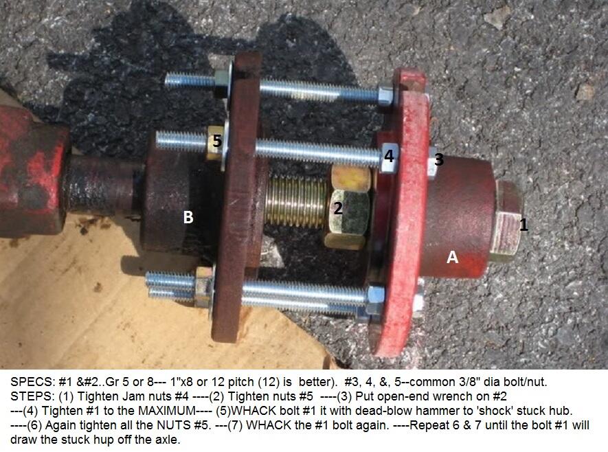

horseman with no horse 68 #31 Posted October 4, 2023 35 minutes ago, rjg854 said: Take the hub off and examine the keyway on the hub and the axle. Do you have any tips on taking off the hub safely/correctly? I know it’s very easy to rip the axle right out the trans casing. Also how would it go back on? Share this post Link to post Share on other sites
horseman with no horse 68 #32 Posted October 6, 2023 I’m currently waiting on my new head gasket to arrive so In the mean time I’m goin to see if I can build a similar tool to the pullers people built on other forum posts. I need either a used hub for the studs or some other flat metal disk that will hold my jack and studs. I’ll keep looking around and when I get the hub off I’ll post my findings Share this post Link to post Share on other sites
daveoman1966 3,884 #33 Posted October 6, 2023 I made this from a used HUB... I can send you a junk hub to make one for yourself... $30 shipped. Share this post Link to post Share on other sites
