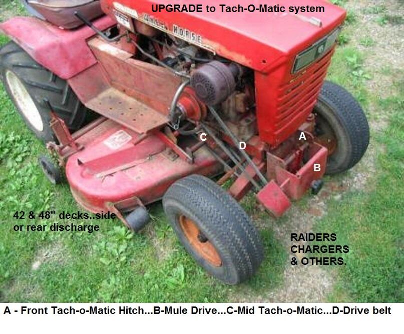

daveoman1966 3,884 #6 Posted September 9, 2023 6 hours ago, JimmyJam said: So I have a 1968 Electro12. I would like to add a mower deck. Apparently I need a Speed Hitch #85211 (No Longer I've made a free DOWNLOAD file named UPGRADE.pdf. It'll show you what to do to 'upgrade' the Electro 12 to accept the 'Tach-o-Matic implements.... with ease. This method eliminates the awkward SIDE belt drive... changing that to FRONT belt drive as is used from 1973 and newer model tractors. With this, most ANY mower deck can be used. This pic is a Raider 10 with the UPGRADE...from a few years ago. MULE DRIVE UPGRADE.pdf 3 1 Share this post Link to post Share on other sites
