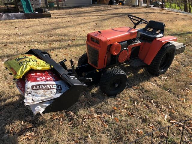

Sailman 1,306 #8 Posted September 4, 2023 (edited) I fabricated a "front end garden bucket" for my GT 14 and didn't want to deal with all the hydraulics. Definitely not the capacity of a true FEL but have been quite impressed with what it will do. Used just 1 super heavy duty linear actuator https://www.servocity.com/4-stroke-1-010-lb-thrust-super-duty-linear-actuator/ rated at 1010 lbs, but it is not cheap. By the time you add the weight of the bucket its probably good for maybe 300# of lift. I have run a second set of wires to hook up to a marine deep cell battery for extra strength operating it, located in the box on the 3 pt. hitch with 6 solid cinder blocks for weight. Thinking of upgrading to the 1500# even though it will be slower. Have about $1000 in the total build which serves my purposes just fine. Time will tell how it holds up, am optimistic, but will say it again...it ain't no FEL. IMG_3308.MOV Edited September 4, 2023 by Sailman 1 1 Share this post Link to post Share on other sites
