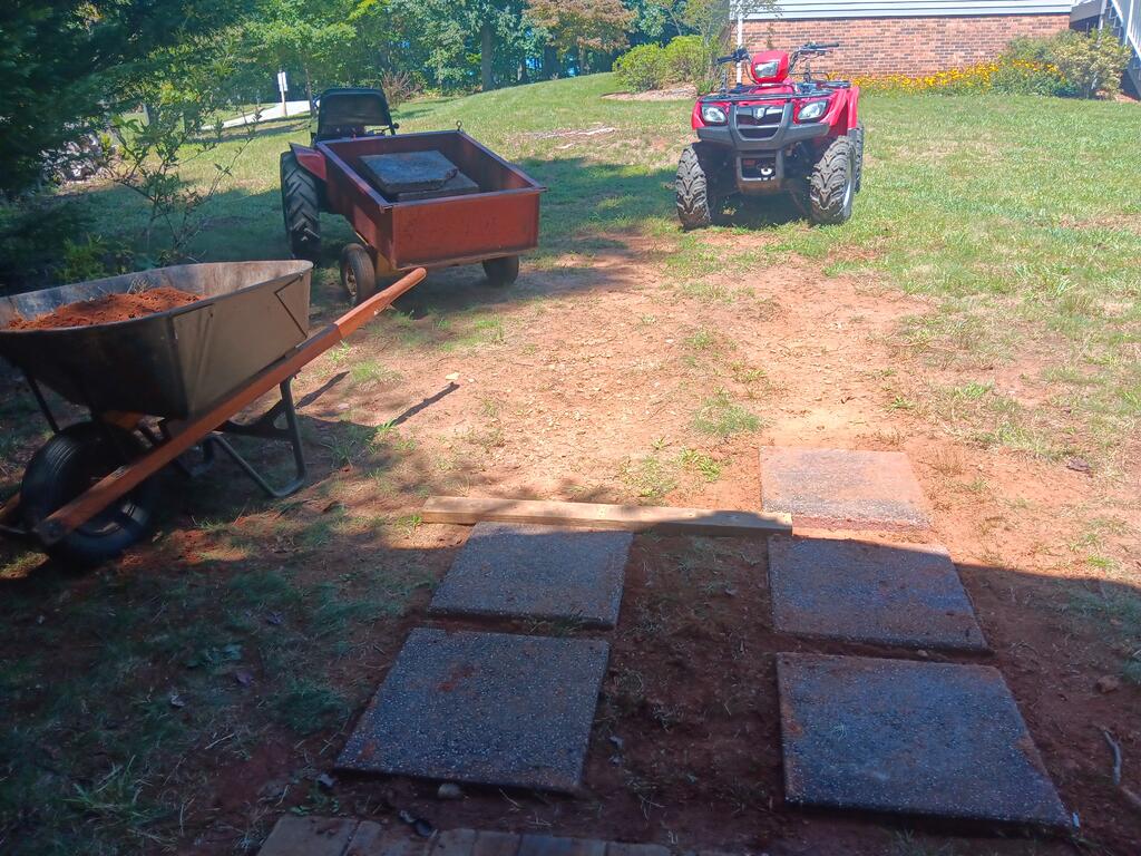

Skwerl58 843 #1 Posted September 1, 2023 (edited) Today I worked my 1054 for the first time to pull a trailer and the load was around 250 lbs. The trailer was at a steep angle because the lift has no down force so I now need a draw bar and pin that will fit on my tractor. Does any one have suggestions of where I might get one, used is fine? This is the only picture of the loaded trailer. When unloaded it is still at an angle that is steep to be transporting "grandbabies" and other stuff. Edited September 1, 2023 by Skwerl58 added picture 1 Share this post Link to post Share on other sites
SylvanLakeWH 32,695 #2 Posted September 1, 2023 Picture of issue would help... 1 Share this post Link to post Share on other sites
