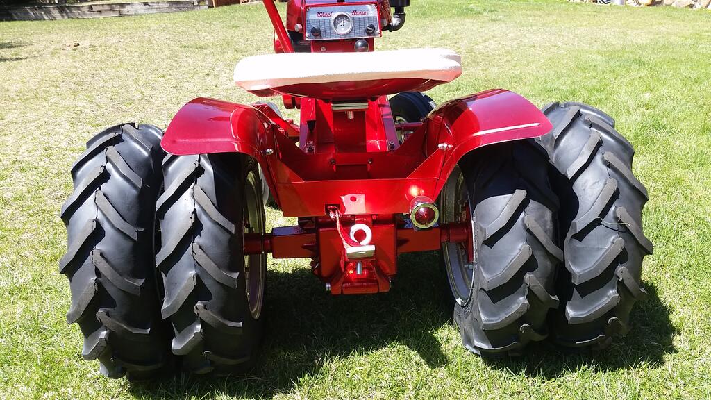

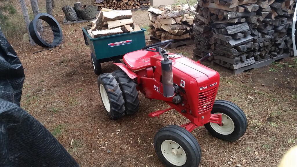

WHX?? 57,645 #12 Posted September 1, 2023 (edited) 14 hours ago, ri702bill said: would NOT use dual wheels on an early tractor with 3 bolt rear hubs. Beg to differ Bill... 'Course this 702 sees more time on trailer boards than dirt! Edited September 1, 2023 by WHX?? 3 4 1 Share this post Link to post Share on other sites

ri702bill 12,699 #14 Posted September 1, 2023 (edited) 1 hour ago, WHX?? said: Beg to differ Bill... 'Course this 702 sees more time on trailer boards than dirt! That Round Hood is way too purdy to be working in the fields. No Prom Queens here, all the girls get tasks for all four seasons to earn a spot in the garage...... Bill Edited September 1, 2023 by ri702bill 1 1 Share this post Link to post Share on other sites
squonk 47,779 #15 Posted September 1, 2023 2 hours ago, WHX?? said: Beg to differ Bill... 'Course this 702 sees more time on trailer boards than dirt! At first glance I thought that was a cobweb on the RT. outer tire! 5 Share this post Link to post Share on other sites
WHX?? 57,645 #16 Posted September 1, 2023 3 hours ago, ri702bill said: That Round Hood is way too purdy to be working in the fields. Sad part is it did use to! 1 4 Share this post Link to post Share on other sites

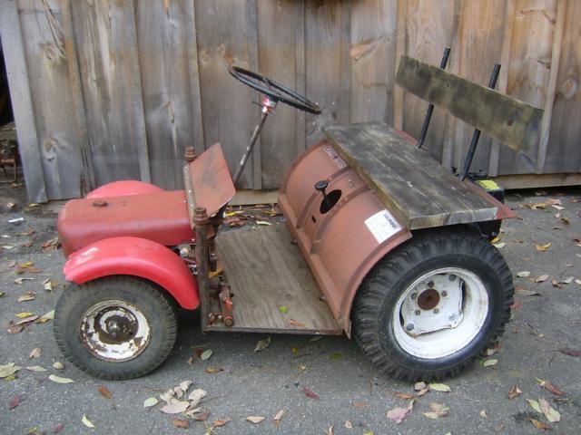

ri702bill 12,699 #22 Posted September 2, 2023 (edited) I'm still waiting for a picture of a tractor with dual rears that has a DECENT homegrown set of rear fenders to cover them. Not washtubs cut apart... Edited September 2, 2023 by ri702bill 2 Share this post Link to post Share on other sites

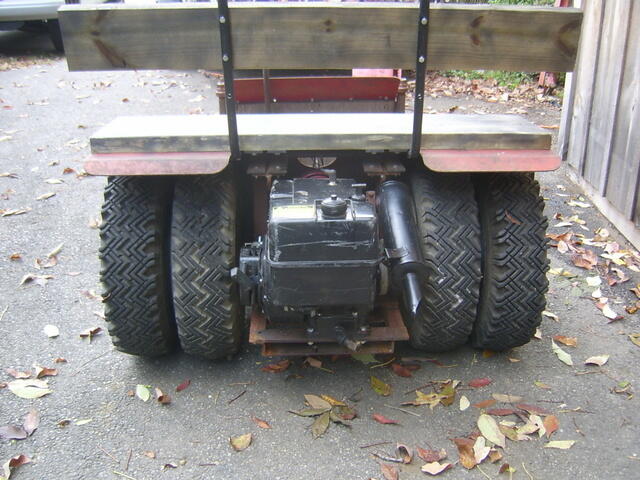

wallfish 20,386 #25 Posted September 3, 2023 (edited) On 9/2/2023 at 6:23 AM, ri702bill said: I'm still waiting for a picture of a tractor with dual rears that has a DECENT homegrown set of rear fenders to cover them. Not washtubs cut apart... Ask and you shall receive! LOL This one had dual 6-12s on it. Probably not what you meant but the fender is definitely homegrown and covers them. Snow blower side wings just happen to be a nice fit for the rear too. Back rest pipes were above because the possibility of a canopy top but that never happened. Can't believe this was done way back in 2012. Seems a lot less than that! Then a clone was done and still think'n about doing another one. Edited September 4, 2023 by wallfish 1 5 Share this post Link to post Share on other sites
