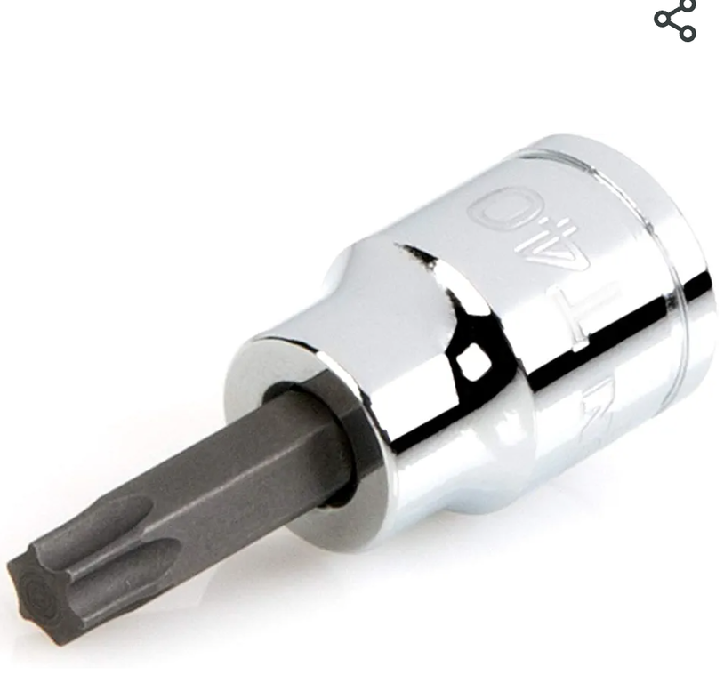

moe1965 774 #5 Posted August 30, 2023 (edited) I just went through this with my tractor I heated up a little with a torch and then found a torques bit that was close tapped it in the rounded out Allen head hole and it came right out. Assuming this is the same type of plug you are having issues with I used the torques bit style that goes on a ratchet socket rench Edited August 30, 2023 by moe1965 More info 2 Share this post Link to post Share on other sites

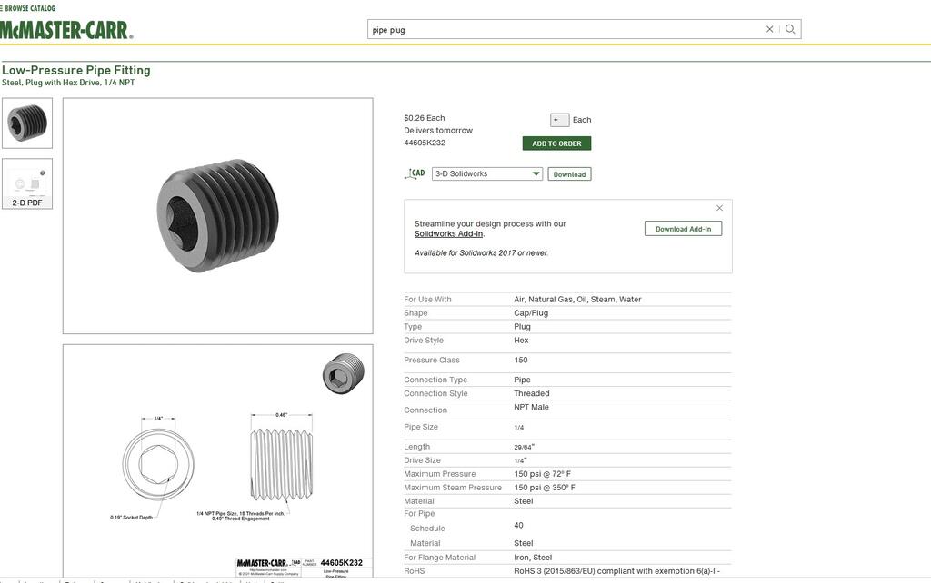

Skwerl58 831 #7 Posted August 30, 2023 I just replaced the plug on my older Wheel Horse and it was a standard 1/4" npt plug and picked it up at Advance Auto. I had to get mine out with vice grips due to the hex head being stripped but it had threads below the case. 1 Share this post Link to post Share on other sites
Dreamcatcher 102 #8 Posted August 30, 2023 Where might I find a replacement plug? The local HD does not seem to carry it..TSC? Dpes anyone know the correct size? Share this post Link to post Share on other sites
ebinmaine 80,091 #9 Posted August 30, 2023 13 minutes ago, Dreamcatcher said: anyone know the correct size? 18 minutes ago, Skwerl58 said: 1/4" npt Unless it's been modified from stock I believe that will be it Share this post Link to post Share on other sites
ebinmaine 80,091 #10 Posted August 30, 2023 Hardware store. Plumbing supply. Auto Parts store. Possibly even Garden supply. If you have to go mail order you could go mcmaster-carr. If you have a few days to wait I could send you one. 1 Share this post Link to post Share on other sites
Ed Kennell 46,798 #12 Posted August 30, 2023 ACE Hardware has 1/4" NPT pipe plugs. 1 Share this post Link to post Share on other sites
rmaynard 17,495 #13 Posted August 30, 2023 (edited) 5 hours ago, Dreamcatcher said: ...it seems that the plug is damaged/rounded... How much of the plug is still sticking out. If you have at least 1/8", you should be able to get a pair of vice-grips on it. If not, clean the inside of the 1/4" Allen hole of all grease and dirt. Then get Torx bit that is slightly larger then a 1/4" Allen, probably T40, and drive it in. Then use your 3/8" drive to turn it out. Edited August 30, 2023 by rmaynard 2 Share this post Link to post Share on other sites
