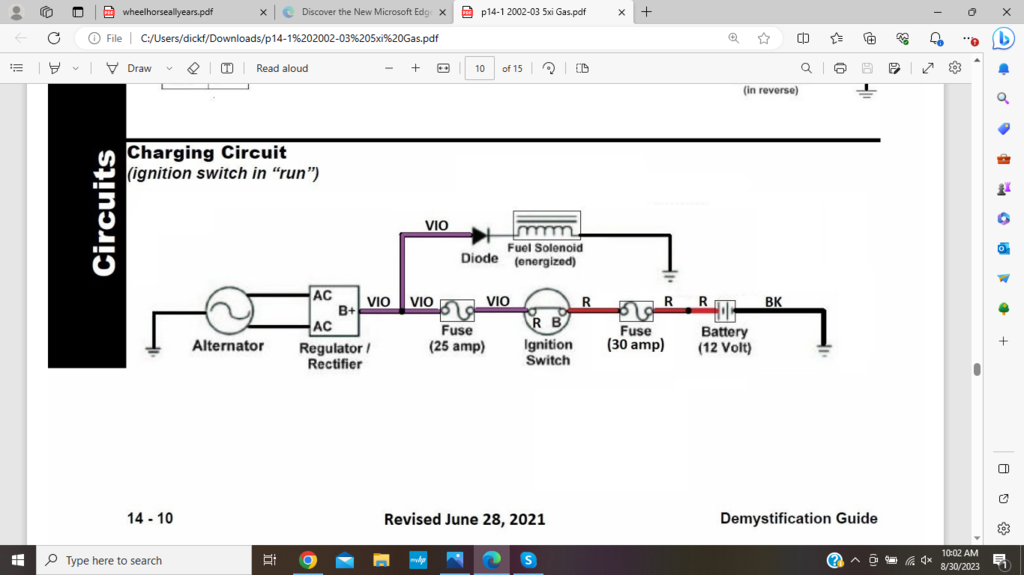

953 nut 64,647 #5 Posted August 30, 2023 As @lynnmor said, the charging system is not complicated. The diagram below is you entire charging system from start to finish. With the engine running you should read from 25 to 35 +/- AC Volts across the two AC terminals on your voltage regulator and the B+ terminal needs to have 12 Volts DC +/- with the key on. Since the engine runs it is reasonable to presume the 25 amp fuse is good. Share this post Link to post Share on other sites

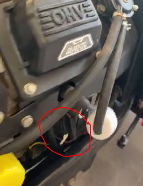

JoeM 9,677 #6 Posted August 30, 2023 If the fuses are good and you need to check the voltage at the regulator. Sitting in the seat you need to remove the left engine cover. Located in the bottom corner on the fly wheel shroud is the voltage regulator. If anything was left unplugged this is where you will find it. You can check for the AC voltage coming from the stater and the DC out put of the regulator. It has three leads that go into one plug that connects to the regulator. The regulator is almost impossible to change without loosing the engine and raising it up. 2 Share this post Link to post Share on other sites
gwest_ca-(File Mod) 12,066 #7 Posted August 30, 2023 1 Share this post Link to post Share on other sites
