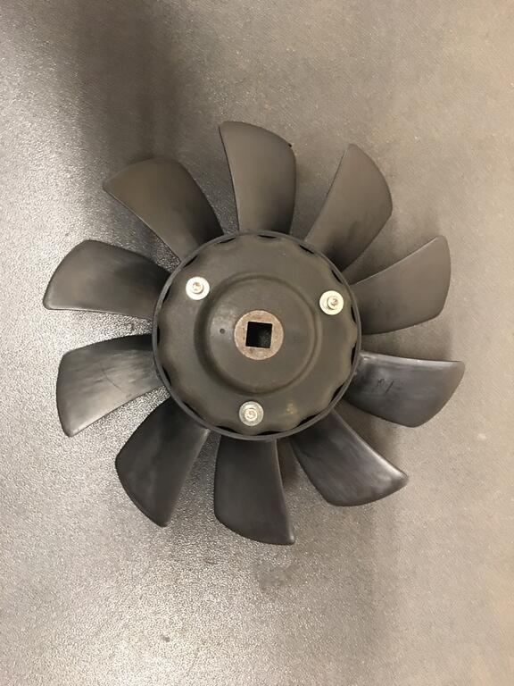

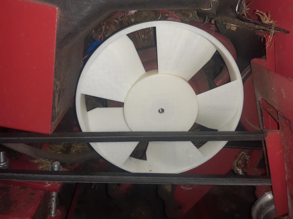

Damien Walker 297 #1 Posted August 28, 2023 My understanding is that if you wish to use a rear mounted vacuum bagger that is pto driven on the Eaton Hydro tractors (C175 on?), then you need a smaller plastic fan.....which as far as I am aware, is no longer available! I have been running a home brew vacuum bagger and thought I had managed to improve the fan to belt spacing but clearly hadn't, following the discovery of there no longer being any blades on my fan! The problem is mostly caused by the lack of clearance and it is not helped by the fact that the belt is very long and there's no lateral control of it (no guides). As the fan has hook type leading edge blades, they are prone to grabbing the belt and not leaving go...until the blade comes off. My thoughts are that if I can remove the ability of the blade to hook onto the belt, the problem will probably be solved. The odd occasional belt/blade strike should not then be a problem if the fan can't grab it. My solution then was to use a fan with a rim that acts as a shroud to protect the blades should the belt get too close.....but have been unable to find such a thing. Solution = CAD and 3D printing! So here's the latest version. It is unfortunately just a little too deep and the rim fouls the transmission drive belt so there's a revised version now printing. My very first attempt was ineffective, but this one produces a gale when running at 2200rpm (the fastest my lathe will go). I think the transmission runs at engine speed (3600rpm max) so I am hopeful that this fan will work well. Whether it survives the belt proximity, remains to be seen, but I'll update this post when I have the final version and have tried it for real. I haven't thought about what price to charge yet, but I'd be happy to print more if anyone is interested. My guess would be $25-40...they take hours to print and the cost depends very much on how solid you want the print to be (you can control the amount of infill and it's trade off between strength and weight and ultimately cost) 6 Share this post Link to post Share on other sites

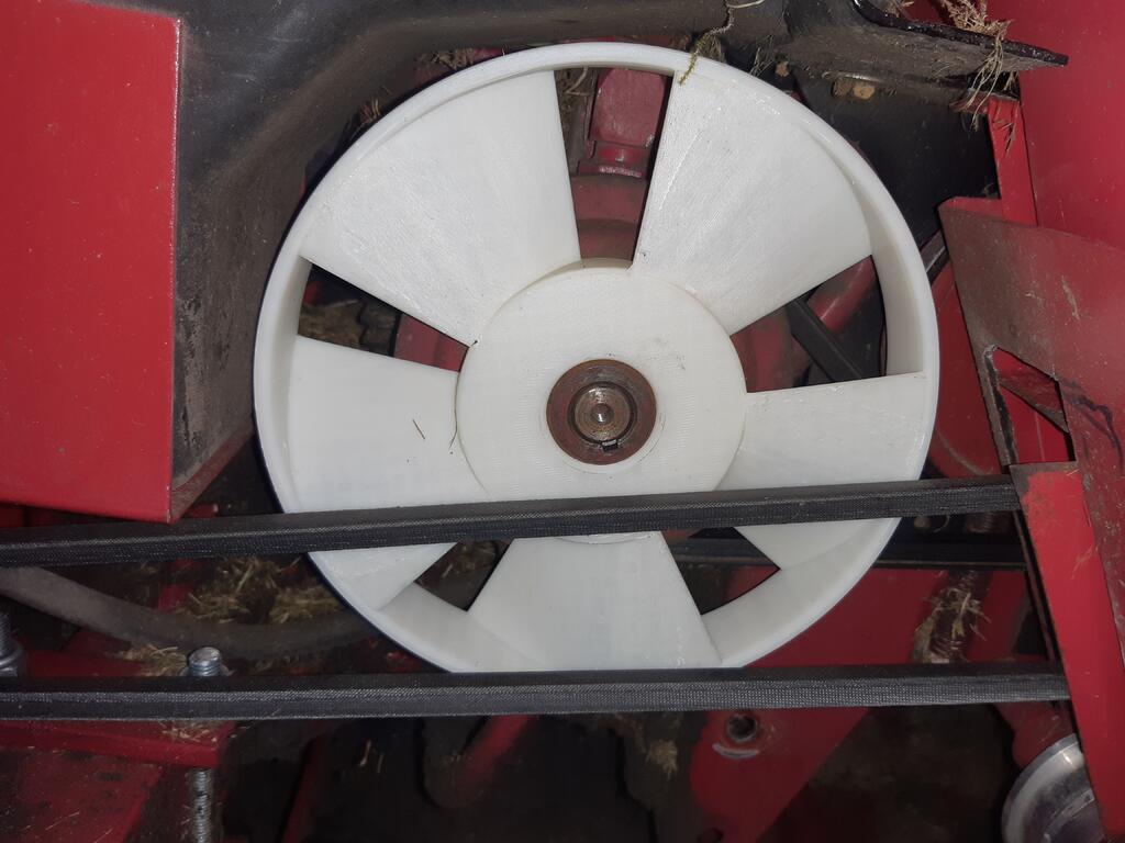

Damien Walker 297 #8 Posted August 30, 2023 I had to tweek some dimensions...the outer rim was fouling the transmission drive belt jockey pulley (ie outer diameter was too large) and I think the rear offset was also too big, meaning that it was likely the transmission drive belt would rub on the fan. I have also filled in the central hub hole so that fan covers the end of the shaft as per the original: I'll hopefully be able to take it for a test mow over the weekend when the weather is forecast to improve...and will report back. I have added a flat idler pulley on the transmission input shaft to help guide the pto belt past the fan and below the tank mounting...hopefully this will help keep the two apart. 2 Share this post Link to post Share on other sites

ineedanother 2,539 #11 Posted August 31, 2023 Looks great @Damien Walker but it also looks like the cooling fins are packed full of grass cuttings and debris. Probably worth sliding that tank back and blowing that mess out of there Maybe it's not as bad as it looks in that pic. Share this post Link to post Share on other sites
Damien Walker 297 #12 Posted August 31, 2023 1 minute ago, ineedanother said: Looks great @Damien Walker but it also looks like the cooling fins are packed full of grass cuttings and debris. Probably worth sliding that tank back and blowing that mess out of there Maybe it's not as bad as it looks in that pic. Thanks for the advice....it looks worse than it actually is but does need a clean. Double whammy of a burst oil pipe and a scarifying session which was very dusty...and all immediately after the full rebuild (it's a 518H). 1 Share this post Link to post Share on other sites
Damien Walker 297 #13 Posted September 4, 2023 My 3D printed fan survived the mow test run. I had it running for around 30mins in our current Indian summer @ around 27 degrees C ambient....which is quite warm for us! As far as I can see without taking the wheel off again, I suffered no belt strikes and the fan is clearly intact and running smoothly so it looks like a winner at this time. Unfortunately, I also collected a puncture in the left hand front wheel which reduced my speed and hence the stress on the tractor somewhat, but when I finished, the transmission wasn't overly hot to the touch and there seemed to be quite a breeze blowing in the under-fender area. (I blew the accumulated muck out of the cooling fins with an air line!) 1 Share this post Link to post Share on other sites
Damien Walker 297 #14 Posted September 3, 2024 Quick update: Mowed a reasonably large area of long lush grass this weekend, the longest grass I have cut to date. The mower performed faultlessly, but as I put it back on the trailer I could see through the wheel arch that my rimmed fan was badly clogged.....and I think the rim is the cause as the usual centripetal force now doesn't clear the cuttings. Perhaps I should rethink and make the same fan but without the rim....I'll report back if I make progress. 1 1 Share this post Link to post Share on other sites
