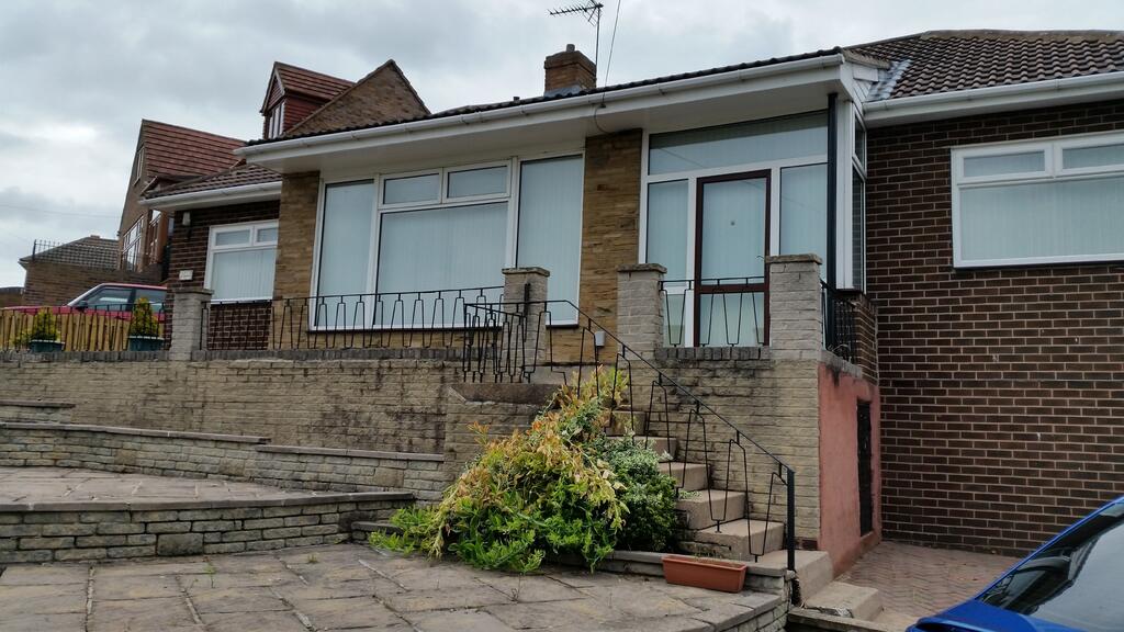

Mickwhitt 5,191 #27 Posted September 19, 2023 This is a photo of the house windows as they were before we moved in. You can see there are only three major units where the new one has five, and the side units run from top to bottom with no glazing bars or opening top lights. With luck my strengthening struts have returned the new window to the same kind of strength as this one. The wind she is a rising and we will get our first taste of how the upgrade performs. Mick Share this post Link to post Share on other sites
