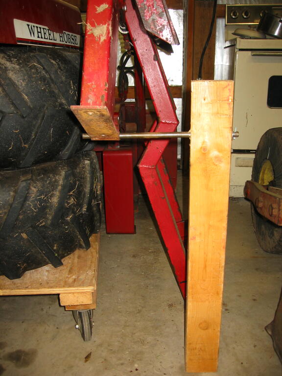

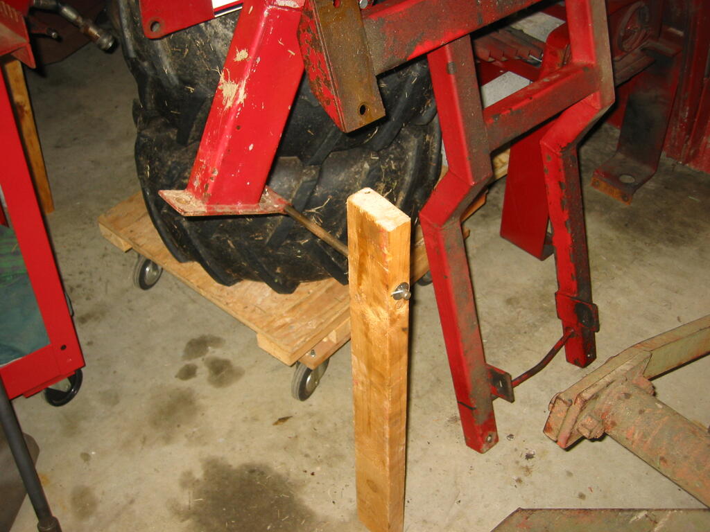

pfrederi 21,221 #2 Posted August 25, 2023 Mine is an Arc loader but has similar round tubes for stilts. I made mine 2x4 and steel rod. Long enough to hold the loader frame high enough to back D200 out. Put the things in angled to the rear. stand on tractor lift up till the legs are straight down. The ARC loader has a nice cross brace between the towers to lift on. 1 2 Share this post Link to post Share on other sites
lynnmor 9,051 #3 Posted August 25, 2023 You really should make some stilts, the owners manual shows how they are used. I made mine from strut channel, round bar stock and flat plate. Make it just high enough for the front tires to clear. I use a hairpin clip to retain the bar in the holes provided on the loader. 1 Share this post Link to post Share on other sites

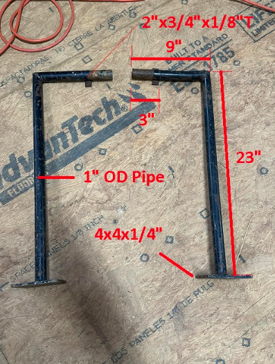

JoeM 10,317 #7 Posted August 26, 2023 Someone sent me these measurements for stands if you want to do your own. 1 Share this post Link to post Share on other sites
