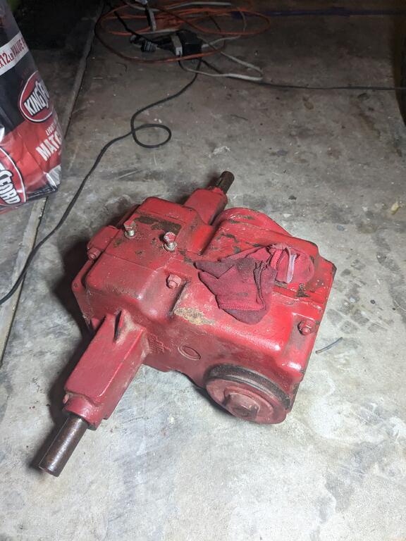

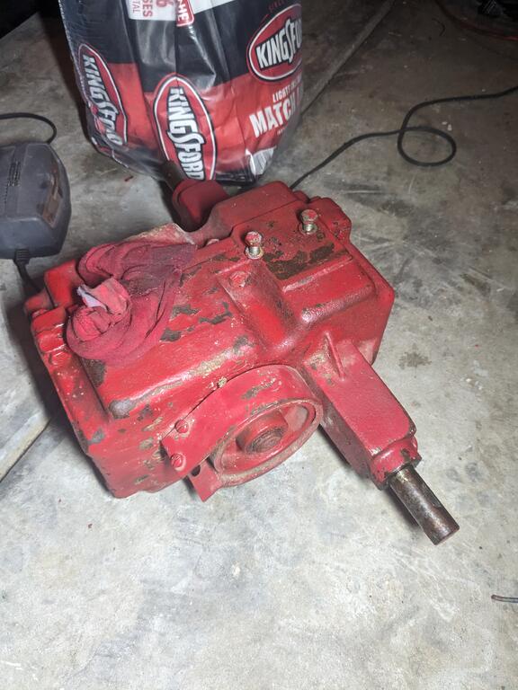

Treepep 1,137 #1 Posted August 24, 2023 So, I got this 4 speed transmission in a lot of miscellaneous tractor parts. Most of them I have traded or sold. I plan to rebuild and shelf it. I would like to know what it is so we can get parts. It moves freely, no shifter. Oil in it was synthetic and clean. Garage kept. Just casting numbers 3800 h or n? Thanks in advance for your knowledge! 1 Share this post Link to post Share on other sites
953 nut 67,257 #2 Posted August 24, 2023 What size axles does it have, 1" or 1 1/8"? Share this post Link to post Share on other sites
Pullstart 70,447 #3 Posted August 24, 2023 46 minutes ago, 953 nut said: What size axles does it have, 1" or 1 1/8"? I don’t think there were any 3 speeds with 1-1/8” axles, were there? Share this post Link to post Share on other sites
johnnymag3 2,646 #4 Posted August 24, 2023 I believe he mentioned it was a four-speed? Share this post Link to post Share on other sites
gwest_ca-(File Mod) 12,328 #5 Posted August 24, 2023 1 hour ago, Pullstart said: I don’t think there were any 3 speeds with 1-1/8” axles, were there? 5045 used in 953 5047 used in 1054 5051 used in 1054A 5058 used in 1057 and 1257 5059 service replacement for 5045, 5047 and 5051 3 1 Share this post Link to post Share on other sites
Treepep 1,137 #6 Posted August 24, 2023 41 minutes ago, johnnymag3 said: I believe he mentioned it was a four-speed? I believe he told me it was an old four speed? Not my expertise. Axles are 1'' I have never rebuilt a transmission and this one seems fine sans the shifter. I want to go through it and maybe learn something??? Thanks folks 1 1 Share this post Link to post Share on other sites
Pullstart 70,447 #7 Posted August 24, 2023 23 minutes ago, gwest_ca said: 5045 used in 953 5047 used in 1054 5051 used in 1054A 5058 used in 1057 and 1257 5059 service replacement for 5045, 5047 and 5051 oh yeah, why didn’t I think of those? 2 Share this post Link to post Share on other sites
squonk 47,288 #8 Posted August 24, 2023 (edited) I think all of the internals are the same 2 piece 1" axle transmissions. The only difference I know of is the spline shaft had 2 gears that slipped on and were keyed on the early ones and later ones the bottom gear was pressed on but they interchange. Edited August 24, 2023 by squonk 1 Share this post Link to post Share on other sites
stevasaurus 23,738 #9 Posted August 24, 2023 (edited) Mike is a little confused. The spline shaft has the fork gears on it. Mike is thinking of the cluster gear shaft. The trans is a 3 speed #5007, #5025 to #5053 (depending on what horse it came out of. I would call it a #5025 until you open it. The differences would show themselves as 1. size of drain and fill plugs 2. shift rails and how the groves are cut. Anyway, it is a 3 speed with reverse, uni-drive because of where the brake drum is located...on the mushroom gear 11/44 tooth gear. The bearing and seal information is in PDF #2 here. https://www.wheelhorseforum.com/topic/42506-bearing-and-seal-cross-numbers/ Edited August 24, 2023 by stevasaurus 2 2 Share this post Link to post Share on other sites
stevasaurus 23,738 #10 Posted August 24, 2023 The transmission models that GWest listed are 3 speed, but they are considered heavy duty. Those transmissions all have 1 1/8" axles and the bevel gear differentials. Treepep's transmission is 1" axles and therefor has the 4 pinion differential. All 1" axles have 4 pinion differentials. The 4 speeds have the brake drum on the cluster gear shaft. 1 Share this post Link to post Share on other sites
squonk 47,288 #11 Posted August 24, 2023 36 minutes ago, stevasaurus said: Mike is a little confused. The spline shaft has the fork gears on it. Mike is thinking of the cluster gear shaft. The trans is a 3 speed #5007, #5025 to #5053 (depending on what horse it came out of. I would call it a #5025 until you open it. The differences would show themselves as 1. size of drain and fill plugs 2. shift rails and how the groves are cut. Anyway, it is a 3 speed with reverse, uni-drive because of where the brake drum is located...on the mushroom gear 11/44 tooth gear. The bearing and seal information is in PDF #2 here. https://www.wheelhorseforum.com/topic/42506-bearing-and-seal-cross-numbers/ "Little confused ? " More like a lot! I was picturing the shaft with the woodruff keys in my mind when I typed but my left brain typed spline. What day is it anyway? What time is dinner? 3 Share this post Link to post Share on other sites
