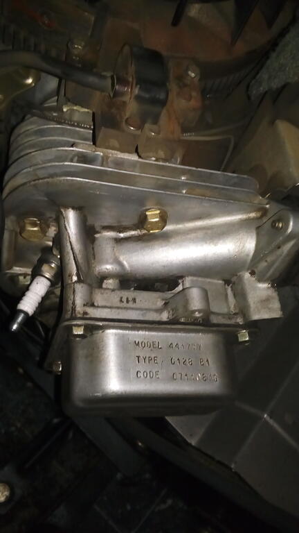

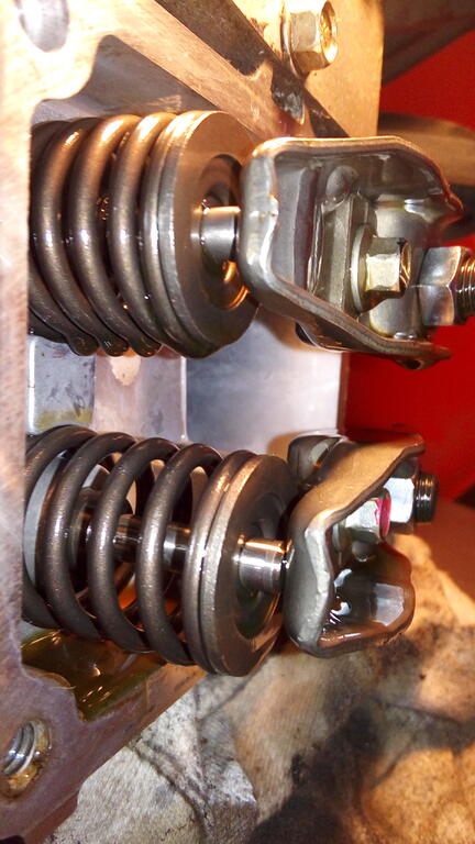

Lman 14 #3 Posted August 23, 2023 (edited) Thank you, I looked at a few videos as well to get me going. Damage from overheating seems common with these air-cooled engines. Already found an issue with a valve guide that looks like it's come out a bit and has loosened a rocker, will check the other cylinder tomorrow when I've got more light. Pushrods appear ok, but I will have a better look. Bottom rocker jiggles about a bit, top one feels solid. Update: I was wrong, there is a little play in the rockers when they are not pushing down the valve, of course. Other side looks fine as well. Rods are all in position and not bent. I can't see any guides that have come out either, but it's hard to see. I probably need to stuff a bit of rope through the spark plug hole to prevent the valves from falling out and take the springs off. It's been years since the clearance on those rockers has been adjusted, maybe that will help fix it? No mice nests either, there's some crud there which I will try and clean off but not as much as I might have expected. Edited August 24, 2023 by Lman Share this post Link to post Share on other sites

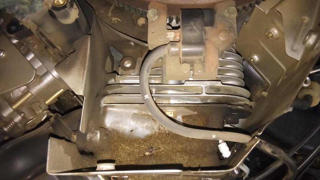

Lman 14 #4 Posted August 28, 2023 (edited) I cleaned the dirt off the outside of the cylinder heads, there wasn't all that much but perhaps enough to cause cooling issues. I was able to finish the mowing without any problems. I suppose the metal plates around the engine are there to better direct the cooling airflow from the flywheel fan, but the lesson learned is that fine fragments of dirt and grass can accumulate behind them. Hoping the issue will not reoccur and this thread might be useful for other owners of Briggs & Stratton V-twin engines. Edited August 28, 2023 by Lman Share this post Link to post Share on other sites
