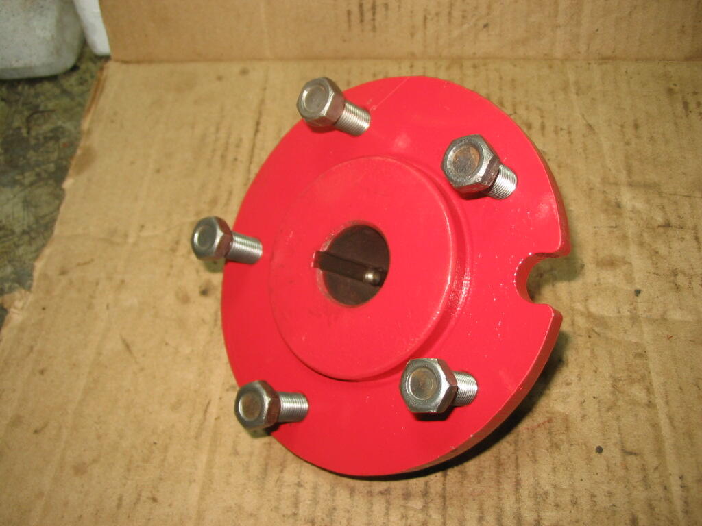

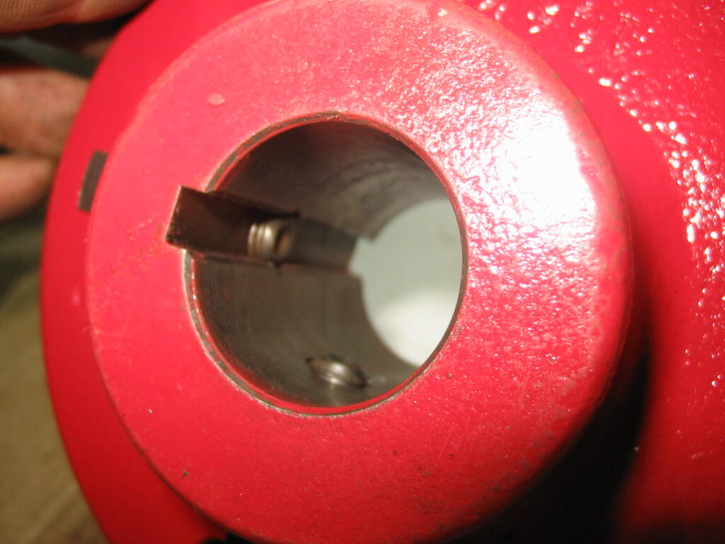

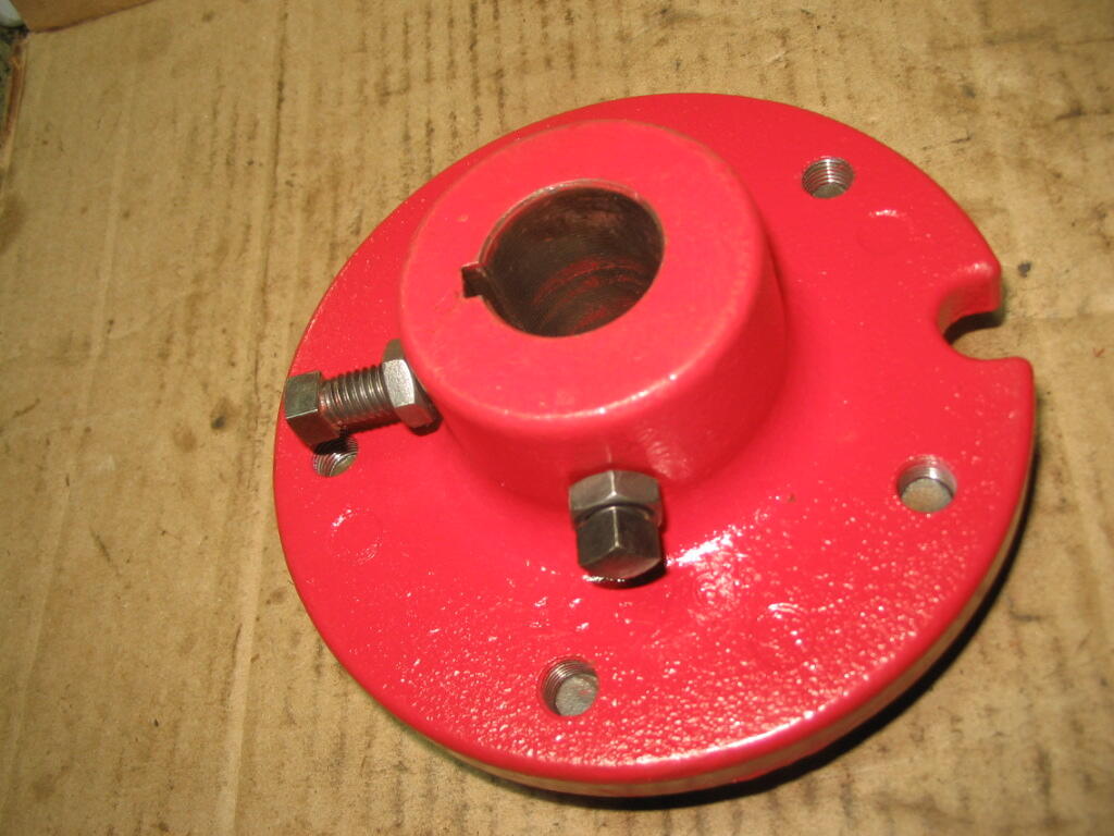

daveoman1966 3,884 #7 Posted August 22, 2023 8 hours ago, pumper23 said: I just acquired a c141 8 speed, rear hubs slide A little on the axle, set screw is tight , is this normal The rear hubs should NOT MOVE on the axle. ZERO movement is necessary as the KEYWAY slot will SLOP OUT...or both the hub and/or axle shaft. (1) Release the JAM NUT on each of the SET SCREW bolts. (2) Take the hub off (if possible) and inspect it AND the axle shaft. (3) Depending on condition of the keyway slots, retighten both the set screws...then LOCK them with the jam nut(s). I have FOUR like-new 1-1/8 ID Hubs if needed. Keyway slot is pristine. Sandblasted and repainted. look like this. Each has TWO----NEW set screws and Jam Nuts. $75 EACH + $10 TO SHIP... Two of them for $145...free ship. Share this post Link to post Share on other sites

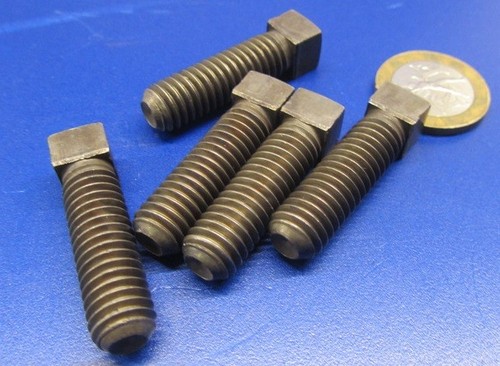

953 nut 69,418 #8 Posted August 22, 2023 Remove the set screws and inspect them, there should be a sharp edge contacting the axle/woodruff key. The set screw should be torqued to 35 foot-pounds and the jam nut torqued to 30 foot-pounds. 1 1 Share this post Link to post Share on other sites
