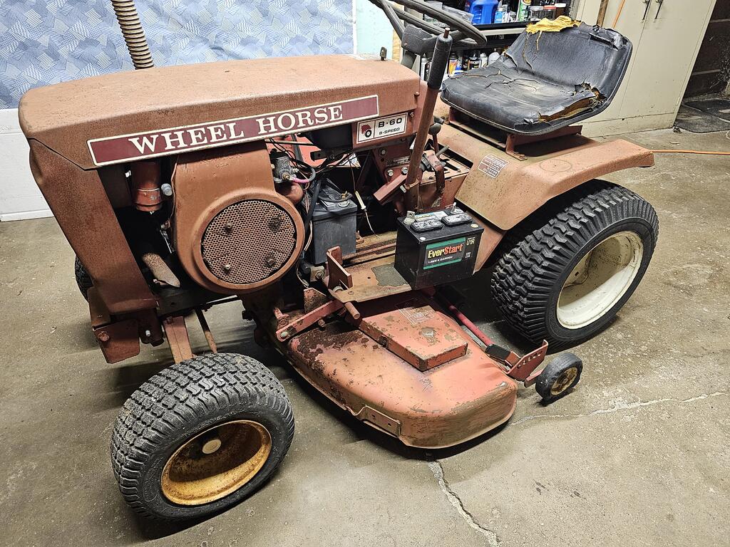

Jayoutdoors 107 #1 Posted August 21, 2023 I just purchased this 77B-60 with a 48" deck and tiller. Cleaned the points and fired it up after they said it sat 4 years! I'm asking for any guidance you can give me on finding parts for attachments etc. Right now need the "mule drive" for the tiller and would like a hitch. Front wheels for the deck. What part numbers should I be looking for. 3 Share this post Link to post Share on other sites

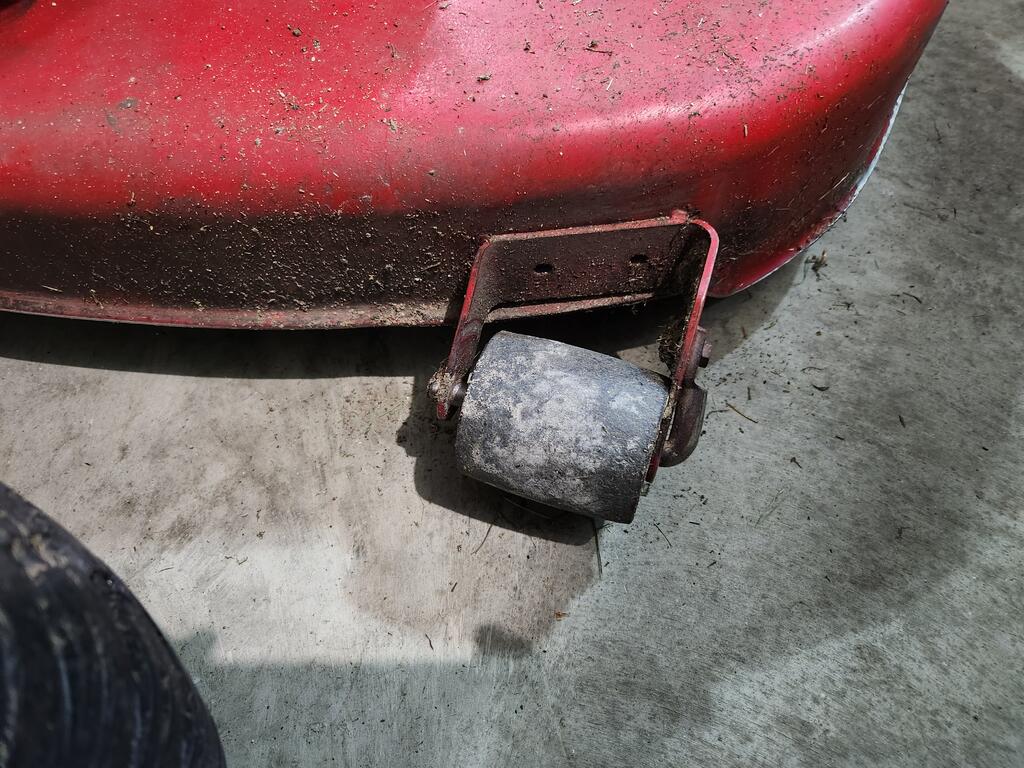

Racinbob 13,140 #5 Posted August 21, 2023 First............. to Here's a place to get tiller parts. Tiller Parts Archives - Wheel Horse Parts and More As far as the mower deck roller someone really cobbled those. They should look like this: That's also a 70's deck but I don't know for sure what yours is. You can be pretty sure it didn't come with that tractor new since it originally was a 7 horse. The roller and 'axle' are available but I don't know about the bracket. Maybe save yours? 2 Share this post Link to post Share on other sites

Jayoutdoors 107 #7 Posted August 21, 2023 17 minutes ago, Racinbob said: First............. to Here's a place to get tiller parts. Tiller Parts Archives - Wheel Horse Parts and More As far as the mower deck roller someone really cobbled those. They should look like this: That's also a 70's deck but I don't know for sure what yours is. You can be pretty sure it didn't come with that tractor new since it originally was a 7 horse. The roller and 'axle' are available but I don't know about the bracket. Maybe save yours? The brackets I can definitely save. The deck is a 76 48" cut. I did find that much. I will start researching the manual and classified section here. Thank@ 1 Share this post Link to post Share on other sites

Lee1977 7,764 #10 Posted August 21, 2023 (edited) You can google Wheel Horse deck rollers and get lots of options. New deck roller spindles can be made easily with 1/2" rod and some 1" flat if you can weld. As said above check out "Wheel Horse Parts & More" he sells a complete tiller drive with belt. Edited August 21, 2023 by Lee1977 2 Share this post Link to post Share on other sites

Jayoutdoors 107 #12 Posted August 21, 2023 1 minute ago, Lee1977 said: You can google Wheel Horse deck rollers and get lots of options. New deck roller spindles can be made easily with 1/2" rod and some 1" flat if you can weld. As said above check out "Wheel Horse Parts & More" he sells a complete tiller drive complete with belt. Perfect yeah I weld I can definitely make those spindles 1 Share this post Link to post Share on other sites
Racinbob 13,140 #13 Posted August 21, 2023 If you can save those brackets you're well on your way. 1976 and 1977 were unique in that the B-Series were identical to the C-Series except for a few bolt on items. Engine horsepower, high back seat vs low back, 15" steering wheel vs 13", 23-8.50 vs 22-7.50 rear tires, headlights standard on C's, optional on B's. Your B-60 started out with a rope start which is probably why there's no battery holder on yours. Someone did what looks like a clean job converting it to a "B-160". Here's my "B-160" It was a B-80 when I purchased it new. 4 Share this post Link to post Share on other sites
daveoman1966 3,884 #14 Posted August 21, 2023 1 hour ago, Jayoutdoors said: Perfect yeah I weld I can definitely make those spindles I have 2 or 3 of those 'flat bar' roller shafts here... can also get you the left side bracket from an old deck. You can, of course, use the one-piece formed found bar for the roller shaft. Have 5 or 6 of those...with or without roller. These have NEW nylon bushings... 1 Share this post Link to post Share on other sites
Ed Kennell 47,270 #15 Posted August 21, 2023 (edited) Wow , nice tractor. I mow with 42" and 48" decks 0n 12, 17 and 20HP tractors. I have to question using a 6-7HP engine to crank a 48" deck. I'm sure it will do it, but in lower gears. to the Jay. Oops, I just noticed She has a big block transplant. Edited August 21, 2023 by Ed Kennell 1 Share this post Link to post Share on other sites
Jayoutdoors 107 #16 Posted August 21, 2023 48 minutes ago, Ed Kennell said: Wow , nice tractor. I mow with 42" and 48" decks 0n 12, 17 and 20HP tractors. I have to question using a 6-7HP engine to crank a 48" deck. I'm sure it will do it, but in lower gears. to the Jay. Oops, I just noticed She has a big block transplant. Yup it sure does. Ran great mowed our acre with it last night. 1 Share this post Link to post Share on other sites
