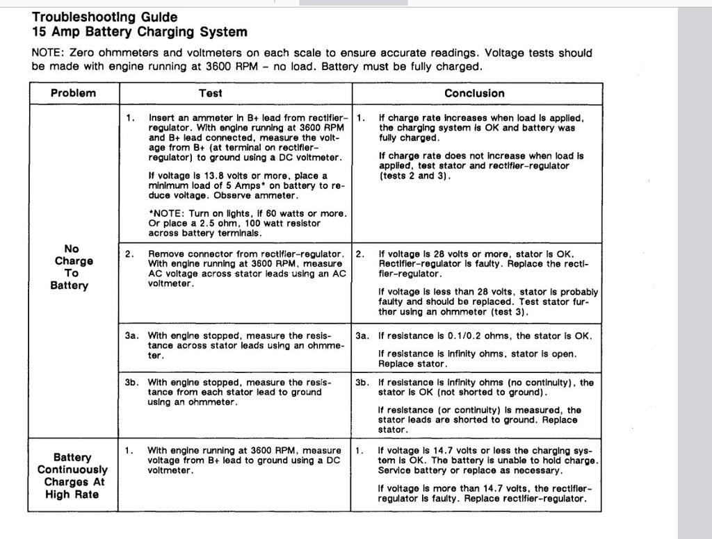

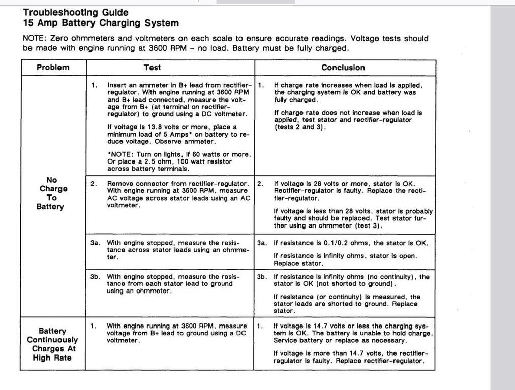

Reddart 213 #6 Posted August 23, 2023 Well, you folks that applied Occam’s razor to the problem were correct. Looks like a charging issue. The battery is only a few months old, so I don’t think it is that. I checked the tractor today and it only had 11.5v on the battery , jumped it with my car and it fired right up. Runs after disconnecting the jumper, but is at 11.7v while running. I assume I should see 13ish volts if it were charging while running? checked battery, ground, solenoid connects and all seems good. Haven’t checked the ammeter yet…I know that could be a point of poor charging should that be loose. Anything else to check? How does the charging system work on a Kohler 10hp C101? 1 Share this post Link to post Share on other sites
pfrederi 21,345 #7 Posted August 23, 2023 Diagnostics 1 1 Share this post Link to post Share on other sites
oliver2-44 11,850 #8 Posted August 23, 2023 Make sure your voltage regulator has a good ground. Share this post Link to post Share on other sites
