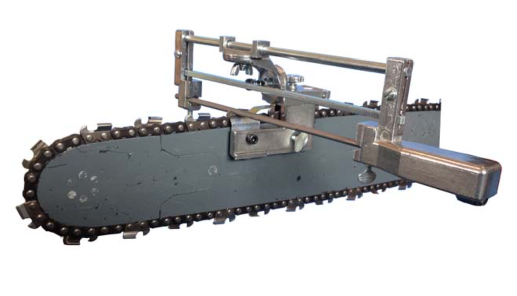

ebinmaine 63,157 #1 Posted August 20, 2023 A few weeks ago I ordered a Granberg G106B chainsaw sharpening jig. Yesterday was the first chance to put it to use. I'm impressed. We process 4 or 5 cord of firewood annually here so the right tool is important but we don't get the practiced touch of vast experience with sharpening by hand. I can do... Ok... I've tried a couple powered sharpeners. Both still depend on the user to create and hold a constant perfect angle. I may not want to admit it but I just don't have that kind of repeatable muscle control. I did better with hand filing but of course that's a science by itself if you want it done well. I needed a machine or jig that would hold its own preset angles. I wanted a non powered one just in case I needed it in the forest when there's no power source around. The Granberg here: https://www.granberg.com/product/g106b-file-n-joint-low-profile/ was invented over 60 years ago with nearly no changes according to the interwebs. I figured if it's been around that long maybe it works ok. Once it's out of the box and set up it takes just a couple to set it on the saw bar. Another 2 to 3 minutes for a quick and very accurate touch up of the chain and off ya go to cutting again. If you've ever once thought about buying something similar to this .. get one. I was very impressed with the difference in the chain consistency. Trina made one small cut. That was enough to convince her. 4 1 Share this post Link to post Share on other sites

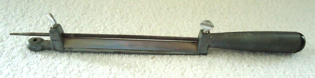

lynnmor 6,783 #4 Posted August 20, 2023 (edited) I use this type of Homelite filer that serves me well, I do need to watch the lines to keep the angle correct. I also dress the rakers ever time the saw is sharpened, keeping the depth of cut correct is a big factor in cutting efficiency. To file the rakers this is the type I use: Edited August 20, 2023 by lynnmor 4 Share this post Link to post Share on other sites

gwest_ca-(File Mod) 10,499 #6 Posted August 20, 2023 Have used the Granberg for years but only the feature that controls the depth the round file is in the tooth. Most chain manufacturers specify 1/5 of the file above the tooth leaving 4/5 of the file diameter in the tooth. A 7/32" file is .219" diameter so 4/5 is .175" the distance the file should be down into the tooth. Each number on the adjustment nut is approximately .010". Kiss the top of the tooth with the bottom of the file and then lower the file 17.5 numbers. The result is a chain that cuts really well and lasts longer between sharpening. I don't see any other way to to get the ideal tooth angle using a round file. Have drawn the setup to a very large scale and the 1/5 file above the tooth is spot on. 3 1 Share this post Link to post Share on other sites

ebinmaine 63,157 #8 Posted August 20, 2023 3 minutes ago, gwest_ca said: Have used the Granberg for years but only the feature that controls the depth the round file is in the tooth. Most chain manufacturers specify 1/5 of the file above the tooth leaving 4/5 of the file diameter in the tooth. A 7/32" file is .219" diameter so 4/5 is .175" the distance the file should be down into the tooth. Each number on the adjustment nut is approximately .010". Kiss the top of the tooth with the bottom of the file and then lower the file 17.5 numbers. The result is a chain that cuts really well and lasts longer between sharpening. I don't see any other way to to get the ideal tooth angle using a round file. Have drawn the setup to a very large scale and the 1/5 file above the tooth is spot on. That was the same recommendation by the YouTube video I saved for reference. Works excellent. 2 Share this post Link to post Share on other sites
Handy Don 10,609 #9 Posted August 20, 2023 I don’t have one of these but I’ve tried a borrowed one and liked it. The brackets that firmly grip and steady the chain link being filed are the real secret to its success, in my opinion. All the other “on the saw” sharpeners I’ve seen rely on the bar slot which always has a bit of play. 3 Share this post Link to post Share on other sites
