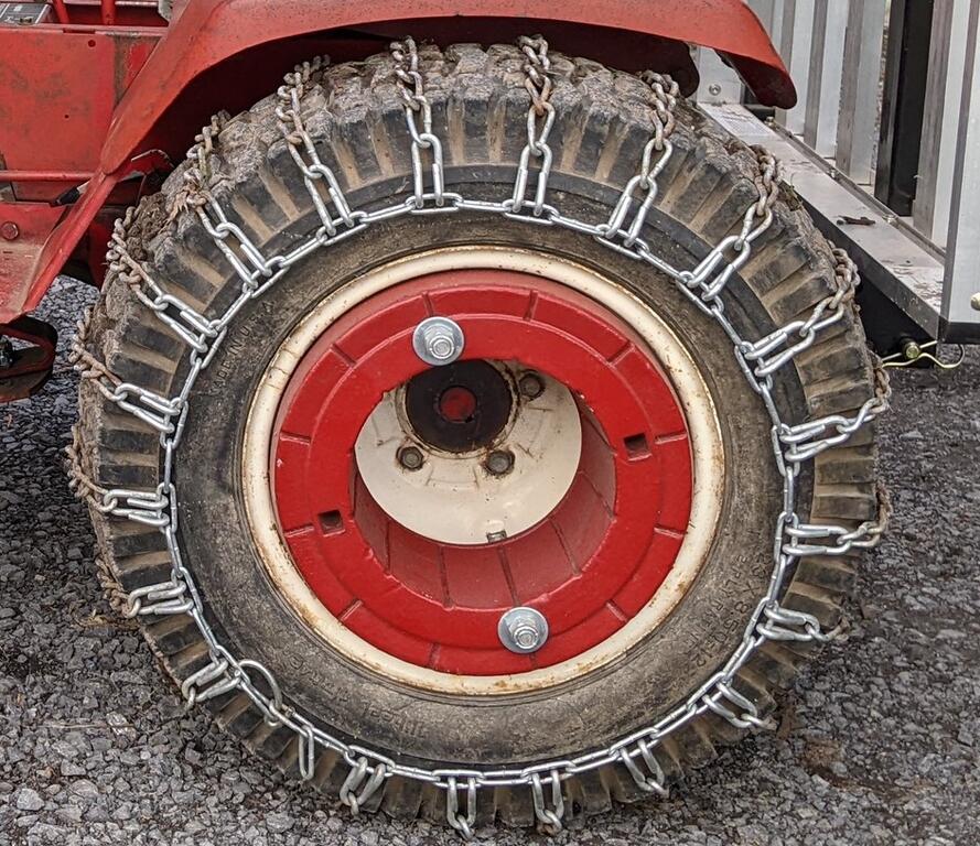

rjg854 10,761 #4 Posted August 18, 2023 12 minutes ago, eddiebunyan said: Did wheel horse ever have an official wheel weight other then the cement filled plastic ones? Here's is what a rear weight looks like 4 1 Share this post Link to post Share on other sites
squonk 38,988 #5 Posted August 19, 2023 (edited) 18 hours ago, rjg854 said: Here's is what a rear weight looks like Those weights were not made specifically for Wheel Horse. I got a set (white) that came on a Cub Cadet that was still owned by the original owner and came right from the dealer with them on. I have also seen them on AMF tractors. They are most prevalent on Wheel Horses. No idea of the company that actually made them. I also had a set at one time I bought from an old IH dealer that had sat on his shelf since the 60's still in their boxes. They were solid except for a small center hole and the 5 lugs. They weighed 70 lbs.a piece. the writing was worn off the boxes so the actual Co. name was gone. Engineered Productsv (Economy /Power King) had weights made and actually put a stamping on them to identify where they originally came from. Most of their tractors you see today have IH weights on them like mine. Ones with the stamping go for big money. Pretty sure the cement weights were/are made by one or 2 companies and the tractor makers just put their sticker on . Edited August 19, 2023 by squonk 2 Share this post Link to post Share on other sites

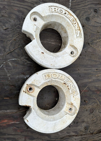

JoeM 7,689 #6 Posted August 20, 2023 I have seen steel ones with "Bolens" cast in to them. and I think International Harvester had some too. 1 Share this post Link to post Share on other sites
ebinmaine 63,276 #7 Posted August 20, 2023 50 minutes ago, Joey Small Block said: I have seen steel ones with "Bolens" cast in to them. and I think International Harvester had some too. We have a couple pairs of the Bolens weights here. Good n heavy. Share this post Link to post Share on other sites
squonk 38,988 #8 Posted August 20, 2023 I had a set of those nice heavy Bolens weights. Could hardly give them away at the flea market at our steam show. The 25 lb. IH weights fly off the shelves. 1 Share this post Link to post Share on other sites

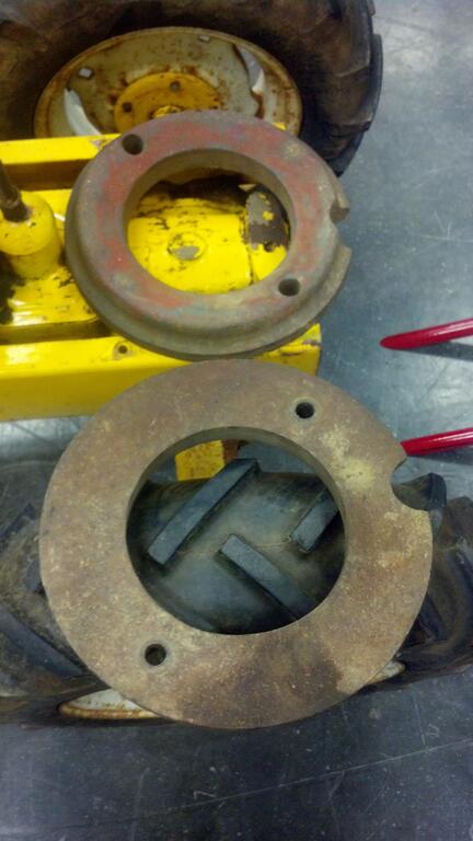

Mike in NC 318 #10 Posted August 22, 2023 I have been told these are Wheel Horse wheel weights. Share this post Link to post Share on other sites
squonk 38,988 #11 Posted August 22, 2023 9 hours ago, Mike in NC said: I have been told these are Wheel Horse wheel weights. Yes for RJ's and Suburbans. Inside weights 1 Share this post Link to post Share on other sites

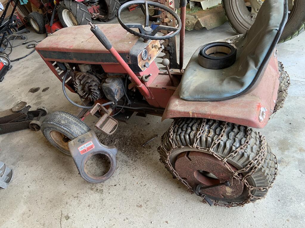

John2189 407 #12 Posted August 22, 2023 Is this a homemade one on my 656 ? It just has one one the left side. It has two bolts welded to it to bolt it to the wheel. I suppose it is to counter balance the sickle mower Share this post Link to post Share on other sites
squonk 38,988 #13 Posted August 22, 2023 4 hours ago, John2189 said: Is this a homemade one on my 656 ? It just has one one the left side. It has two bolts welded to it to bolt it to the wheel. I suppose it is to counter balance the sickle mower Looks similar to an old Simplicity walk behind tractor weight. Share this post Link to post Share on other sites
