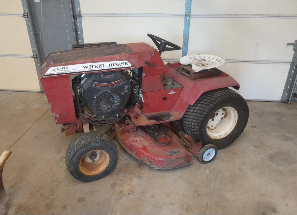

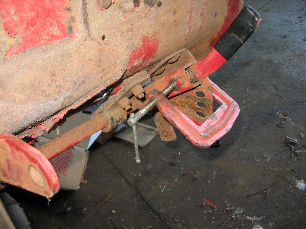

gilstr 16 #1 Posted August 17, 2023 Why is it next to impossible to change deck height on these. Right now I'm slowly remembering what a pain wheel horse mower decks are in some ways. I had a Raider before with 36 rear discharge but swore it was no problem changing the deck height. Nothing seems outta place or bent. But getting the handle to unlatch to move wheels up or down is almost impossible. Sometimes I can't keep up with my grass so mowing a little higher helps but anytime I need to I'll have to unhook level rod put wheels where I want and relevel again. Or is that just how it is supposed to work ? Share this post Link to post Share on other sites

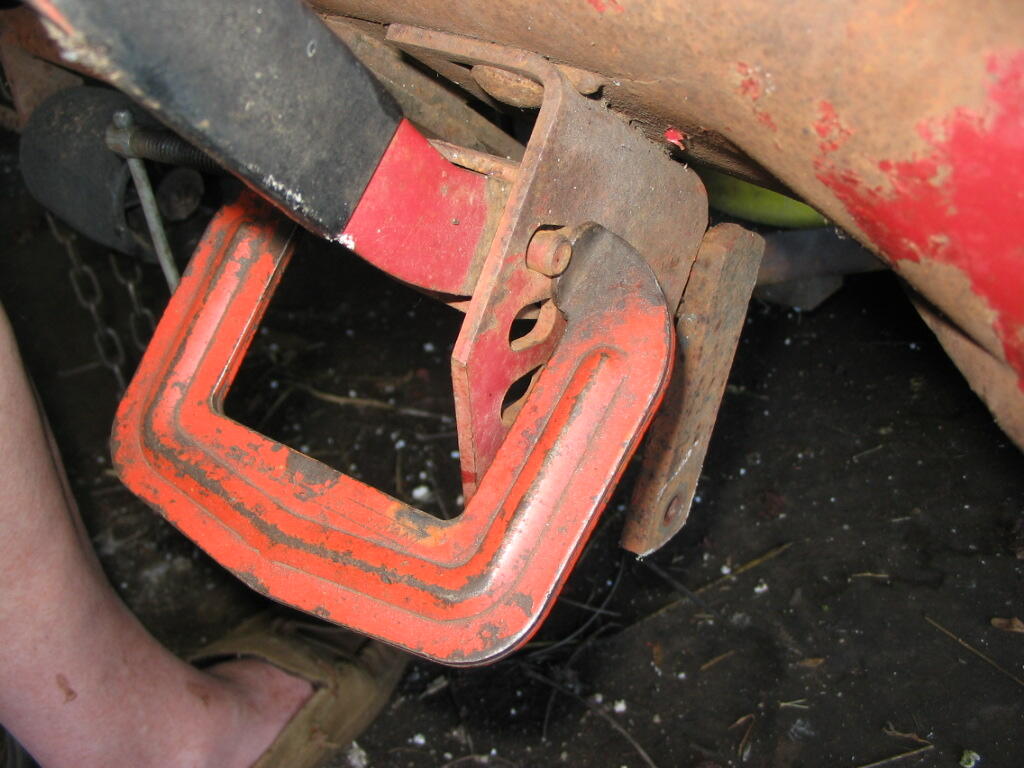

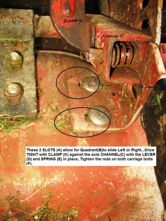

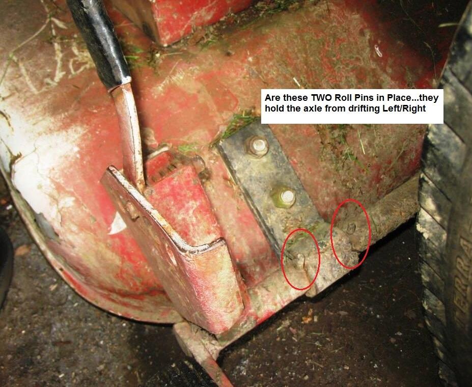

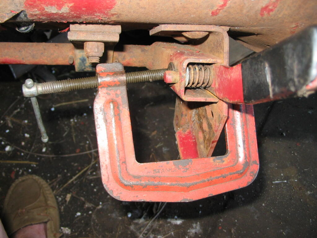

daveoman1966 3,839 #3 Posted August 17, 2023 I bet you need only to reset the HDIGHT ADJUST QUADRANT. They get bent or work loose over the years. You'll probably have to remove the deck to do this. Follow what is in this pic... should solve the problem. If the QUADRANT is bent, you'll have to remove it and hammer back into shape. 3 1 Share this post Link to post Share on other sites

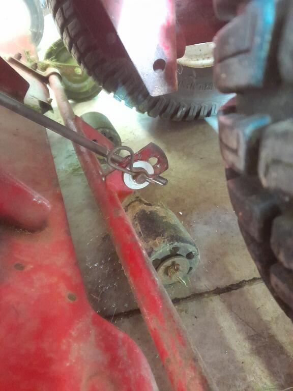

gilstr 16 #11 Posted August 18, 2023 (edited) So I figured out that was in wrong hole. That's how it was when I bought it. So now it's right Edited August 18, 2023 by gilstr 1 Share this post Link to post Share on other sites
