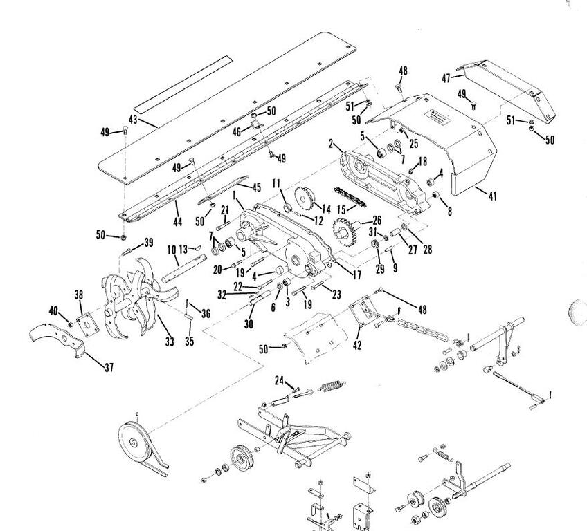

mike avad 61 #1 Posted August 17, 2023 are there oil seal for the tine ? I just got this a few day's ago and have some gear oil come from around the tine shaft and around where the big pully there a not tag on this for info so am able to find the right seal's and am not sure if this is the right part's I need #103118 tiller #100441 oil seal. this what I found on wheel horse part's and more.THANK YOU 1 Share this post Link to post Share on other sites

pfrederi 21,221 #4 Posted August 17, 2023 (edited) If you want the tines shaft seal #7 it is WH 100318 and you need 4 2 per side SKF 12330 Input shaft is 100441 only 1 needed SKF 7410 Edited August 17, 2023 by pfrederi 3 Share this post Link to post Share on other sites
