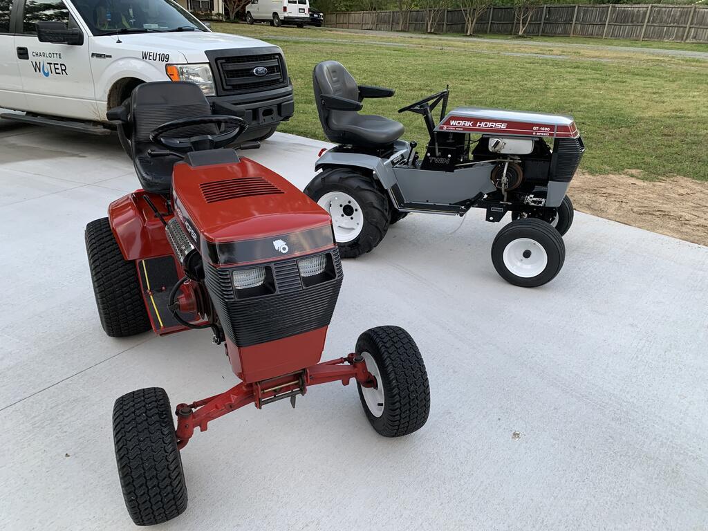

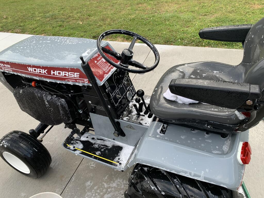

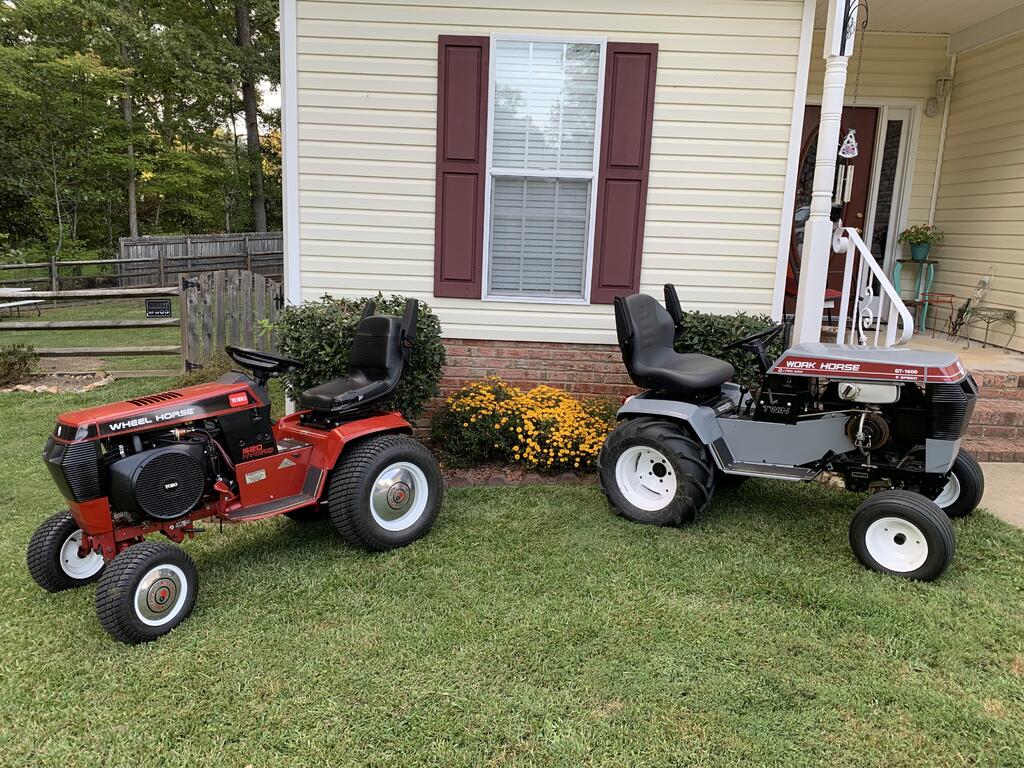

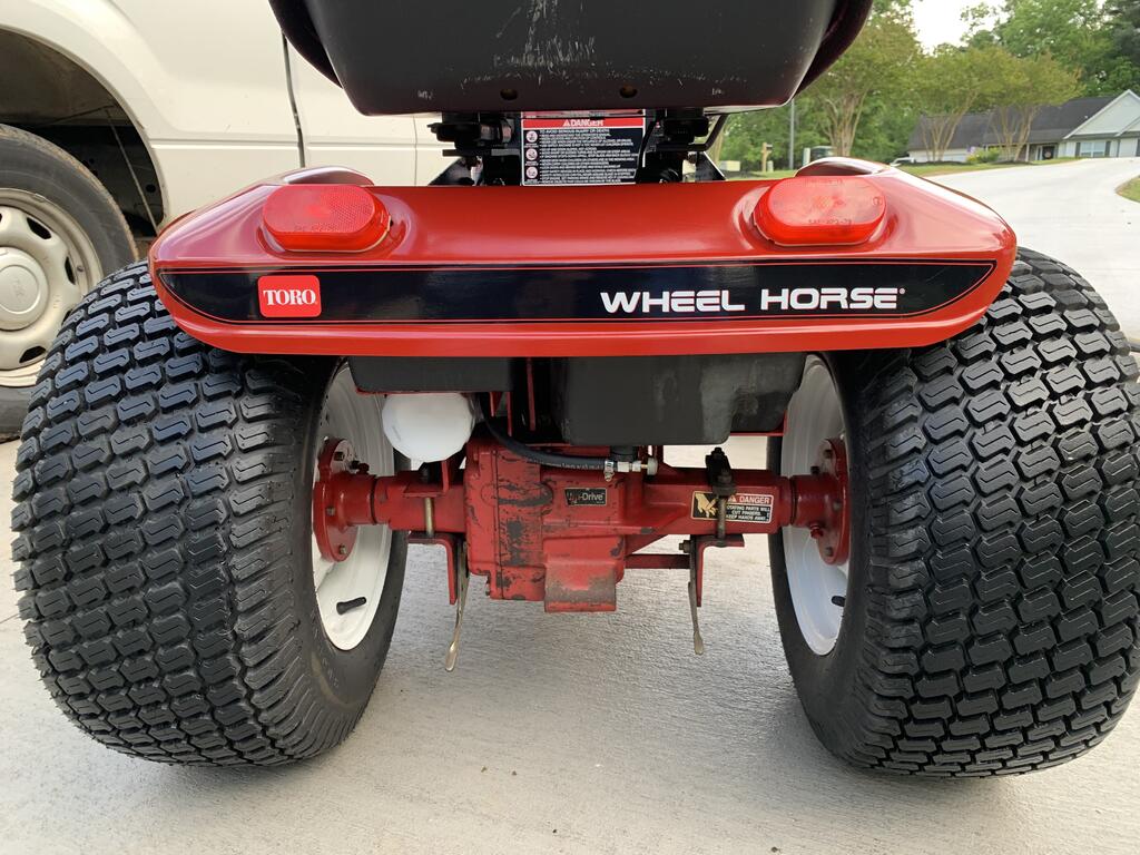

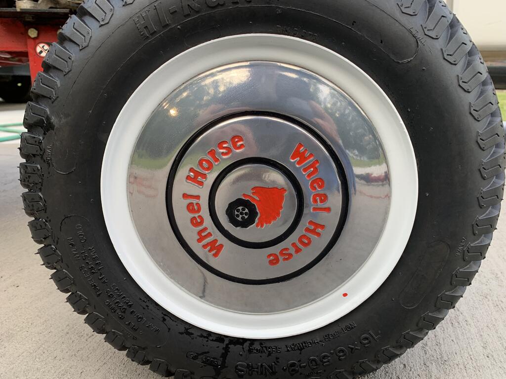

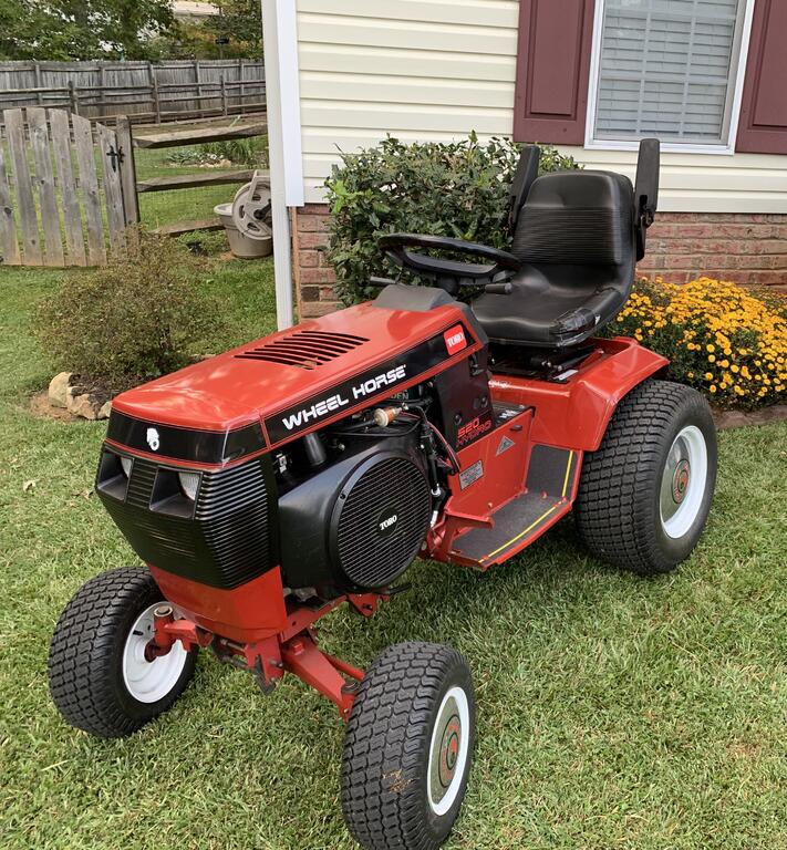

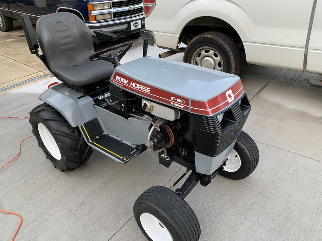

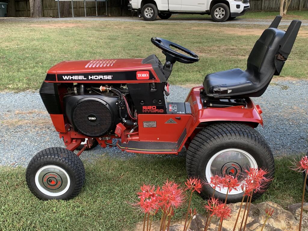

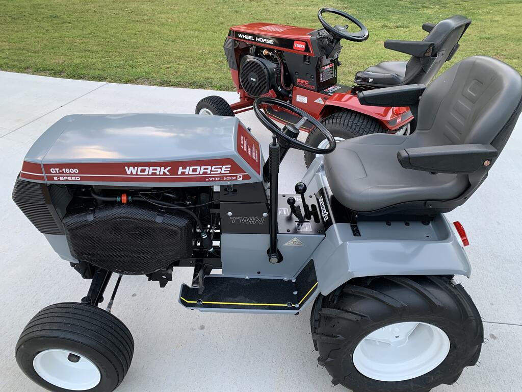

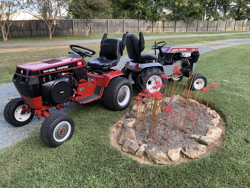

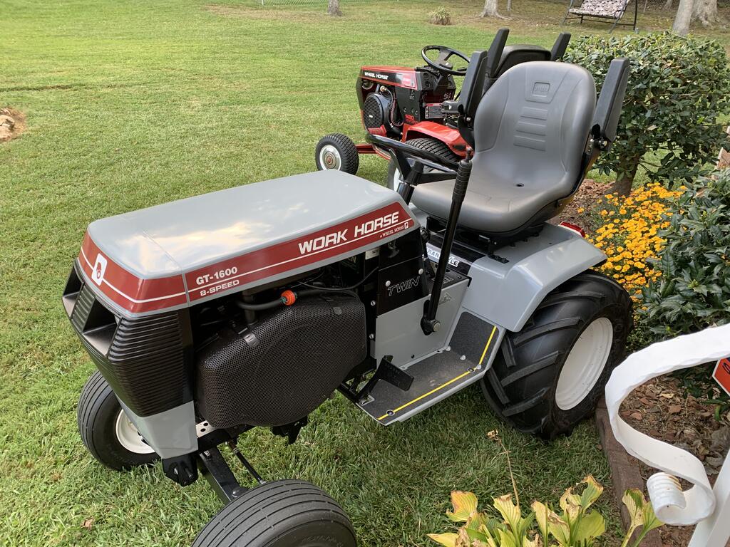

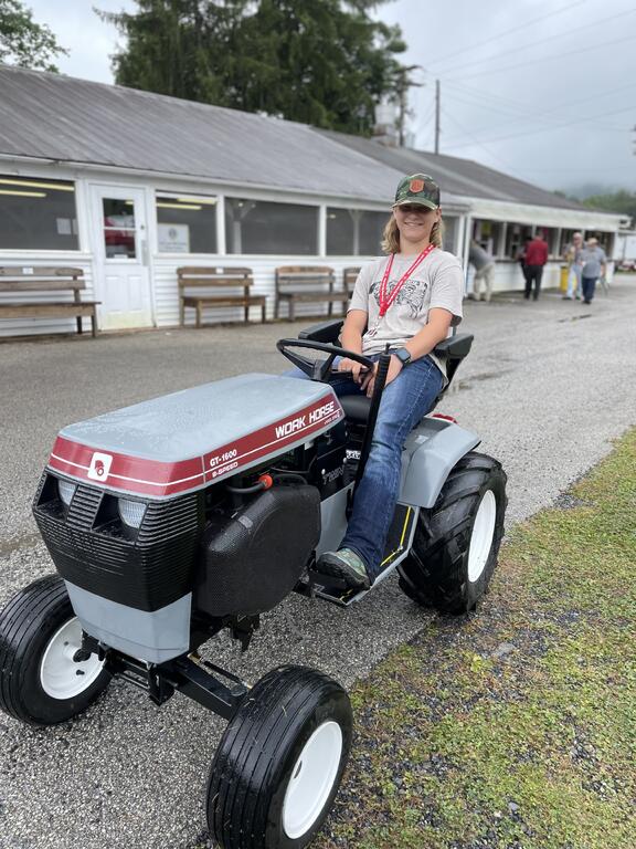

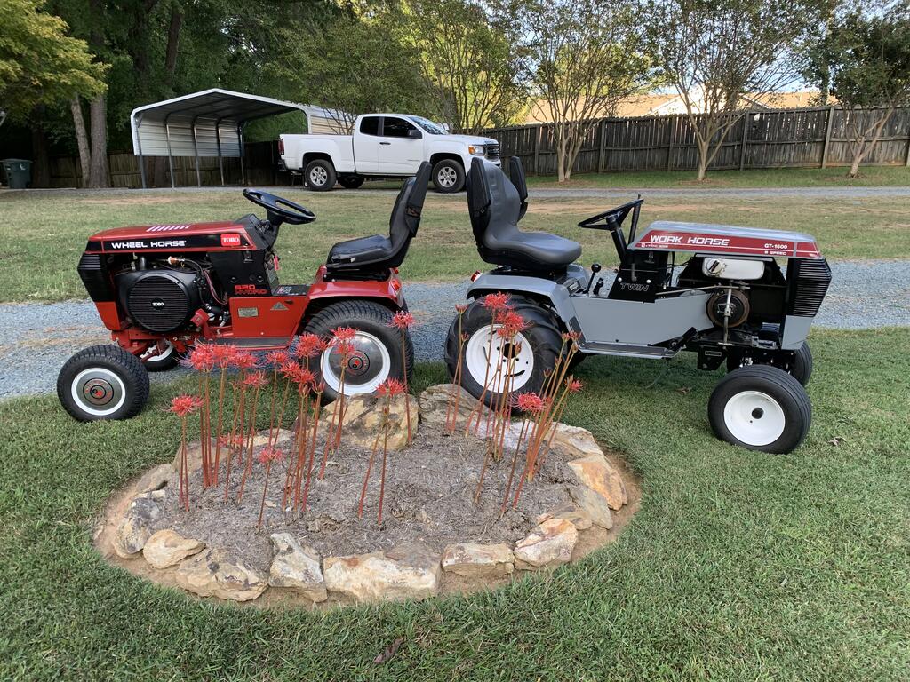

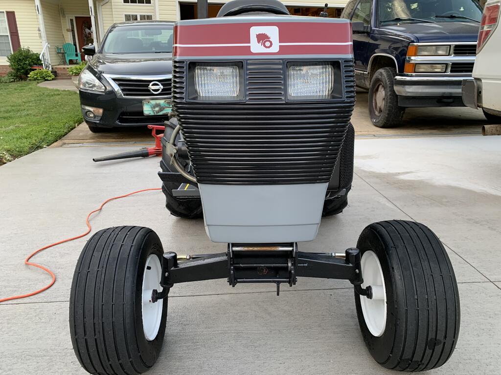

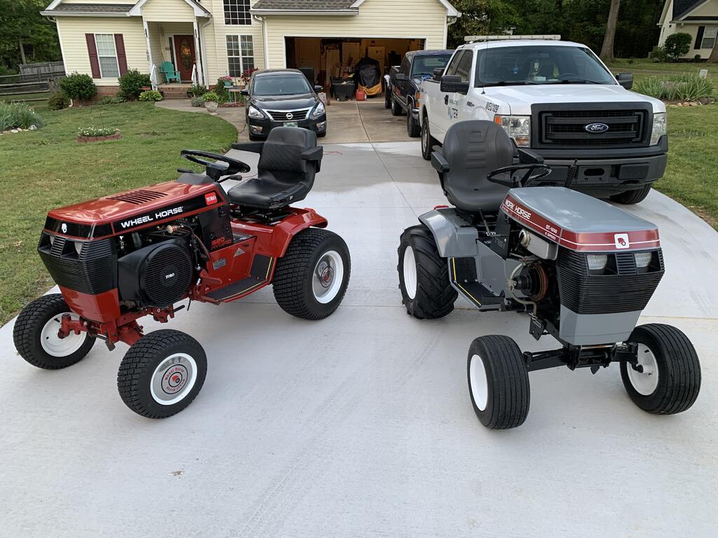

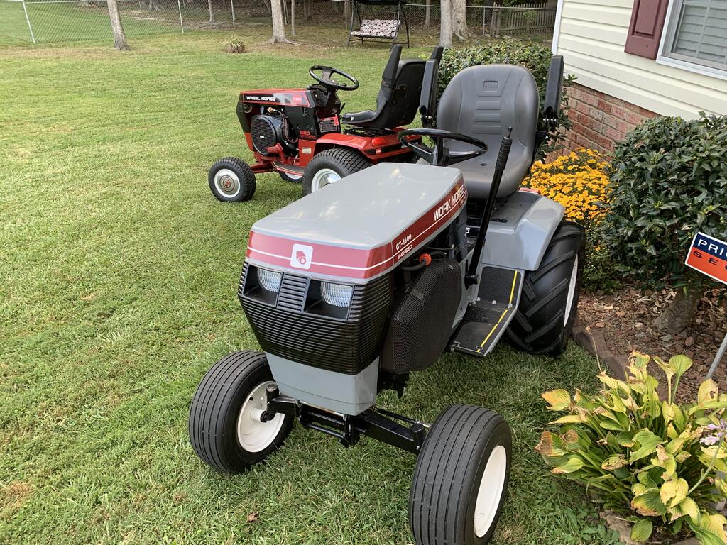

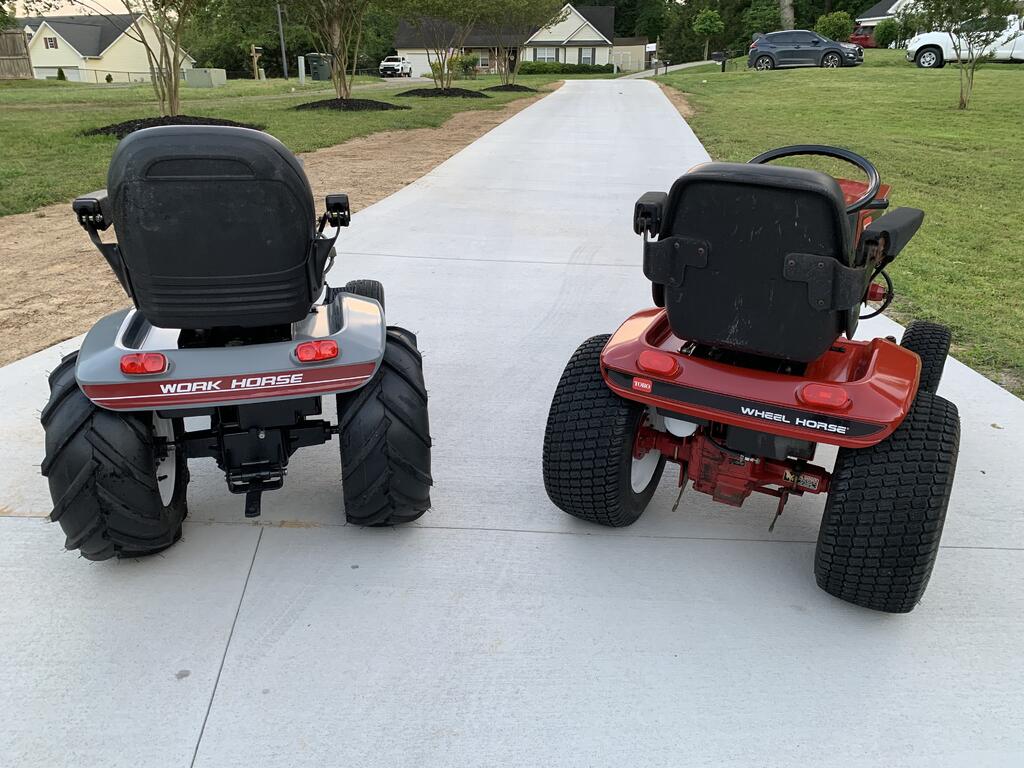

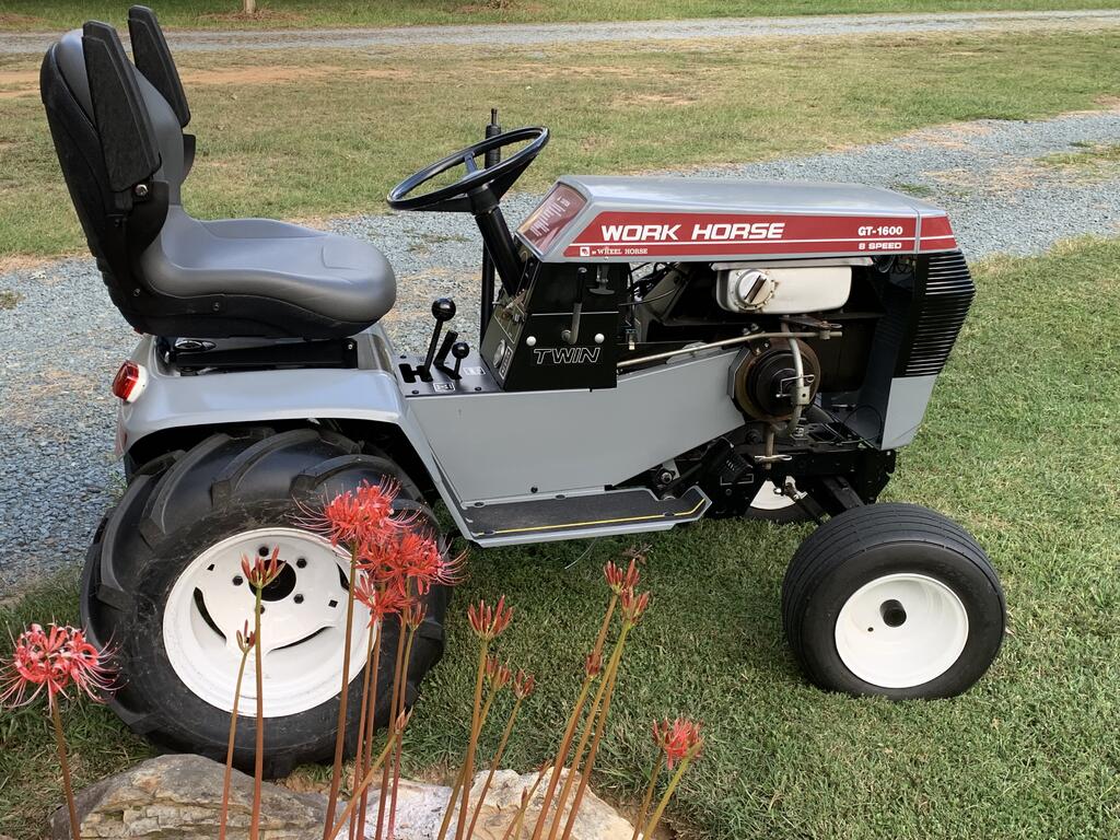

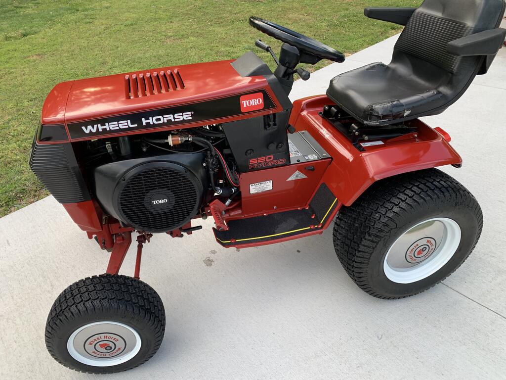

Horse Newbie 7,405 #13 Posted August 15, 2023 (edited) When I semi- restored my 1984 Work Horse GT-1600 and my 1994 520H I used Rustoleum Regal Red in a spray can on the 520H, and I believe Rustoleum Smoke Gray on the Work Horse. I did not clear coat. 1. I was going for darn good, not perfect. 2. I will be using them. They will get scratched. 3. They will get washed every so often but, they will not be left out in the weather. I think they look pretty good for a $140 520H, and a free Work Horse. I did have the wheels powder coated Gloss White… I just like white wheels. On some white works, others not… to !!! Edited August 15, 2023 by Horse Newbie 2 10 Share this post Link to post Share on other sites

Pullstart 71,281 #15 Posted August 15, 2023 8 hours ago, Horse Newbie said: When I semi- restored my 1984 Work Horse GT-1600 and my 1994 520H I used Rustoleum Regal Red in a spray can on the 520H, and I believe Rustoleum Smoke Gray on the Work Horse. I did not clear coat. 1. I was going for darn good, not perfect. 2. I will be using them. They will get scratched. 3. They will get washed every so often but, they will not be left out in the weather. I think they look pretty good for a $140 520H, and a free Work Horse. Don’t be so modest! Those machines are wonderful restorations indeed! 1 2 Share this post Link to post Share on other sites
kpinnc 18,970 #16 Posted August 15, 2023 (edited) 2 hours ago, Pullstart said: Don’t be so modest! Those machines are wonderful restorations indeed! Tim's tractors don't just look good in pictures. They look like "new" in person, and the Work Horse at least (I didn't drive the 520) drives like new too. No rattles, squeaks, nothing. The steering is tight, the clutch has no slop. Makes me think that is what a new machine was like at a dealership back in the old days. Edited August 15, 2023 by kpinnc 2 1 1 Share this post Link to post Share on other sites

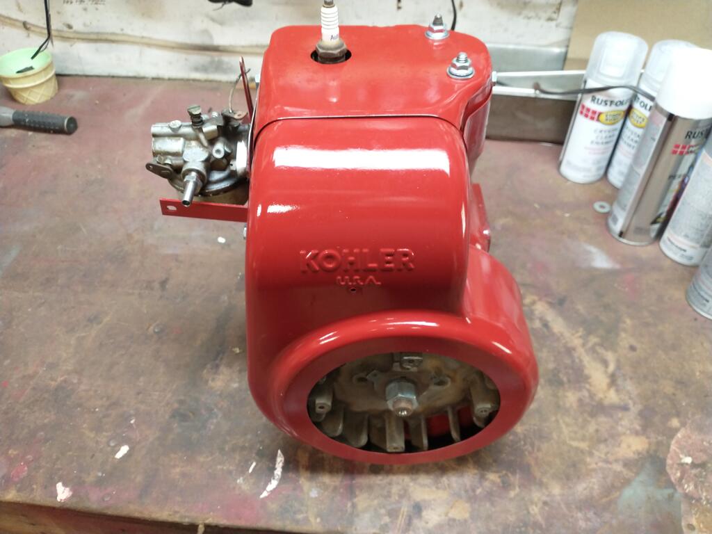

Mike_eash 59 #22 Posted August 21, 2023 On 8/14/2023 at 8:31 AM, squonk said: Since it's all ready painted, leave it. The paint will be curing for a while. I have no knowledge of the quality of the paint you used but back in the day "Farm Implement" paint was just a cheap Alkyd Enamel When you want to clear something. Spray 2-3 coats of Rustoleum Regal Red to get the coverage you want. As soon as you set the can down on your final coat, grab a can of Rustoleum Chrystal Clear enamel and spray a coat on top of the red when it's still wet. Wait 10 -15 min and spray a 2nd coat of clear and walk away. I painted this engine with that method. How does that hold up with the heat from the motor I have been trying to find engine enamel to match my international harvester red paint i used on the rest of the tractor but have had no luck on an exact match 1 Share this post Link to post Share on other sites
squonk 48,140 #23 Posted August 21, 2023 36 minutes ago, Mike_eash said: How does that hold up with the heat from the motor I have been trying to find engine enamel to match my international harvester red paint i used on the rest of the tractor but have had no luck on an exact match I did this engine 4 years ago with Rustoleum Regal Red and Clear. Still looks this good. 2 Share this post Link to post Share on other sites
Mike_eash 59 #24 Posted August 21, 2023 Wow yeah well I might just do that 1 Share this post Link to post Share on other sites
