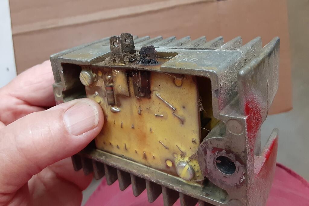

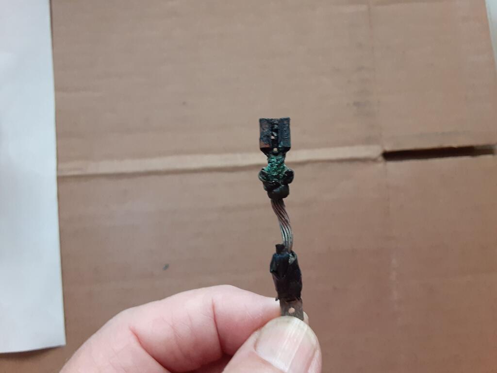

manant 57 #14 Posted August 17, 2023 I may have found the problem. I checked the resistance in the coil and it varied from one test to another. If I left the ohm meter connected the resistance degraded over time. That may have been the engine stopping problem but not the failure to crank problem. I decided to bite the bullet and order a new coil, points and condenser. While waiting for the new parts to arrive I started checking wiring grounds and continuity. Everything checked out until I got to the rectifier. I had replaced it with a used Ebay item some time ago. I find that the stator leads are just barely long enough to reach the rectifier so I made 2" pigtails to lengthen the leads so I could wire it from the seat side of the console. The photo below shows one of the pigtails I removed yesterday. The female connector was fried and the insulation melted. The other photo shows one AC spade connector on the rectifier, and it had corroded away, or melted and the rectifier also fried. What would fry these components? I read somewhere that you need to disconnect the rectifier if you jump start the tractor. I ordered a new one and await its arrival. I hope that solves my other problem. 3 Share this post Link to post Share on other sites
ebinmaine 81,284 #15 Posted August 17, 2023 2 minutes ago, manant said: read somewhere that you need to disconnect the rectifier if you jump start the tractor. I've not heard that about a Wheelhorse and have never done it. Also never had a problem. 2 minutes ago, manant said: What would fry these components? Pure age can damage or kill a VR. Yours clearly has a bad ground. The overspray is the indicator. When I build a new wiring harness I add several more grounds. VR is always one. Run a ground from one of the mounting bolts to the Battery Negative directly. Very nice work finding the issue! 1 1 Share this post Link to post Share on other sites
manant 57 #16 Posted August 17, 2023 Thanks for your input. I did run a ground wire from the rectifier mounting bolt to a bolt on the frame, but not to the battery post. When I install the new rectifier I will run a ground wire to the battery. 3 Share this post Link to post Share on other sites
ebinmaine 81,284 #17 Posted August 17, 2023 2 minutes ago, manant said: Thanks for your input. I did run a ground wire from the rectifier mounting bolt to a bolt on the frame, but not to the battery post. When I install the new rectifier I will run a ground wire to the battery. We've done a half dozen or more either complete or mechanical restorations here. One of the things I've noticed failing across the board is ground. These are DC systems. No ground is ... No circuit. I now run individual ground wires from every major component and circuit. Engine. VR. Gauges. Front and/or rear lights. All connected to the Battery directly. 1 Share this post Link to post Share on other sites

Handy Don 17,737 #20 Posted August 18, 2023 5 hours ago, manant said: My immediate take on this was a poor connection that, given the current passing through it, heated up dramatically and failed. I’d suspect moisture/corrosion as the cause of the poor connection. 3 Share this post Link to post Share on other sites
