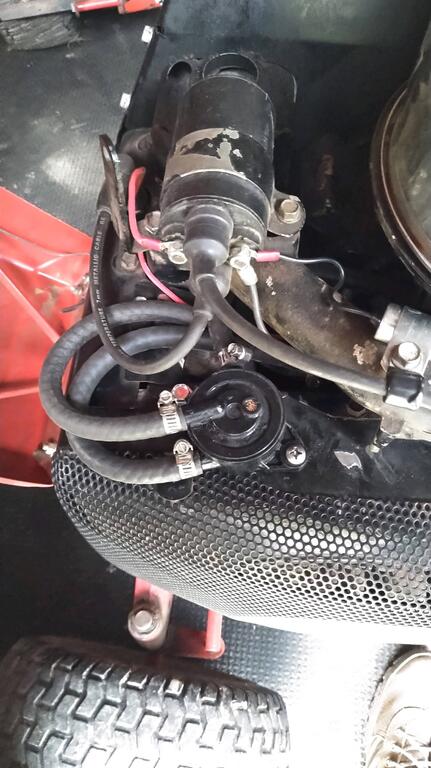

Bill D 3,213 #11 Posted August 12, 2023 I've been converting all my equipment to impulse pumps. Here's one on my KT 17. 1 1 Share this post Link to post Share on other sites
pacer 3,181 #12 Posted August 12, 2023 Another vote for the Carbole one, After 3 fails on the other type made me a believer.... 2 Share this post Link to post Share on other sites
RED-Z06 2,720 #13 Posted August 12, 2023 1 hour ago, Bill D said: I've been converting all my equipment to impulse pumps. Here's one on my KT 17. Most of my stuff runs impulse or the kohler mechanicals, really do like them and usually go 15-20 years between replacing them. My Toro Z has a weird setup where the 2 6gal tanks are completely below the carb, and the tanks are balanced...in that they share a cross feed hose which Tee's off to the pump, so its feeding off both tanks all the time with no valve and no reserve. The impulse pump which is factory 2005 as far as i know, had gas at the carb from bone dry in about 6 seconds of cranking...hard to beat that. Share this post Link to post Share on other sites
