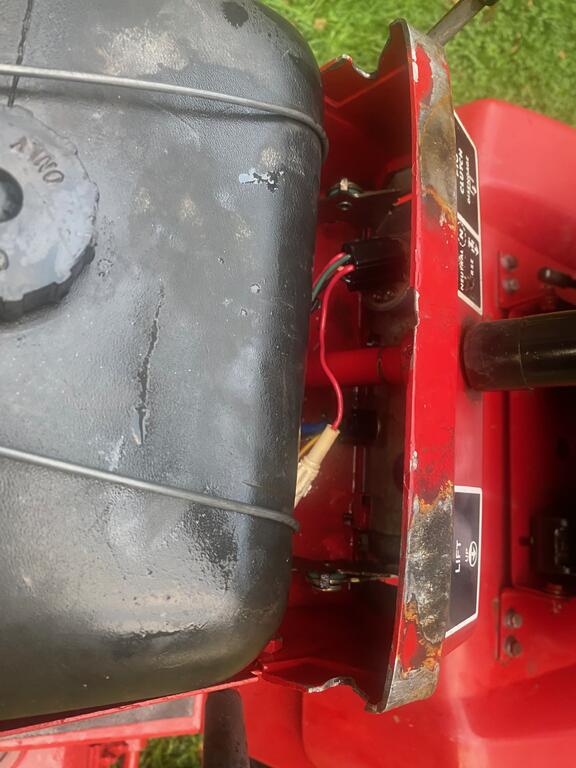

TonyBer 79 #1 Posted August 11, 2023 Any advice/help here would be appreciated. Recently acquired another C-160 with some nice patina. It was completely gone over and running great and took some degreaser and hose to some remnants of come critter nests behind the gas tank and then cleaned up some grease around the motor. I covered the spark plug on top. Now I have nothing when I turn the key. What did I get wet that I shouldn't have? I sprayed the ignition plug behind the key with WD-40 but it definitely got wet. Did screw something up or do I just let it dry? Thanks in advance! Share this post Link to post Share on other sites
