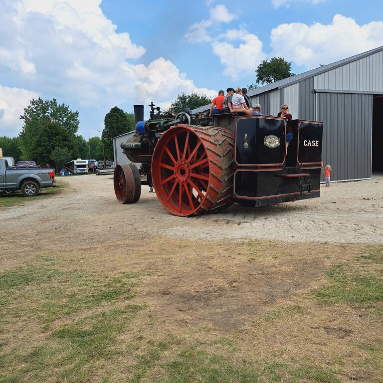

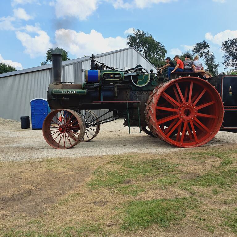

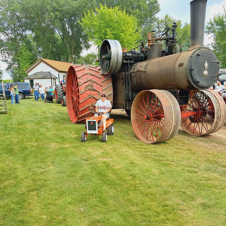

WHX?? 58,388 #1 Posted August 6, 2023 (edited) Always a fav show of mine and this year no different. I joined last year as a member of the club and did abit of work on the grounds. Next year maybe abit more as I ease into it. This year they had the BIG 150 Case brought in. More on the history of it later but they lay claim to the biggest steamer in North America. Lots of it on FB for you FBers. So story has it ther was none remaining out of nine or so built but a privateer copied a remaining boiler. Got the orginal drawings from Case and built one in his garage. Well maybe not his garage but had to buy a machine shop and a foundry to build it. @Wild Bill 633 help me out here on the factuals. More show pics to follow... Club says about 4000 to come in through the gate all weekend on an average show... this year hopefully 4-5000 a day for Case feature. Edited August 7, 2023 by WHX?? Add 4 8 1 Share this post Link to post Share on other sites

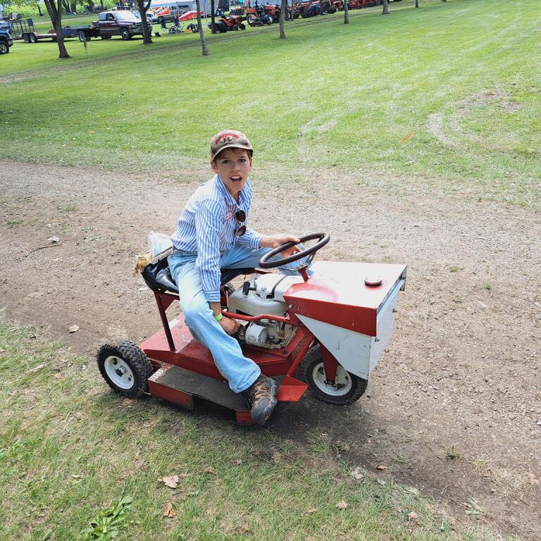

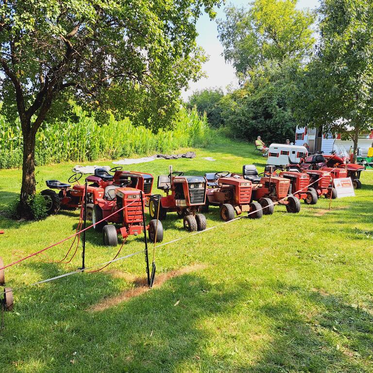

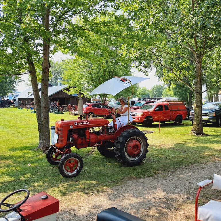

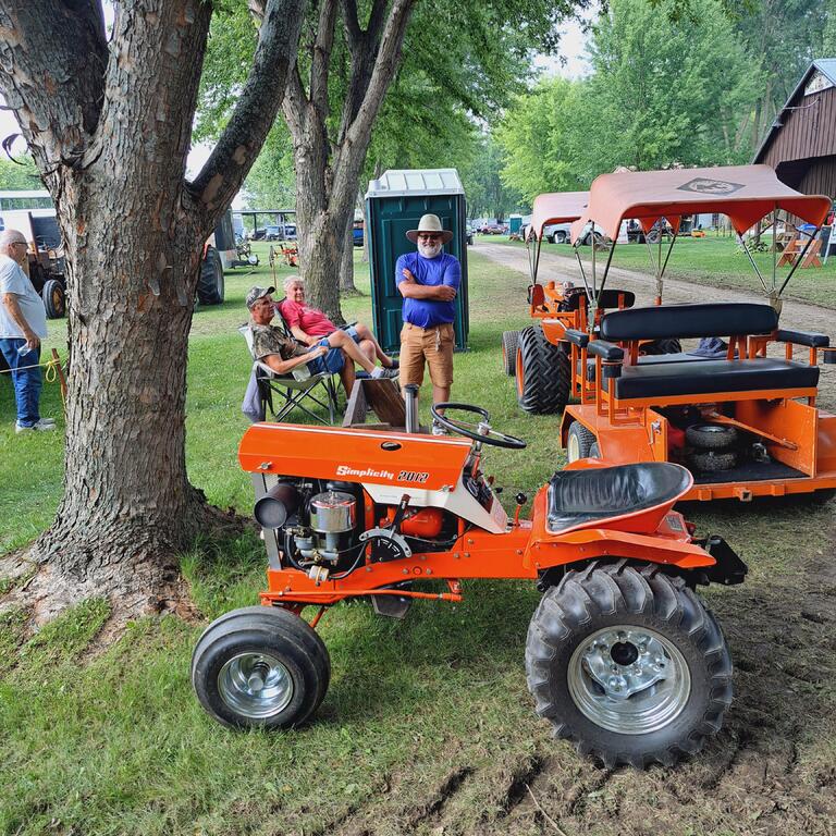

WHX?? 58,388 #4 Posted August 7, 2023 (edited) More show pics... EB might like this first one... Wild Bill with his ride around Simplecity Edited August 7, 2023 by WHX?? 5 8 Share this post Link to post Share on other sites

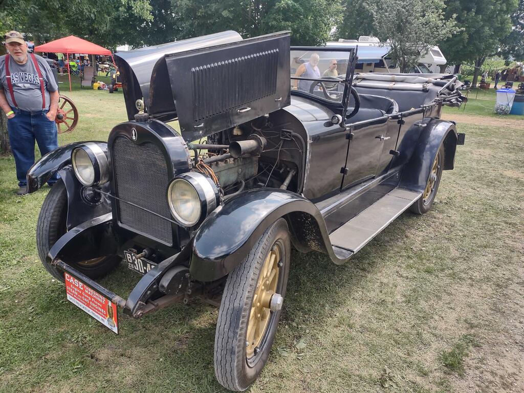

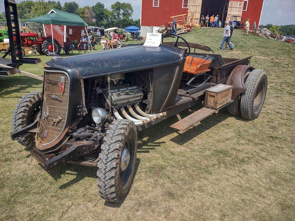

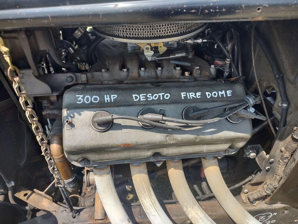

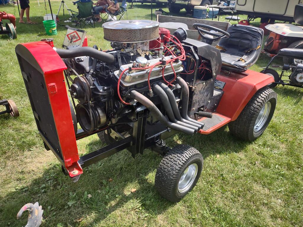

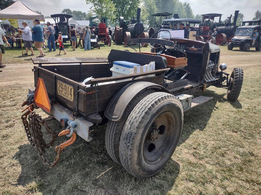

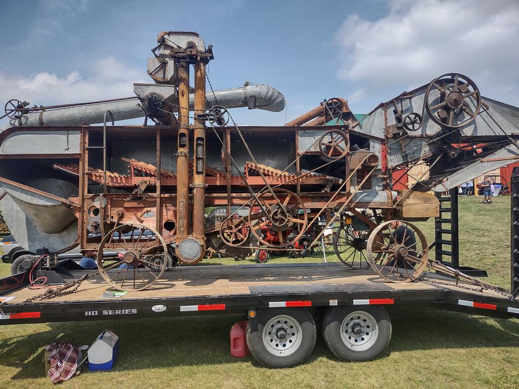

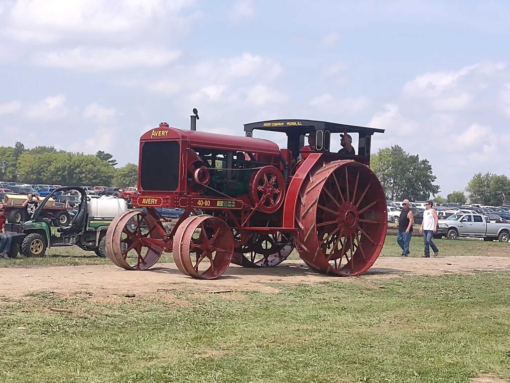

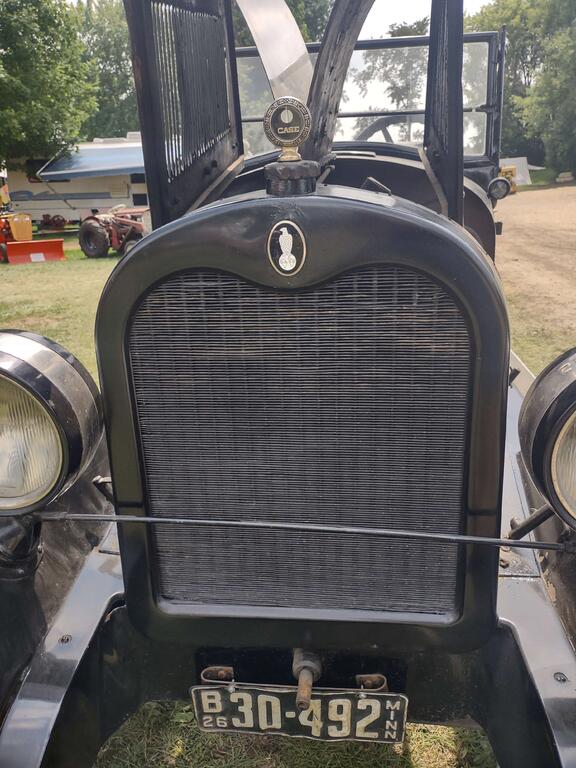

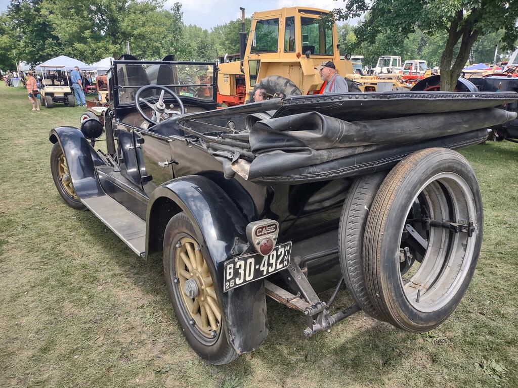

Achto 32,964 #5 Posted August 7, 2023 (edited) I'll throw a few of my pic's up. First up this little Avery. This Rat Rod / doodle bug was quite interesting. Really liked the rare engine that was used in it. A great cut away display of a threshing machine. It was powered by small gas engine for slow speed movement. Another builder reaching for the extreme. There were a lot of really nice Case displays. One that caught my eye was this Case automobile. A pic of the 150hp Case steam traction engine hooked on to an eliminator. Edited August 7, 2023 by Achto 5 8 Share this post Link to post Share on other sites
8ntruck 9,420 #6 Posted August 7, 2023 Was that 150 Case the one that was plowing with a 28 bottom plow while back? 1 Share this post Link to post Share on other sites
WHX?? 58,388 #7 Posted August 7, 2023 4 minutes ago, Achto said: First up this little Avery. Little? 1 Share this post Link to post Share on other sites
WHX?? 58,388 #8 Posted August 7, 2023 Just now, 8ntruck said: Was that 150 Case the one that was plowing with a 28 bottom plow while back? Come again? 50 bottom... Share this post Link to post Share on other sites
8ntruck 9,420 #9 Posted August 7, 2023 34 minutes ago, WHX?? said: Come again? 50 bottom... Ok, ok. 50. I was working from memory, which is nowhere as dependable as it used to be. 4 Share this post Link to post Share on other sites

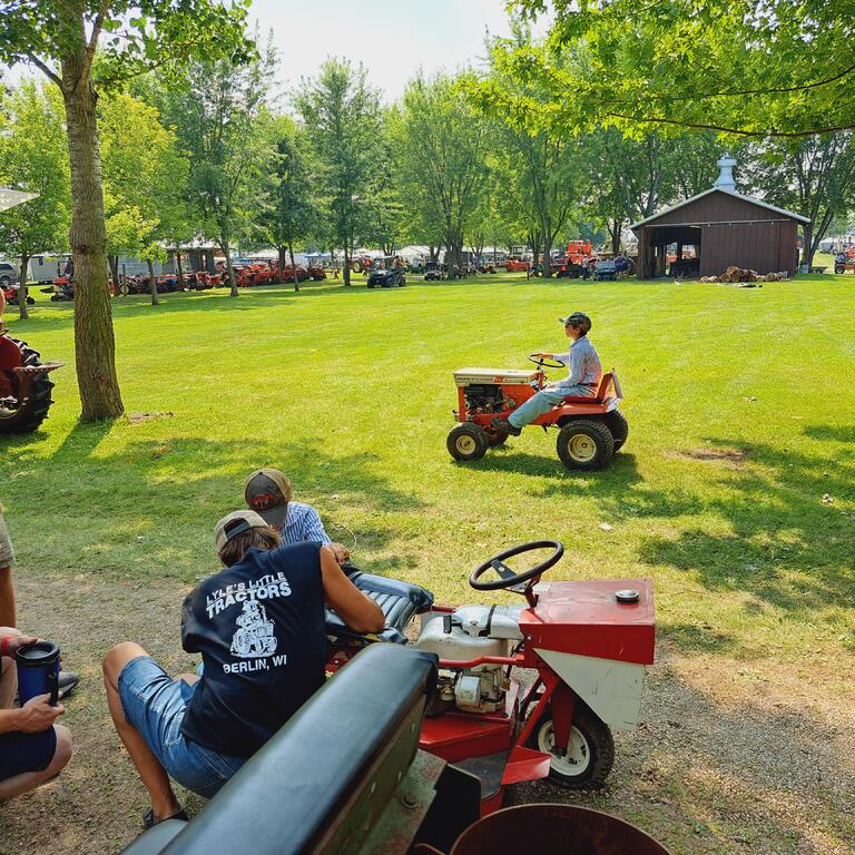

WHX?? 58,388 #10 Posted August 7, 2023 Just some off the cuff ride around shots. 5 5 1 Share this post Link to post Share on other sites

Achto 32,964 #12 Posted August 7, 2023 (edited) 47 minutes ago, SylvanLakeWH said: So what your sayin' is yes, it could "probably" handle a 60" WH deck... The 14" bore by 14" stroke produces 150hp and 5000 yes 5000 ft lbs of torque, I'm quite sure it would not even know that 60" deck was attached to it. Bad part might be that the deck would not extend out past the rear wheel, or the front wheels for that matter. BTW at 5000 ft lbs of torque, this gives the Case 150hp steam tractor the highest factory torque rating of any tractor ever produced to date. Edited August 7, 2023 by Achto 2 2 1 2 Share this post Link to post Share on other sites
8ntruck 9,420 #13 Posted August 7, 2023 That 5000 lb ft of torque is also delivered at ZERO rpm. 1 Share this post Link to post Share on other sites

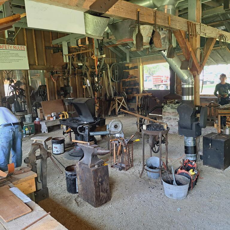

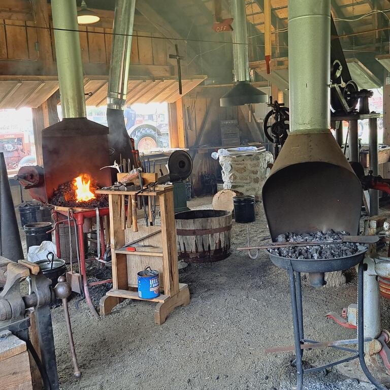

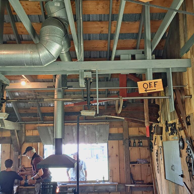

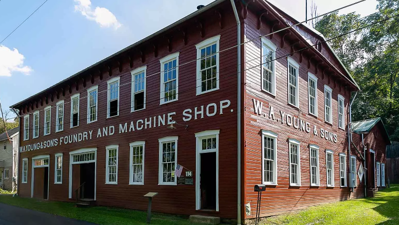

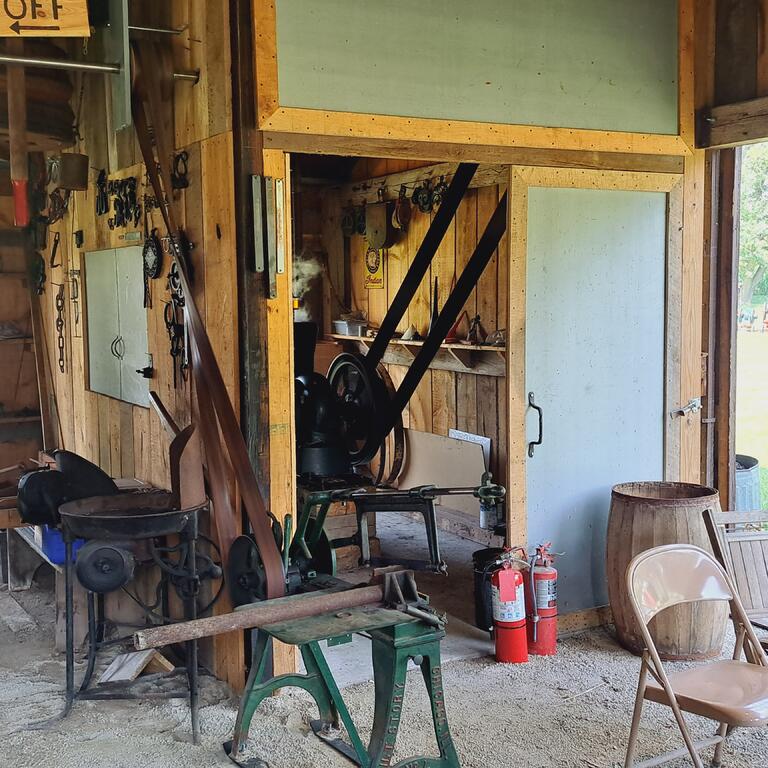

JoeM 10,318 #14 Posted August 7, 2023 Nice show! Got to put that on bucket list. The local steam show is this coming weekend. They got 100 acres and tear up about half with old equipment. I plan to make it out and if I remember to get pics. http://nationalpike.com/index.html That old hemi brought back memories. My Dad and Uncle re-ringed one in the backyard when I was about 7, one spark of my interest in mechanical things. Those belt driven shops are cool. I was good friends with the caretakers son of the local one about a mile away. Those private visits were nice got to mess around a bit with the blacksmith stuff. This one was built around 1900 and shutdown in 1965. Owners just locked the doors and left. It is like stepping back in time. Lots of hard work in those places. https://riversofsteel.com/experiences/tours/machine-shop-tour/ 4 3 1 Share this post Link to post Share on other sites

ebinmaine 81,286 #16 Posted August 7, 2023 9 hours ago, WHX?? said: EB might like this first one... Yepp. He do. Appreciate that Jim!! Share this post Link to post Share on other sites

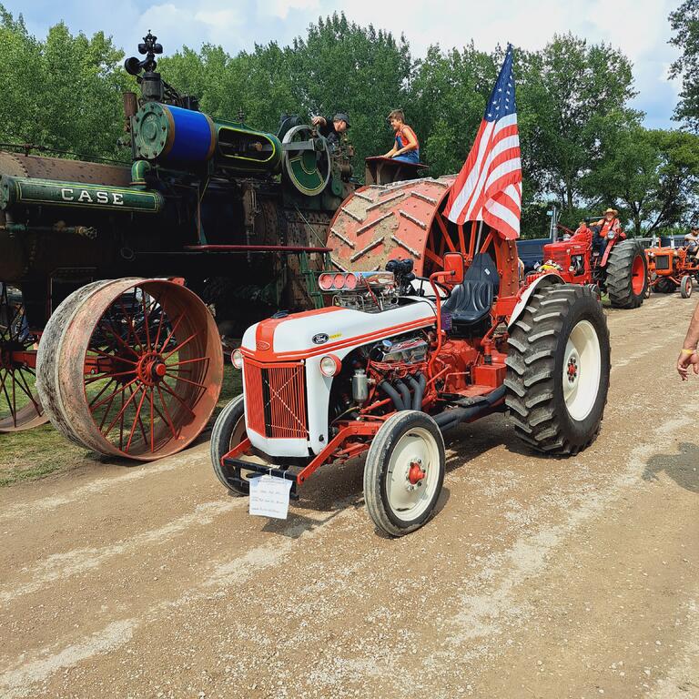

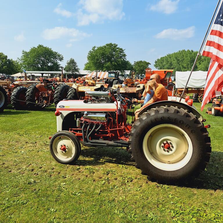

squonk 48,429 #18 Posted August 7, 2023 All that work and he kept that seat? 5 Share this post Link to post Share on other sites
WHX?? 58,388 #19 Posted August 7, 2023 (edited) Wanted to stay orginal... Funny after the band Saturday nite it was parked in the middle of the road... he ran out of ⛽️! Edited August 7, 2023 by WHX?? 1 2 Share this post Link to post Share on other sites
Handy Don 17,737 #20 Posted August 7, 2023 8 minutes ago, squonk said: All that work and he kept that seat? Good point. And how did they turn the drive to transverse? Share this post Link to post Share on other sites
WHX?? 58,388 #21 Posted August 7, 2023 1 minute ago, Handy Don said: Good point. And how did they turn the drive to transverse? Didn't look at it close enough. Maybe Dan did? Share this post Link to post Share on other sites
Achto 32,964 #22 Posted August 7, 2023 26 minutes ago, WHX?? said: Maybe Dan did? Nope didn't get a good look at that. Appreciated the concept, kinda fell short on the finish work though. 3 Share this post Link to post Share on other sites
Wild Bill 633 943 #23 Posted August 8, 2023 I attended the banquet on Saturday night and Kory Anderson had an hour presentation with Q&A after. There were (7) 150 Case Road Locomotives built in the early 1900's and none of them survived. The issue was the engine produced so much torque that the drivetrain failed. Cast iron was the material used for the gears, which is brittle, and the loads were to much for the gears. Also, the centerlines of the crankshaft, intermediate shaft and differential shaft were not in line causing side loading and another failure point. Ductile iron was discovered in 1943, which is more suitable for this application. Kory was able to get a copy of the blueprints of the 150 Case from Case and created CAD solid models of the parts. The CAD models were used to perform FMEA (load/stress) analysis and create CNC patterns. The 110 HP Case was manufactured after the 150 and Case changed the design of the shafts to be in line to eliminate the side loading. Kory changed the design of the shafts on the 150 to be in line and used ductile iron which eliminated the failures of the original 150. It took Kory 18 months to build the 150. 3 4 3 Share this post Link to post Share on other sites
wallfish 20,744 #24 Posted August 8, 2023 On 8/7/2023 at 5:48 AM, Joey Small Block said: wallfish you been hanging around out there?. Man would I love to get into that doodle bug hobby. Wish I had the room and a big garage! There's always some creative things going on with those. 3 Share this post Link to post Share on other sites
