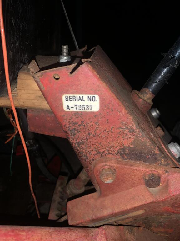

Max Ryan 2 #1 Posted August 6, 2023 My wheelhorse has a serial number of A-72537 i know it’s either a 633 or 753 but I want to know whitch one it is. Thanks 2 Share this post Link to post Share on other sites

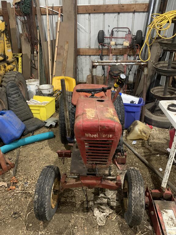

Pullstart 68,848 #2 Posted August 6, 2023 It looks like that hood stand is pretty cut up? Any other pictures of the entire machine? 1 Share this post Link to post Share on other sites
gwest_ca-(File Mod) 11,992 #3 Posted August 6, 2023 The A-xxxx serial numbers were first used in 1962 for attachments and the tractors used a 62-xxxx serial. The serial tags left over from 1962 got used on the following years until they were used up. In 1964 the last of the A-xxxxx attachment tags got applied to tractors. Click on the tractor in the link to see what has surfaced. 2 2 Share this post Link to post Share on other sites
ri702bill 11,242 #5 Posted August 6, 2023 .... not a 753, the hoodstand is all wrong. A 633 - maybe. Share this post Link to post Share on other sites
953 nut 64,072 #6 Posted August 6, 2023 11 hours ago, Max Ryan said: i know it’s either a 633 or 753 I agree with @gwest_ca that yours is a 1964 model,the engine information will determine what the model number should be. The only thing that is important is that you enjoy having it. Share this post Link to post Share on other sites
squonk 45,473 #7 Posted August 6, 2023 If it is a 64 the remains of the control knobs on the dash say it / was a 604/704 Share this post Link to post Share on other sites
gwest_ca-(File Mod) 11,992 #8 Posted August 6, 2023 Hopefully this link will take you to all the 1964 tractors. If you see a SN in caps we have some serial numbers. Click on the title to see them. See the A-xxxx serial was also used on some early Lawn Rangers. https://www.wheelhorseforum.com/search/?&q="tractor 1964"&type=downloads_file&search_and_or=or&sortby=relevancy 1 Share this post Link to post Share on other sites

Max Ryan 2 #10 Posted August 6, 2023 6 hours ago, ri702bill said: .... not a 753, the hoodstand is all wrong. A 633 - maybe. What is the hood stand, mine was changed because the person before me put a snowmobile engine on it. I put an 8hp Briggs on it but I just don’t know whitch one it is. Share this post Link to post Share on other sites
Max Ryan 2 #11 Posted August 6, 2023 5 hours ago, squonk said: If it is a 64 the remains of the control knobs on the dash say it / was a 604/704 The knobs are on the hood, so I believe it’s a 64 but the 633 and 753 are very similar besides the engine and with the little info I have on the tractor I can’t figure it out Share this post Link to post Share on other sites

Max Ryan 2 #13 Posted August 6, 2023 5 hours ago, squonk said: If it is a 64 the remains of the control knobs on the dash say it / was a 604/704 I have a choke on the dash but holes on the hood for some other controls Share this post Link to post Share on other sites
Max Ryan 2 #14 Posted August 6, 2023 16 hours ago, Pullstart said: It looks like that hood stand is pretty cut up? Any other pictures of the entire machine? It is cut up, I didn’t do it the people before me did it Share this post Link to post Share on other sites
