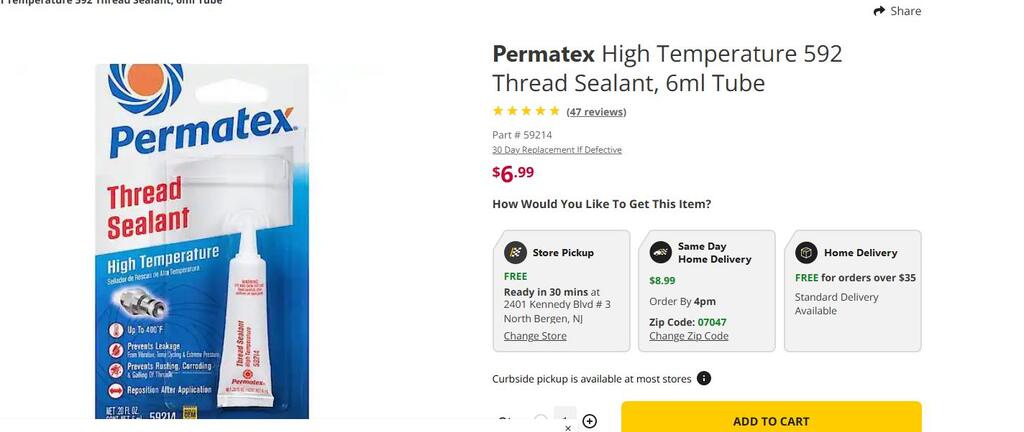

pfrederi 21,215 #4 Posted August 2, 2023 I have used this stuff for years works on gasoline fittings also... 2 Share this post Link to post Share on other sites
