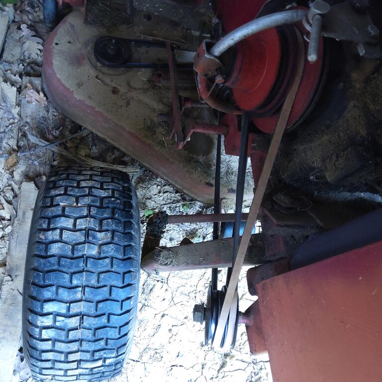

Turf Racer 6 #1 Posted August 1, 2023 Hi everyone ! ... I have just realised that my 36 inch deck is turning in the wrong direction wrt the blades (107435 etc ) so for some time i must of been cutting or smashing the grass with the back of the blades ...? 🤣😂🤣 This is very amusing to me as i have been using my wrecked c105 for 12 years now ... I JUST CANT BELIEVE IT 🤗🤣😂🤣 . The deck belt is fitted correctly ... Looking down onto the deck axis the belt turns the wheels in an anti clockwise direction , which means that the blades when viewed from the ground upwards to the deck are turning in a clockwise direction which is the opposite direction needed for the blades ? ... Looking from the ground upwards the blades are fitted with the higher lift parts upwards towards the underside of the deck (part nos are downwards) which i believe is correct ? . I recently replaced the deck belt and pto belt . What have i done put the pto belt on wrong ? Any ideas how i achieved this ? Share this post Link to post Share on other sites

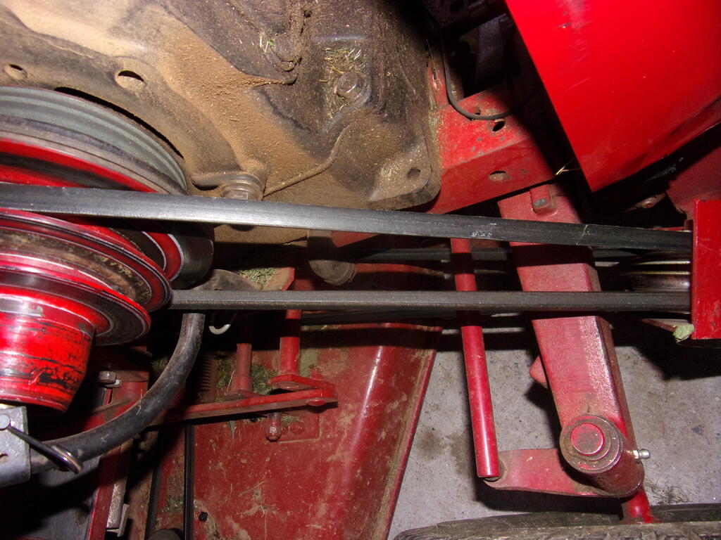

squonk 48,215 #3 Posted August 1, 2023 Or you twisted the PTO belt around the engine pulley backwards. 1 Share this post Link to post Share on other sites
Ed Kennell 47,596 #4 Posted August 1, 2023 to the Yes, the blades must turn CCW viewed from the bottom. If yours are turning CW, you must have a twist in the belt between the PTO and the deck drive pulley. 2 1 Share this post Link to post Share on other sites

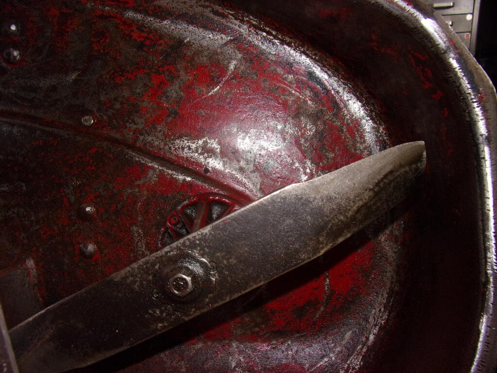

Turf Racer 6 #7 Posted August 1, 2023 Thanks for the welcome everyone ...ive been here before just changed id etc ... Nice one Éd it sure looks twisted to me ... Thank you sir ill go and try it now ... Wh is sure to take off now .. I know its dirty just been recently flooded and the deck had a mud bath . Hey Ed (in your photos) how do you squeeze the life outa those blades they must be a few inches shorter does your shape work well ? .... HI & Thanks everyone Reverse direction Might come in handy for trapping môles without the blood 🤣😂🤣😂 2 Share this post Link to post Share on other sites

Ed Kennell 47,596 #9 Posted August 1, 2023 49 minutes ago, Turf Racer said: they must be a few inches shorter This is a 42" rear discharge deck and the blades are the correct length. Some length is lost after several sharpening, but they still cut OK. Share this post Link to post Share on other sites

Rick3478 470 #11 Posted August 1, 2023 1 hour ago, Turf Racer said: 🤣😂🤣😂 1 hour ago, Turf Racer said: There's a fairly easy way to get the PTO belt on wrong with a half twist, but it looks like you managed to find an alternate way to do it with a full twist. But before awarding you a medal for that, I notice a couple other things in the photo. The trunnion that links the PTO hoop to the thrust shaft appears to be upside-down, and the engagement rod seems to be coming out at an odd angle. I can't see enough of the rod to tell what happened there, but this whole setup might bear some re-evaluation. 1 1 Share this post Link to post Share on other sites

SylvanLakeWH 32,698 #14 Posted August 1, 2023 Couple shots of my C105 back when I mowed with it... No decks anymore - just snow duty... pretty far away but hope they help. Share this post Link to post Share on other sites
Turf Racer 6 #15 Posted August 1, 2023 Ok thx Sylvan pto looks like mine . My c105 is running great now and cutting like new again ! 1 2 Share this post Link to post Share on other sites
