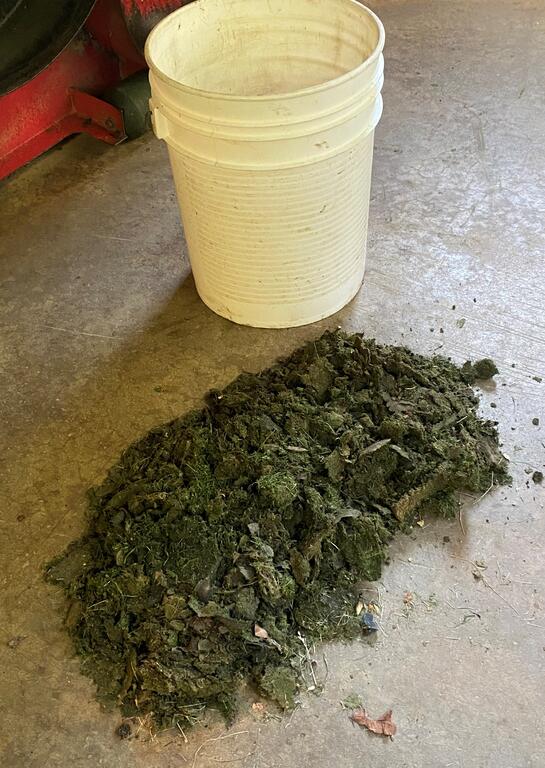

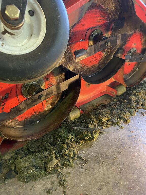

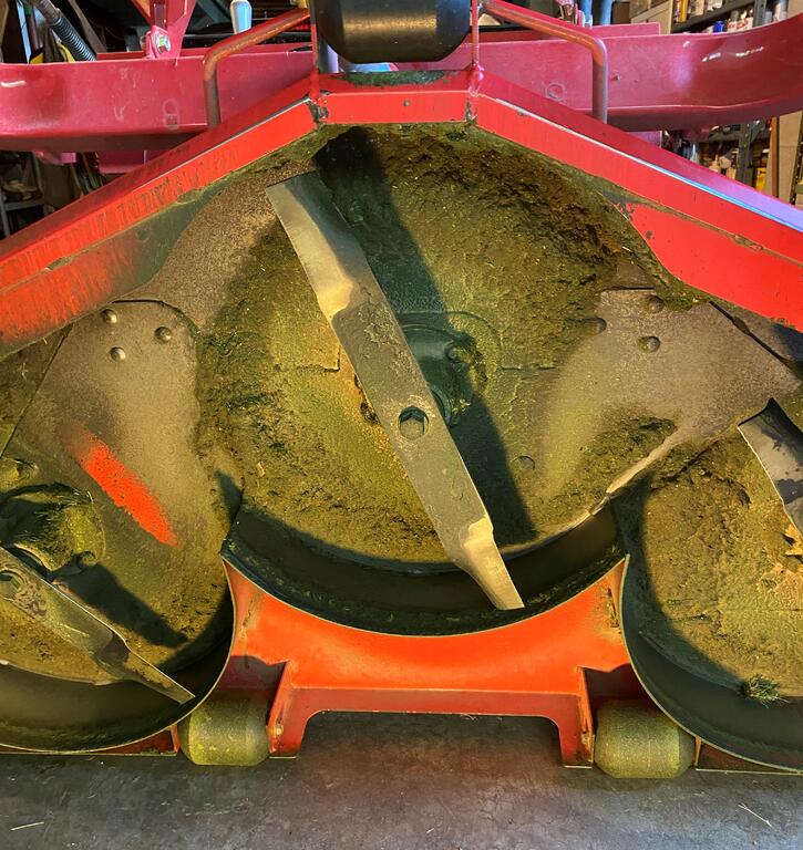

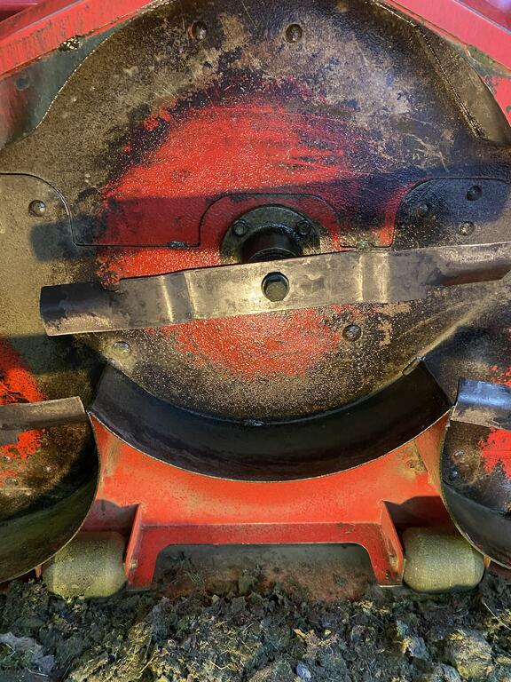

lynnmor 8,899 #1 Posted August 1, 2023 Often I read on here about various methods to stop the buildup under a mowing deck. Personally I think it can't be done. Here are photos of a 60" deck on Country Clipper zero turn that I chose for the ease of cleaning. I scrape and apply Fluid Film about every other mowing with a garden hose wash on the week I don't scrape. This mowing was really dry with enormous clouds of dust, so it can't be blamed on mowing while wet. Before scraping: Pounds of material removed and freshly sharpened blades installed: Fluid Film applied: At least half a bucket of grunge from one mowing and this is less than average: While this isn't my 60" Wheel Horse decks, the results are exactly the same. Can you imagine dragging out a 60" deck every other week to do this service? All I can say is that anyone with a real solution can come on down and show me. 1 Share this post Link to post Share on other sites
