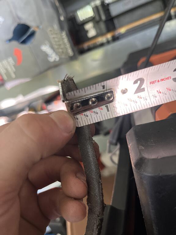

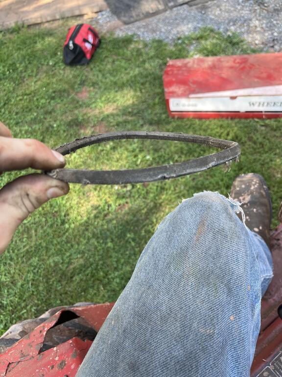

857lover 291 #1 Posted July 29, 2023 hey guys i have a d250 belt here thst snapped on me and i can’t seem to find any info on the belt to be able to get a new one looks smaller than 3/8s Share this post Link to post Share on other sites

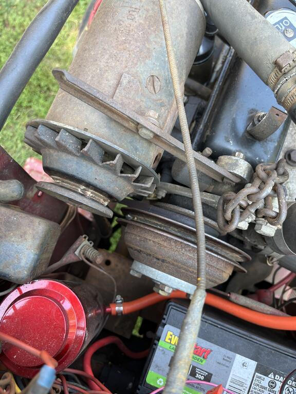

gwest_ca-(File Mod) 12,320 #3 Posted July 30, 2023 Found another belt Water pump belt 251884 - 9.5mm x 655mm - 3/8" x 25.9" - Gates replacement 6726 Suspect this one drives the water pump but tensioned by the the generator 4 Share this post Link to post Share on other sites

857lover 291 #8 Posted July 30, 2023 (edited) 10 hours ago, gwest_ca said: The Toro parts list description for the 25108 is 9.5 x 600 which is 3/8" x 23.62" so don't know where the mistake is. yea i belive it is a 3/8 x23.62 and when i lay it out on a table from one end to the other it’s about 23.5 inches Edited July 30, 2023 by 857lover Share this post Link to post Share on other sites

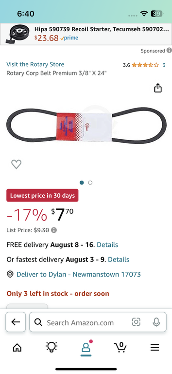

857lover 291 #9 Posted July 30, 2023 i think i’m going to try this belt Share this post Link to post Share on other sites
