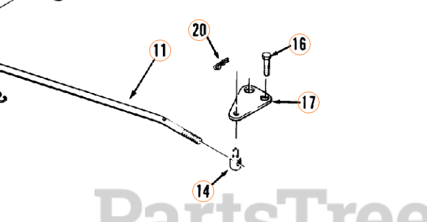

JoeM 10,317 #3 Posted July 27, 2023 If your rod is going down through try it up through, allows it to cam over just a bit more. like #14 in this pic 2 1 Share this post Link to post Share on other sites
