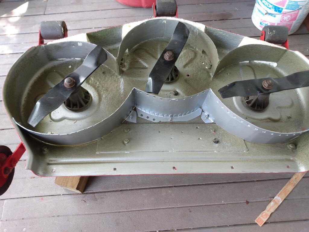

peejo50 37 #1 Posted July 25, 2023 I modified my 42" rear discharge deck into a full-on mulching deck. It mows beautifully with nearly no visible grass clippings. I have a Craftsman self propelled mulching mower that never left clippings and I thought, why not use the same principle on my Wheel Horse. Since it was a rear discharge it already had the arched blade areas sectioned off in front. What I did was to fabricate arched panels to mimic the front. The original blades were 14&3/8”. The closest replacement mulching blades were Stens 325-302 which are 14&1/2”. Because of the slightly larger size, I trimmed 3/8” off both ends of the center blade and rebalamced it. Adding the set of mulching blades and modifications, and my mulching deck was born. 2 9 Share this post Link to post Share on other sites
