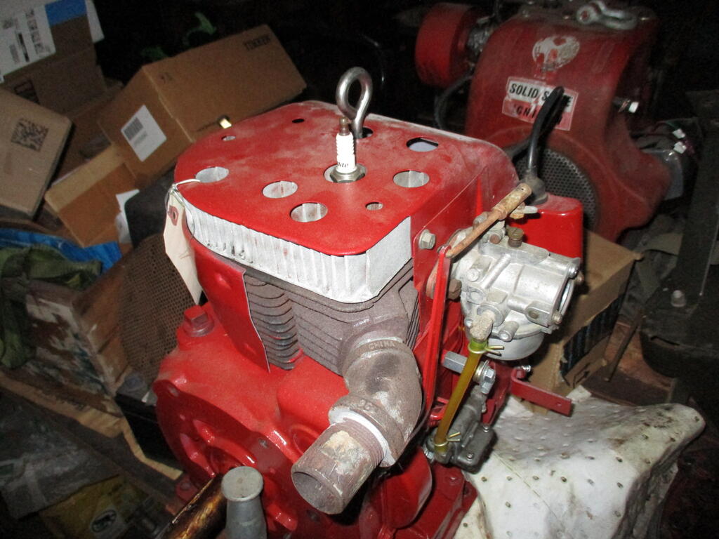

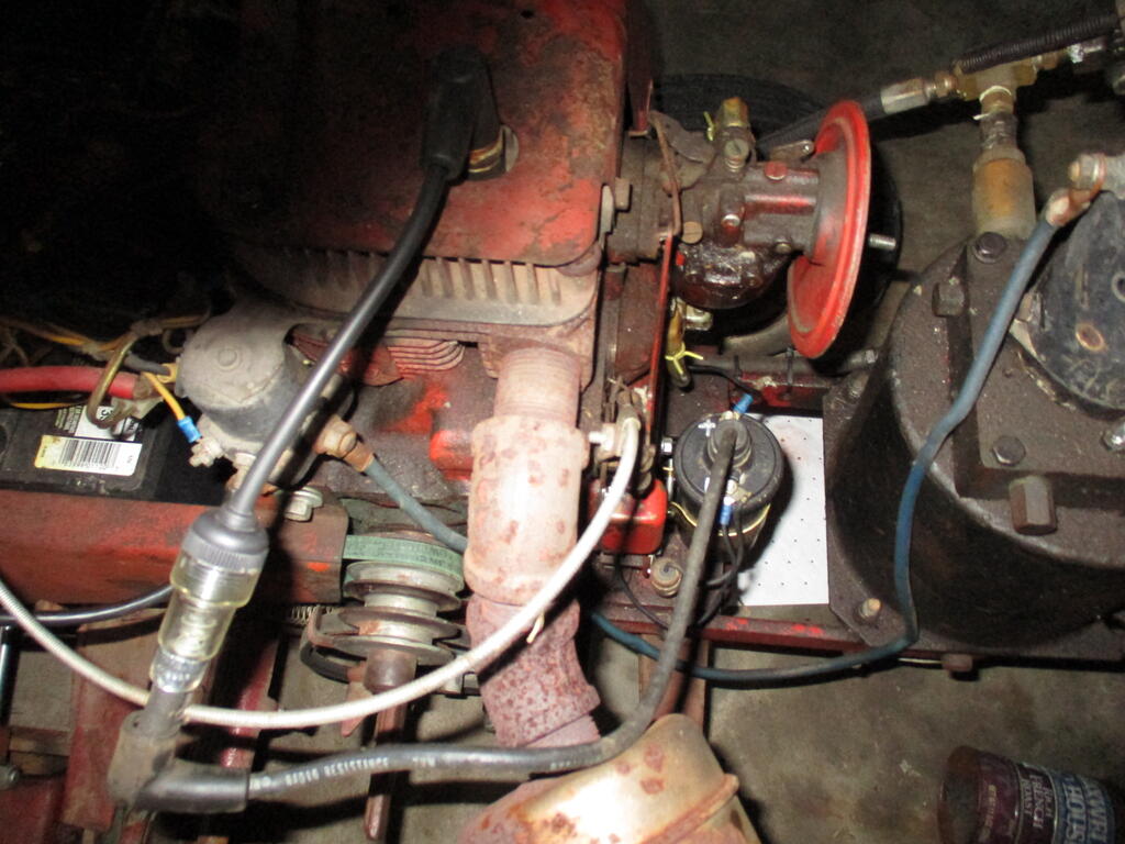

pfrederi 21,305 #2 Posted July 17, 2023 Lets start with deciding Big Block or small. Is the exhaust port at an angle pic 1 or come strait out like pic 2 Share this post Link to post Share on other sites
Graham529 16 #3 Posted July 17, 2023 The exhaust port is at an angle 👍🏻 Share this post Link to post Share on other sites
pfrederi 21,305 #4 Posted July 17, 2023 Okay then it is a 10 12 14 or 16 horse engine If there are 10 head bolts it is a K341 16 hp 9 bolts 10, 12,14 Share this post Link to post Share on other sites
