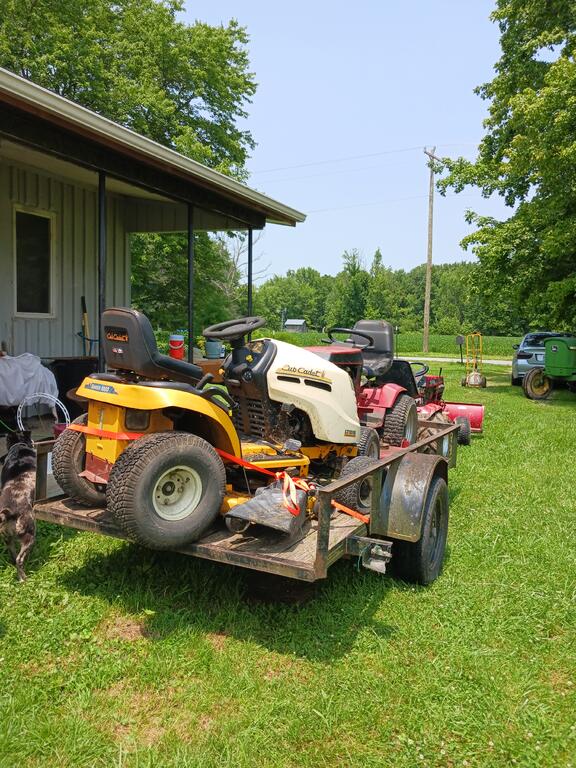

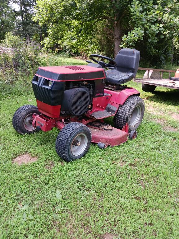

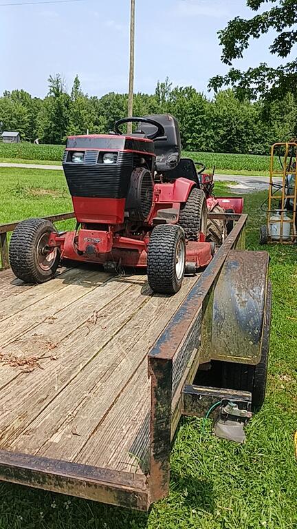

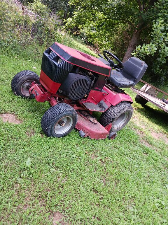

TJ5208 1,841 #1 Posted July 17, 2023 (edited) Well guys been a minute but I added a new Horse to the crew. A 520H needs some tlc. It doesn't run at the moment but ran 4 months ago. I plan on using it through the summer to mow lawns then restoring it this winter. It has 557 hours on it. Will get more pics when it's home. Edited July 17, 2023 by TJ5208 6 2 Share this post Link to post Share on other sites

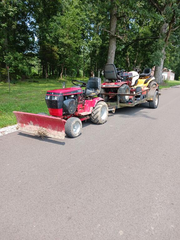

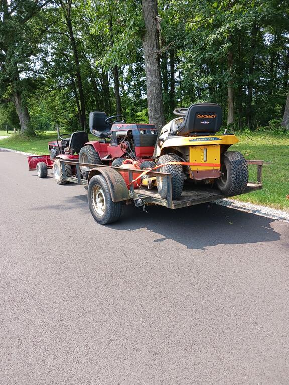

TJ5208 1,841 #2 Posted July 17, 2023 More pics. Don't mind the cub I'm selling it. 1 4 Share this post Link to post Share on other sites

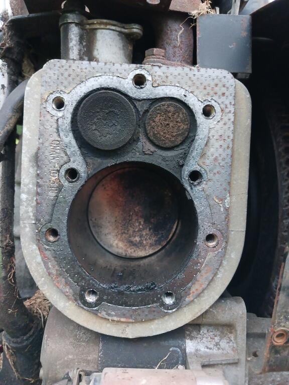

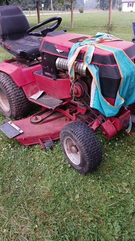

TJ5208 1,841 #5 Posted July 18, 2023 Well the bad news is it has no compression in the front cylinder. 2 Share this post Link to post Share on other sites
TJ5208 1,841 #6 Posted July 18, 2023 Blown rod in front cylinder. 4 Share this post Link to post Share on other sites

WHX?? 58,388 #9 Posted July 18, 2023 Given a tight budget a predator or other repo might be the best option. Would have to mow lawns for ten summers for a Onan rebuild. Keep yer eyes open tho might stumble on a 18 or 16 Onan that will be plug n play. Never know. Good luck & keep us posted. 1 Share this post Link to post Share on other sites

Sparky-(Admin) 26,898 #11 Posted July 18, 2023 Perfect candidate for a 14-16hp Magnum motor swap. Ditch that Onan! 2 Share this post Link to post Share on other sites
kpinnc 19,107 #12 Posted July 18, 2023 (edited) 4 hours ago, Sparky said: Perfect candidate for a 14-16hp Magnum motor swap. Ditch that Onan! Have to agree. Onans sound cool. That's about it. They are great when good, and a pain when not. You typically find them either with crazy high hours (I have one with over 3000) or blown up around 500. Parts are another issue. I have two P220 engines that are disassembled, with enough parts to rebuild them. The problem? Rings and gaskets cost several hundred dollars- if you can even find them. These engines are not like old Briggs or Kohlers. They are not forgiving. You can't just hone a cylinder and keep going. If you do, you will be opening it up again very soon. The tolerances on the moving parts in these engines are very tight. I'm not an Onan hater. I use my 520-H every week, and very much enjoy it. I service the engine regularly, and pay close attention to the cooling issues. But I know when it gives out, I'll be repowering with something else. Edited July 18, 2023 by kpinnc 2 Share this post Link to post Share on other sites
