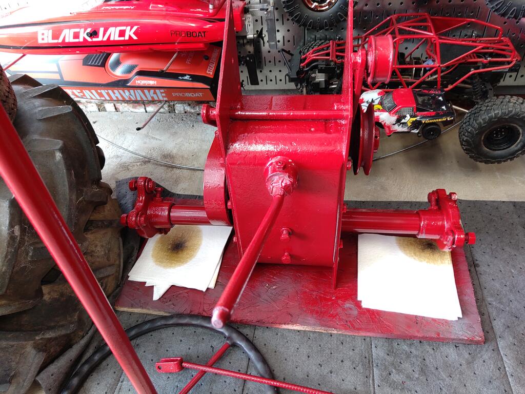

ML3 2,153 #1 Posted July 15, 2023 Working on RJ. Got things apart to repaint etc. Changed transmission fluid the other day. It wasn't terrible but needed changed. Painted transmission yesterday. Now the axle seals are leaking! Ugh! There was fluid in trans prior & there wasn't any leaks. Both sides leaking pretty good. Now I gotta figure out what seals etc are needed, where to get them & what's involved with changing them. It looks like there's 2 different seals for the RJ??? Share this post Link to post Share on other sites
squonk 45,590 #2 Posted July 15, 2023 (edited) The bronze bushings on the ends of the tubes are probably worn. Tipping it and monkeying around probably didn't help. The axles wear also where they go thru the bushings. New seals may or may not stop it. How much oil did you put in? Maybe you got too much in there. It doesn't take much. Edited July 15, 2023 by squonk 1 Share this post Link to post Share on other sites
gwest_ca-(File Mod) 12,013 #3 Posted July 15, 2023 Looks like you do not have any seals. The metal OD of the seal is installed over the axle tube so should be visible. Seal 1257 replaced by 742000 has always been available from Toro and only Toro but not any more. I do not know if any of our vendors have them. 1 Share this post Link to post Share on other sites
squonk 45,590 #4 Posted July 15, 2023 Lowell has the seals along with gaskets and bushings in kit form. https://wheelhorsepartsandmore.com/product-category/manual-transmissions/ 2 Share this post Link to post Share on other sites
ML3 2,153 #5 Posted July 15, 2023 33 minutes ago, gwest_ca said: Looks like you do not have any seals. The metal OD of the seal is installed over the axle tube so should be visible. Seal 1257 replaced by 742000 has always been available from Toro and only Toro but not any more. I do not know if any of our vendors have them. I'll have to take it apart to verify seals are not there? Like I said there was fluid in transmission & it wasn't leaking before, which I was surprised. Whoever started working on it definitely did everything half ass I'm finding out. Share this post Link to post Share on other sites
ML3 2,153 #6 Posted July 15, 2023 1 hour ago, squonk said: The bronze bushings on the ends of the tubes are probably worn. Tipping it and monkeying around probably didn't help. The axles wear also where they go thru the bushings. New seals may or may not stop it. How much oil did you put in? Maybe you got too much in there. It doesn't take much. 1 hour ago, squonk said: The bronze bushings on the ends of the tubes are probably worn. Tipping it and monkeying around probably didn't help. The axles wear also where they go thru the bushings. New seals may or may not stop it. How much oil did you put in? Maybe you got too much in there. It doesn't take much. I'll have to look up again how much gear oil capacity calls for. Anyone know it so I can verify I have correct information? I remember being surprised that it didn't take more oil that required Share this post Link to post Share on other sites

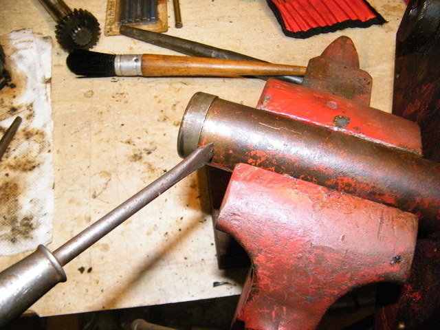

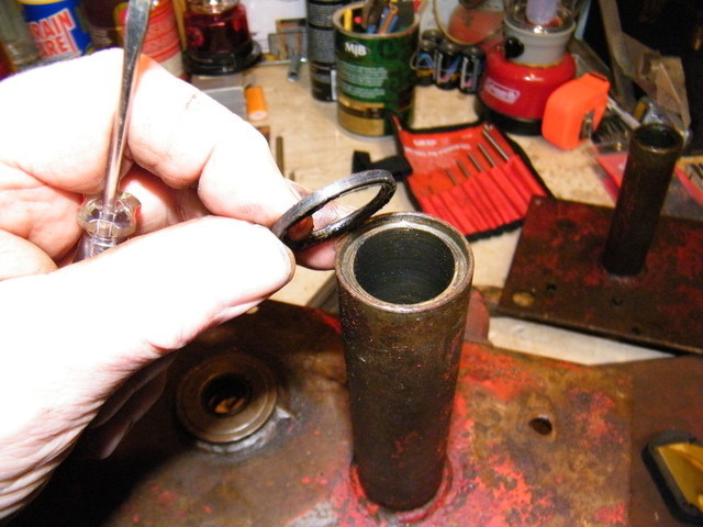

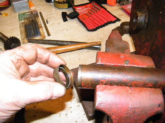

stevasaurus 23,619 #9 Posted July 15, 2023 (edited) Here is a picture of what the seal looks like and how I get them off. Here is a picture of the way WH tried to do it at first. You may not even have those grooves for the axle seals like that in your casting. Edited July 15, 2023 by stevasaurus Share this post Link to post Share on other sites

ML3 2,153 #11 Posted July 16, 2023 Stupid me..... Appears like transmission was overfilled. I think I musta initially added fluid & forgot I did then added again! I realized it after seeing how much gear lube I had used. 🤞 1 Share this post Link to post Share on other sites
