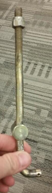

Skwerl58 831 #5 Posted July 14, 2023 Your issues are common to these tractors. Like stated earlier lube it but first clean the brake linkage at its pivots with a good quality penetrating lube and then use a god quality spray lube on it after it runs clear from the penetrating oil. I have started lubing mine at least every month or so during mowing season. About the deck there should be a linkage rod on the back of the deck that you adjust as well as the wheels and the lift linkage to maximize height. I have attached this old but goos thread to address the deck height. https://www.wheelhorseforum.com/topic/39928-adjusting-a-mowing-deck/ I replaced the boot on my 1987 a couple of years ago from a vendor here and no problems so far. 2 Share this post Link to post Share on other sites

kpinnc 18,740 #11 Posted July 14, 2023 (edited) 6 hours ago, squonk said: The rubber deck wheels on the height adjuster bar. They are pretty soft rubber If those are 6 inches, they should provide a cut height of 2.5- 3 inches. The front and rear scalp wheels should not touch the ground unless crossing unlevel terrain. The aduster link on the rear of the deck is for leveling. The link connects the rack on top to the lift bar at the rear of the deck. It has a 3/8 nylock nut that adjusts the throw of the link. Typically connects to a tab between the two rear scalp wheels. If set correctly (implement lift arm full down), the front of the deck will be slightly (less than 1/2 inch) lower than the rear. This provides relief to the blade "disc" so only the front edge of the blades do the cutting. Even if the lift chain breaks, the rack on top of the deck and belly hitch will support the deck, IF the adjuster link is set correctly. Edited July 14, 2023 by kpinnc Share this post Link to post Share on other sites
