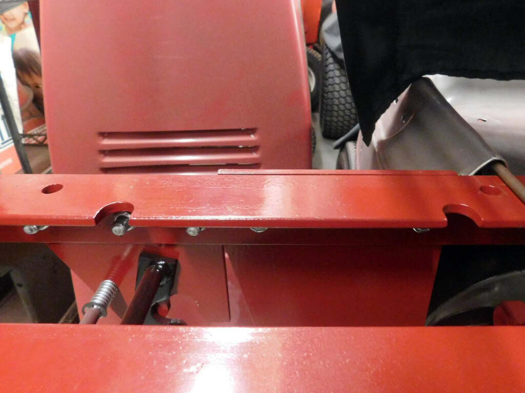

Sodaking27 1,391 #3 Posted July 13, 2023 1 hour ago, Moparfanforever said: Sounds real good !! I am wanting to do this swap also, curious about notching the frame. I thought the adapter would have fixed that ?? The factory started notching the frame in 86 I believe to accommodate the twin cylinder Kohler’s. Here is a photo showing the notching. 1 Share this post Link to post Share on other sites
Moparfanforever 940 #4 Posted July 13, 2023 Thanks for the pic, I will have to look at the frames I have. 1 Share this post Link to post Share on other sites
