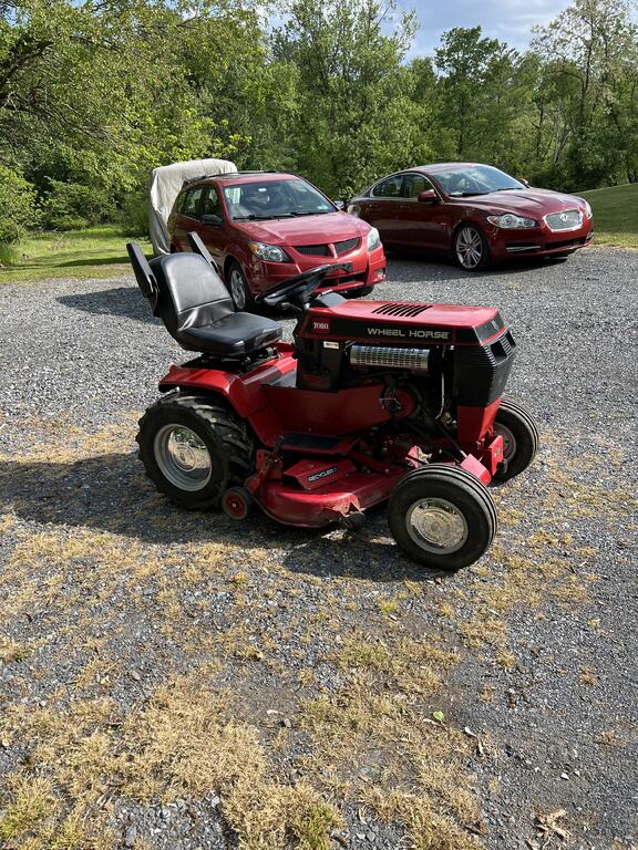

gretle_2.0 41 #1 Posted July 13, 2023 (edited) Hey guys, I bought this mower early May to replace my John Deere L120 and have been blown away with it. Bought it for $1k with 1100 hrs on the clock. Changed all fluids, cleaned out carb, got new tires and adding washer fluid for weight. This tractor mows my hills much better than my last. Only has the 42” rear discharge deck but might switch to a 60” eventually. Just thought I would share some pics! Edited July 13, 2023 by gretle_2.0 8 Share this post Link to post Share on other sites
ebinmaine 79,640 #2 Posted July 13, 2023 Looks like that's been very well cared for. Excellent purchase. The more you use that... the more you will be impressed. Share this post Link to post Share on other sites
Brockport Bill 2,425 #3 Posted July 13, 2023 congrats --- RE: having a rear discharge mower with a hydro --- Suggest you be sure to clean with leaf blower the underneath rear of tractor after each lawn mow -- notably the hydro fins -- if grass sticks and build up then the hydro fins won't cool as well and hydro can get hot --- this is especially likely if mowing damp grass, or mowing in spring with lots of moisture in grass blades 4 Share this post Link to post Share on other sites
peter lena 9,939 #4 Posted July 13, 2023 @gretle_2.0 nice lookin unit , think I would stay with the 42 deck , from what you hear about , the related negitive 60 " for added drag and related issues . weight , maintiance , also agree with @Brockport Bill with damp grass and added hydro drag , always cut at highest setting for less build up and better venting . you can add a rear light rubber flap , on that deck to assist in stoping hydro fin build up , pete 3 Share this post Link to post Share on other sites

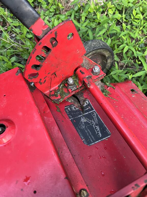

gretle_2.0 41 #8 Posted July 14, 2023 Yeah I’m picking up a 48” tomorrow because today I busted my deck right at where the rear wheel bar goes…. Usually mow at highest setting once I was near done I realize my lawn was scalped and said wtf. Then look down at the deck and cried, thought I hit a Little Rock but I guess ended up being pretty big lol 1 Share this post Link to post Share on other sites
peter lena 9,939 #9 Posted July 14, 2023 @gretle_2.0 while finished grass area looks pretty good , that crack , break in that deck suggests , long standing moisture / rust set up , regularly use a mirror to look over the underside of the unit , ues a 6 / 8 " or larger mirror and a light to show you whats going on . personally , drop a deck and remove for inspection , and a sun drying pry up / clean and oil lubricate to stop the grunge cycle . prop up a deck with a solid angular support so the deck is drying , getting hot , clean out , fine file your blades , look around for any issues , my lubrication soak / heat draw in , gives the under side a black oil slick finish , no rust / rot or issues , hope you find your good spot for deck , relibility , also a related spindle / pulley lubrication , hi temp grease . just a suggestion . pete 2 Share this post Link to post Share on other sites
gretle_2.0 41 #11 Posted July 14, 2023 57 minutes ago, peter lena said: @gretle_2.0 while finished grass area looks pretty good , that crack , break in that deck suggests , long standing moisture / rust set up , regularly use a mirror to look over the underside of the unit , ues a 6 / 8 " or larger mirror and a light to show you whats going on . personally , drop a deck and remove for inspection , and a sun drying pry up / clean and oil lubricate to stop the grunge cycle . prop up a deck with a solid angular support so the deck is drying , getting hot , clean out , fine file your blades , look around for any issues , my lubrication soak / heat draw in , gives the under side a black oil slick finish , no rust / rot or issues , hope you find your good spot for deck , relibility , also a related spindle / pulley lubrication , hi temp grease . just a suggestion . pete Awesome thanks for the tips Pete! 1 Share this post Link to post Share on other sites
