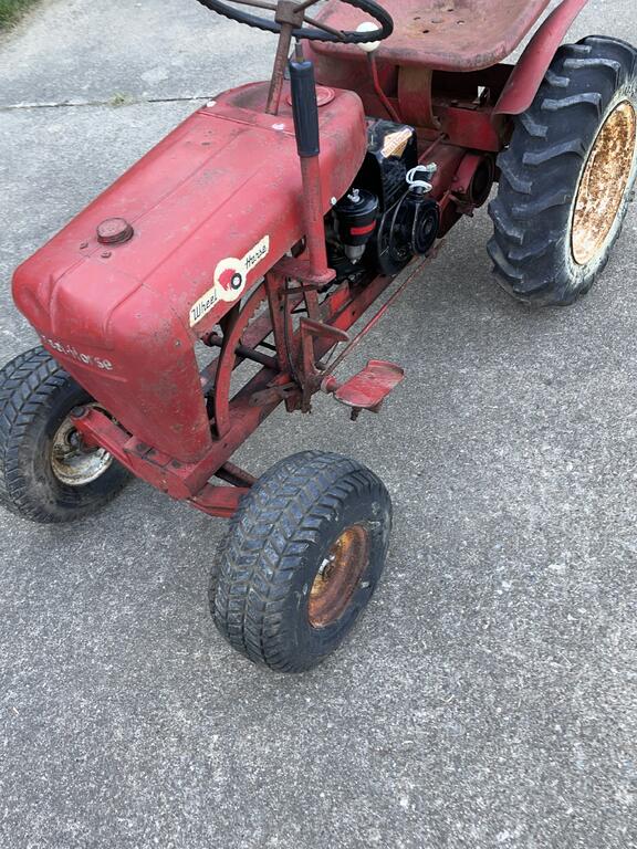

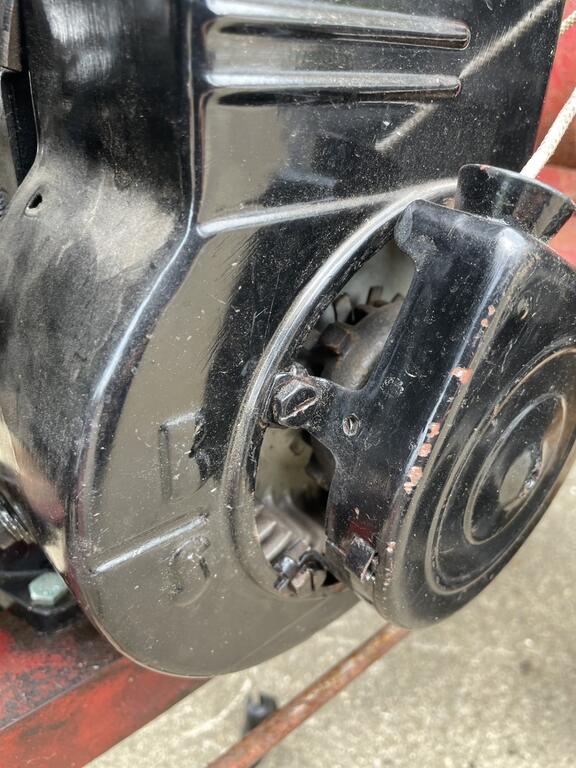

kitkit 142 #1 Posted July 13, 2023 (edited) Looking for a recoil like this or info on what would replace it . Seems to be attached by bolts and oblong nuts clamping the flywheel cover . Edited July 13, 2023 by kitkit spell 1 Share this post Link to post Share on other sites
Achto 32,444 #2 Posted July 13, 2023 1 hour ago, kitkit said: Looking for a recoil like this or info on what would replace it . In the picture it looks like your spring gave up on you. This is a common issue that can some times be fixed with out new parts. It is quite common for the very end of the spring to break off at either end. Before you look for a new recoil, take this one apart & post a pic of which end of the spring broke. I may be able to coach you through a repair. Share this post Link to post Share on other sites
tractornut86 622 #3 Posted July 14, 2023 I believe I still have some nos ones but if not I should have couple used of that style Share this post Link to post Share on other sites
kitkit 142 #4 Posted July 14, 2023 On 7/12/2023 at 10:26 PM, Achto said: In the picture it looks like your spring gave up on you. This is a common issue that can some times be fixed with out new parts. It is quite common for the very end of the spring to break off at either end. Before you look for a new recoil, take this one apart & post a pic of which end of the spring broke. I may be able to coach you through a repair. I took it apart it was my fault te rope knot slipped out. Thank you 1 Share this post Link to post Share on other sites
Achto 32,444 #5 Posted July 14, 2023 2 hours ago, kitkit said: te rope knot slipped out Were you able to get it back together & working? Share this post Link to post Share on other sites
kitkit 142 #6 Posted July 14, 2023 Just now, Achto said: Were you able to get it back together & working? Yes thank you , I put in a bigger rope and knot but have not. trimmed it yet , the recoil is working but it did not start yet 1 Share this post Link to post Share on other sites
