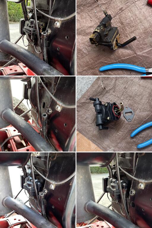

Al C. 1,474 #14 Posted July 18, 2023 UPDATE: I took a stab in the dark. Did the simplest thing first. Replaced the original fuel pump with a compatible device off of Amazon. It worked! Fixed! 5 Share this post Link to post Share on other sites
