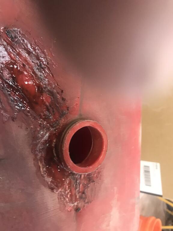

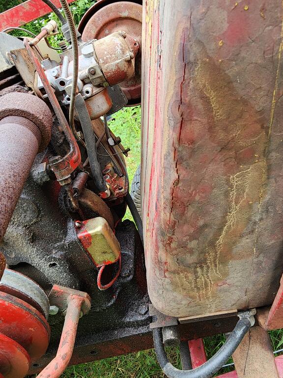

cafoose 3,466 #1 Posted July 9, 2023 Does anyone know how I can fix this? It's not leaking at the moment but it may start leaking soon. @19richie66 got any of those awesome metal GT-14 tanks for sale? If not, how much do you want to make me one? 1 Share this post Link to post Share on other sites

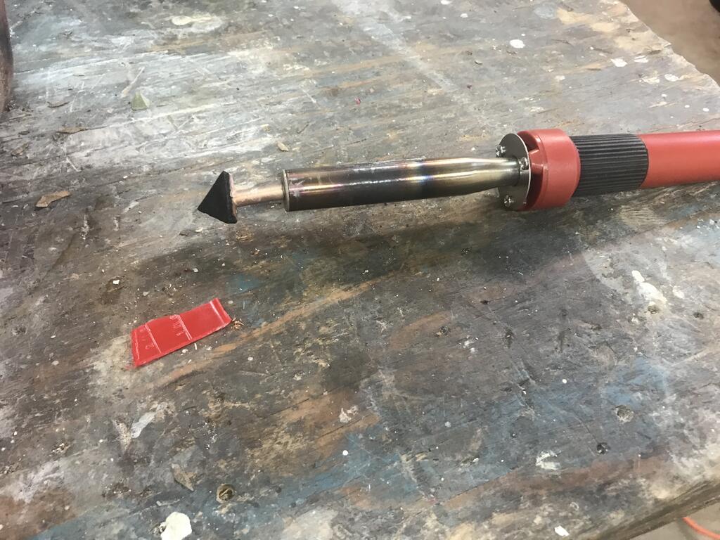

19richie66 17,704 #2 Posted July 9, 2023 (edited) 20 minutes ago, cafoose said: Does anyone know how I can fix this? It's not leaking at the moment but it may start leaking soon. @19richie66 got any of those awesome metal GT-14 tanks for sale? If not, how much do you want to make me one? Sure wish I could. 😞. You would be surprised though at how thick that tank is. You could fill in the cracks with plastic weld and sand it back down. A soldering iron with a flat tip and some good zip ties would do it. Edited July 9, 2023 by 19richie66 2 1 Share this post Link to post Share on other sites

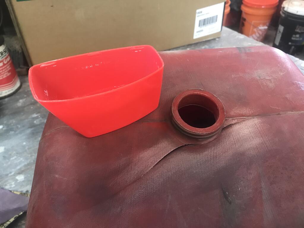

oliver2-44 10,827 #3 Posted July 9, 2023 I recently bought a $20 plastic welded from harbor fright. One of the keys if figuring out what type of plastic it is. I practiced on various pieces of scrap plastic. Cleaned plastic oil bottles of the "right color plastic" worked well. I repaired a plastic tank for a Charger. I found the "red plastic" measuring cup that came with some laundry product worked. It said HDPE on it . it's not the best, but it doesnt leak. The plastic roods that came with the welded also worked on the tank, just not the right color. And a Hood for a JD mower. 1 1 Share this post Link to post Share on other sites

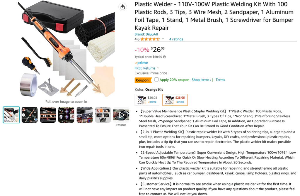

cafoose 3,466 #6 Posted July 9, 2023 2 hours ago, oliver2-44 said: I recently bought a $20 plastic welded from harbor fright. I may just do that Got this coming Wednesday https://www.amazon.com/gp/product/B0BTD4BG1K/ref=ppx_yo_dt_b_asin_title_o00_s00?ie=UTF8&th=1 Share this post Link to post Share on other sites
Jon Paulsen 291 #7 Posted July 9, 2023 Looks like a better kit. The stainless steel mesh helps a lot for strength. 1 Share this post Link to post Share on other sites
cafoose 3,466 #8 Posted July 10, 2023 1 hour ago, Jon Paulsen said: Looks like a better kit. The stainless steel mesh helps a lot for strength. And I don't have to go anywhere to get it 2 1 Share this post Link to post Share on other sites
