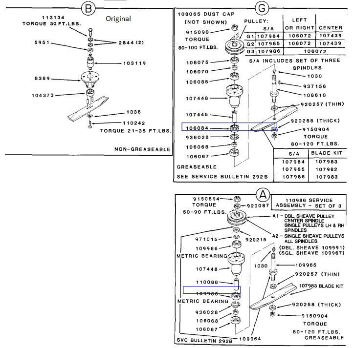

bert02 0 #1 Posted July 7, 2023 Hi, I have a 36" RD mower tag: 5 0601 6. Spindle has a needle bearing in the bottom Housing is greasable. Ball bearing on top. Shaft is 3/4" double D Needle bearing housing bore is 1". Spindle has a circlip towards the top There are no circlip groves in the housing. I have no idea if it was original to the mower deck. Can anyone identify the needle bearing part number There is nothing left of the needle bearing except the crumpled cage. Thanks Share this post Link to post Share on other sites

Lee1977 6,310 #5 Posted July 9, 2023 (edited) Wheel Horse number 100289 fits 75-42MS01 or 75- 48MS01 Double D decks. I found the drawing for that deck and the 36 5-0601 and 5-0711 uses different spindle but there isn't a break down on parts for that spindle. All I can say is it look like the 42 and 48 spindles. Does it look like this 42 and 48 spindle? Edited July 9, 2023 by Lee1977 Share this post Link to post Share on other sites
