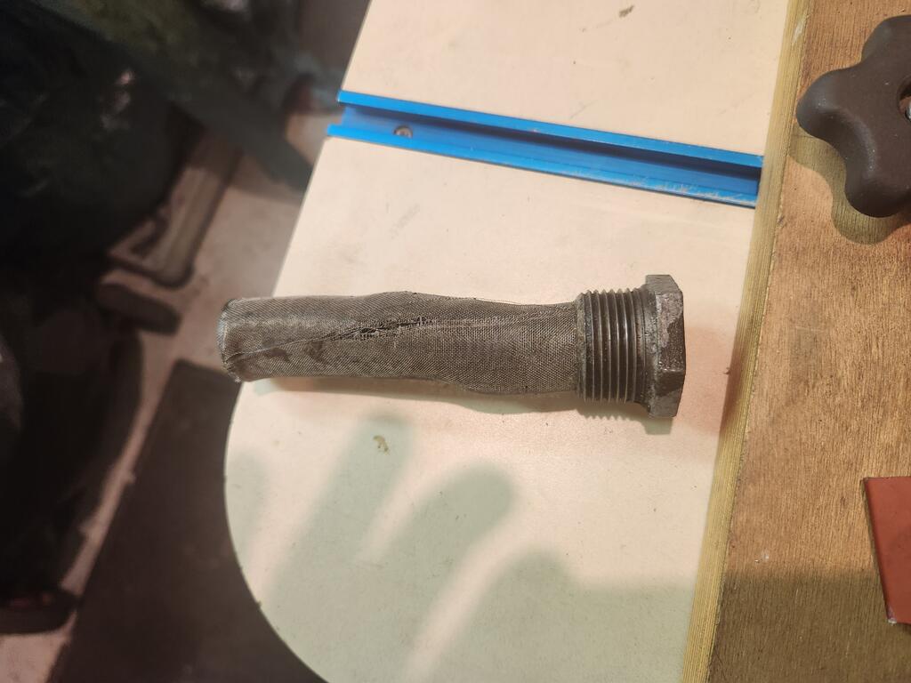

BMW1 44 #6 Posted July 7, 2023 Does anyone know where to get a replacement strainer. All the ones I found on the internet have the correct NPT thread size but the strainer is larger than the thread size. Share this post Link to post Share on other sites
