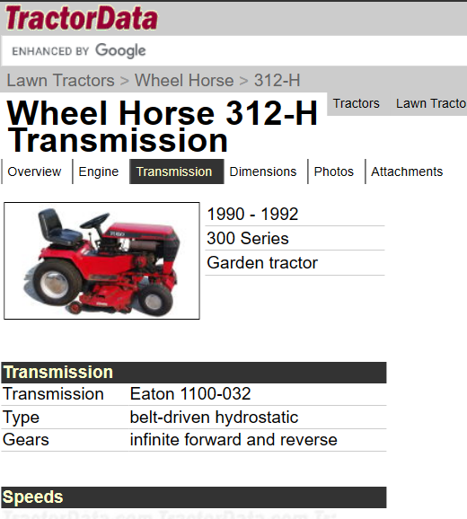

Ed Kennell 47,595 #8 Posted July 5, 2023 3 hours ago, davem1111 said: 300's had hydraulic lift, My 312 has an Eaton 1100 and a hydraulic lift. Share this post Link to post Share on other sites
davem1111 2,395 #9 Posted July 5, 2023 1 hour ago, Ed Kennell said: My 312 has an Eaton 1100 and a hydraulic lift. Wow, original? What year is it? Mine is 1987. Oh, yours must be in this date range - my mistake. Share this post Link to post Share on other sites
