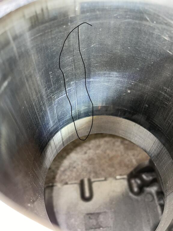

Yes I do have the manual and plan to take it. Here is the line in the cylinder I was referring to.  It is the only thing that you can feel in the cylinder wall. Everywhere else is smooth.
Thatoneguy
Likely they'll need to bore .010 or .020 to get that line out.

So here is what I found out today on the motor.  One guy told me the cylinder needed to be bored to .10 (he only took one measurement in one spot) that it had gone past spec I believe he said it was 3.48? or 3.49? (Forgot to write it down :angry-banghead:) so I decided to take it to another engine shop and get a second opinion.  The next guy took several measurements in different spots and said the bore was about .001 out of spec and said he thinks honing would be fine and I would not have any issues. However it would cost about 50-60$ (the first guy wanted 100$)  to bore it to .10.  Now on to the crank, both places measured the crank and both places said it’s out of spec pretty bad (1.3725) and I would definitely need to address the issue.  The 2nd shop (better one in my opinion) told me it is possible they sell an oversized rod for it but I am not seeing anything (maybe I am searching the wrong terms) and I looked into a new stock one and they are 305$ :blink:
I think I am going to have the cylinder bored as I would like to start the restoration off without having halfa$$ work done and for 60$ plus a new piston I think it would be worth it in the long run.
