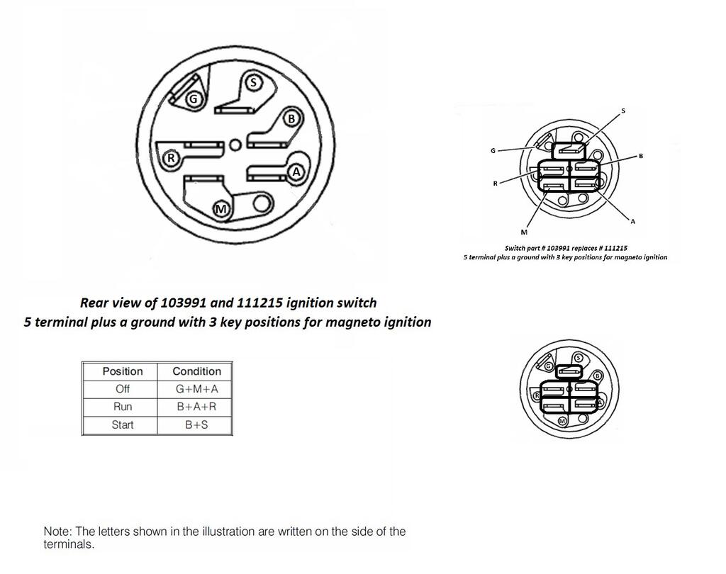

gwest_ca-(File Mod) 12,557 #12 Posted July 4, 2023 19 hours ago, moe1965 said: I bought this switch on eBay part # 103990 which also is to be the same as part # 111226. There is no marking for ignition or "l". Do I use a different post on the back of the switch or did I get the wrong one. It's going on a C 141 K series engine. Thanks in advance for any feed back This appears to be the switch you have but function needs to be confirmed to be sure. Still a very popular switch. 3 Share this post Link to post Share on other sites
