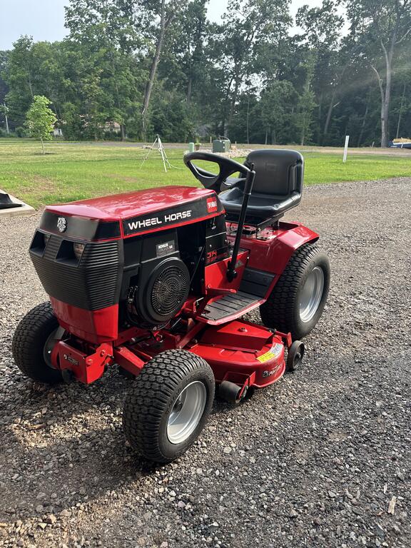

whtractors24 3,468 #1 Posted July 2, 2023 struggling finding a nice 1997 300 series seat . Open to a medium back / high back . bolt pattern center of bolt to center of bolt Measuring 5-3/4” wide 8” long Share this post Link to post Share on other sites

Sparky-(Admin) 25,393 #5 Posted July 2, 2023 Maybe it’s my old shot eyes…but that seat looks fine. What’s the story? 2 Share this post Link to post Share on other sites

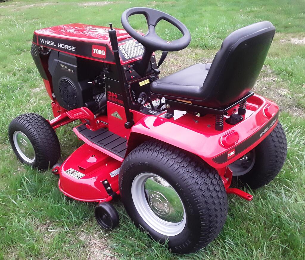

76c12091520h 4,188 #11 Posted July 6, 2023 5 3/4 " x 8 " is the correct and nearly impossible to find bolt pattern for that seat. It appeared on many of the later models with the seat safety switch that was up inside the seat cushion. Same pattern on this NOS 314. 1 Share this post Link to post Share on other sites
