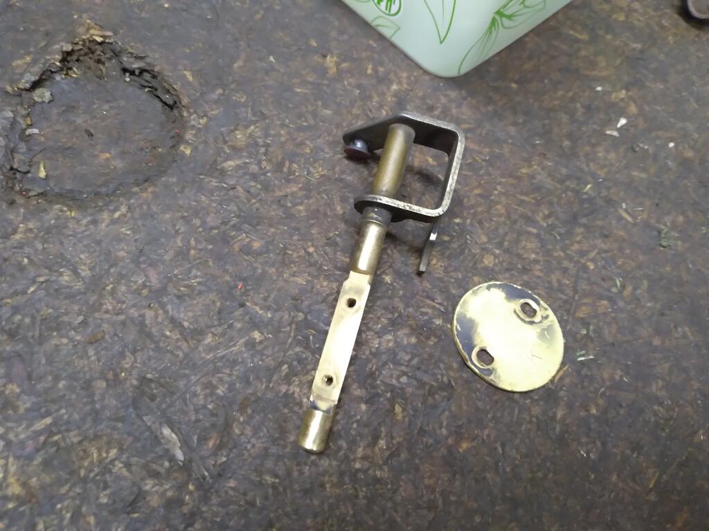

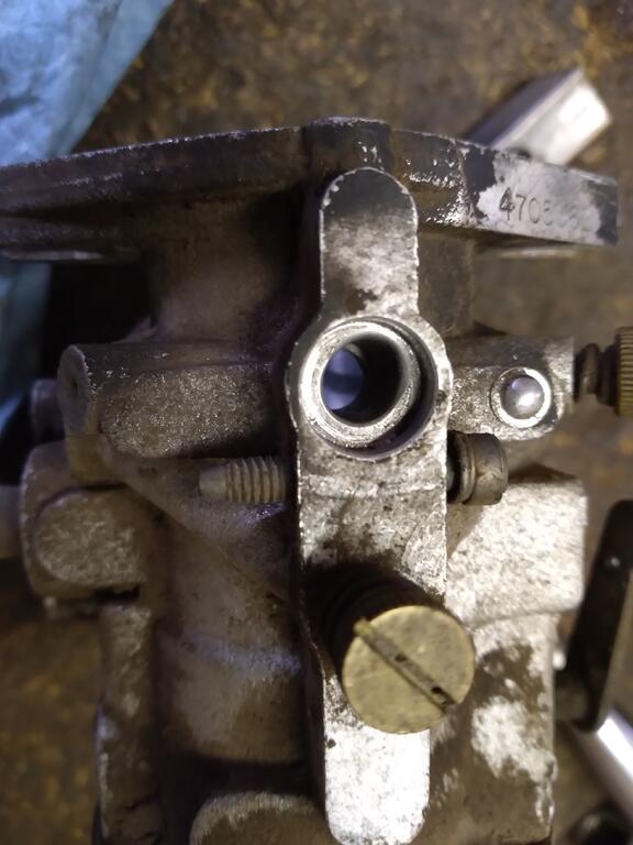

Jrblanke 976 #22 Posted July 3, 2023 I would dig into the reason they said replacement. Sometimes the throttle shaft has worn the body to the point that it will be difficult to tune due to vacuum leaks around the shaft. The shaft can be rebushed. If thats beyond your ability, you may try the isavetractors carb. Otherwise I'm on team "rebuild the old carb". James 1 1 Share this post Link to post Share on other sites
ebinmaine 80,653 #23 Posted July 3, 2023 8 minutes ago, Jrblanke said: Sometimes the throttle shaft has worn the body to the point that it will be difficult to tune due to vacuum leaks around the shaft. The shaft can be rebushed I can do the top just fine but I've seen a couple carbs where the bottom of the bore was worn. IMHO that takes a carburetor out of being a candidate for rebuild. 1 Share this post Link to post Share on other sites
D_Mac 9,339 #24 Posted July 4, 2023 I just went through the carburetor replacement nightmare. If yours can be rebuilt, rebuild it. If you need a replacement, buy one from Isavetractors. 2 Share this post Link to post Share on other sites
Wheel-N-It 2,978 #25 Posted July 4, 2023 12 hours ago, Jrblanke said: Sometimes the throttle shaft has worn the body to the point that it will be difficult to tune due to vacuum leaks around the shaft. James This is the first thing I check when looking a Wheel Horse that's for sale. A worn throttle shaft bushing can make an otherwise excellent shape Kohler run completely awful. No amount of adjusting the carburetor will compensate for the wear in and around that bushing. 3 Share this post Link to post Share on other sites
